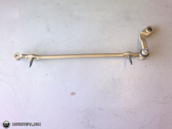

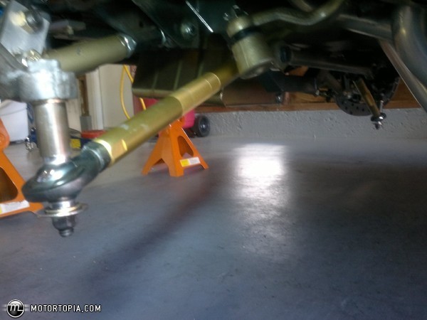

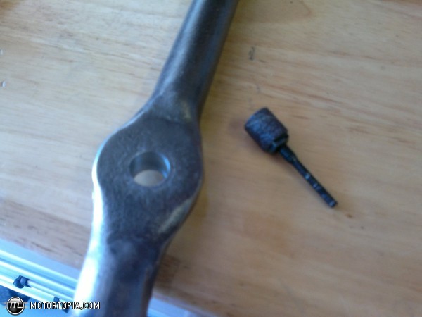

      this is what I did:
      I drilled and honed the spindles and centerlink to .495" a press fit for a 1/2" shoulder bolt and used rod ends.
