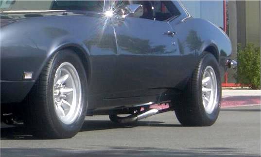

      I had spintech mufflers after the Xpipe that had to exit under sub frame connectors.
      You can see that to make them work you need to notch sub frame connector (which I hadn't done)
      or have them so low that you might catch the exhaust pipe (which you can see i did).
      I didn't notch the sub frame connector and removed spintechs and went to magnaflows and pipes to the rear of the car.
      The spintech out the side were too loud for me and I like how the magnaflows sound exiting out the rear now.
