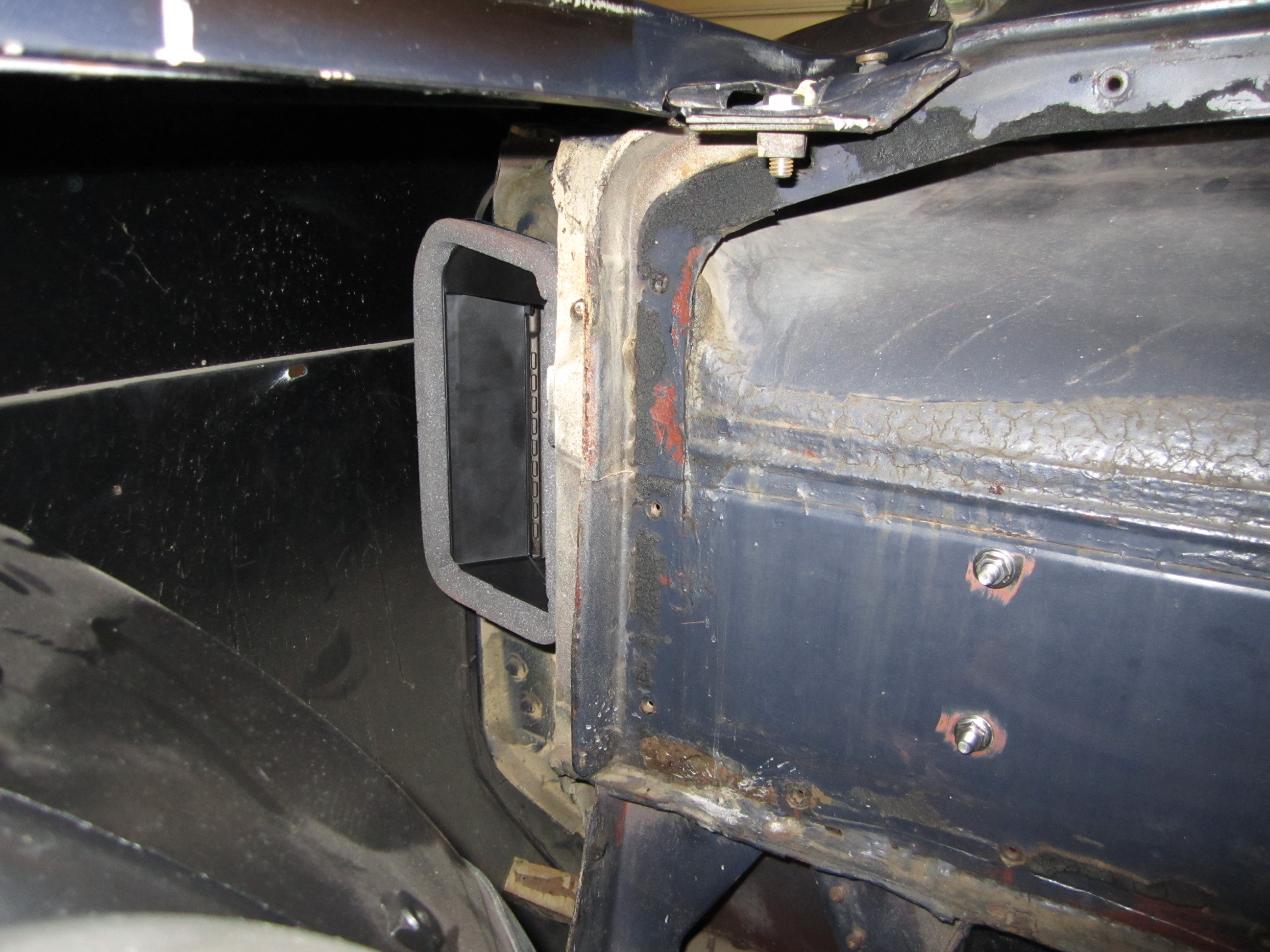

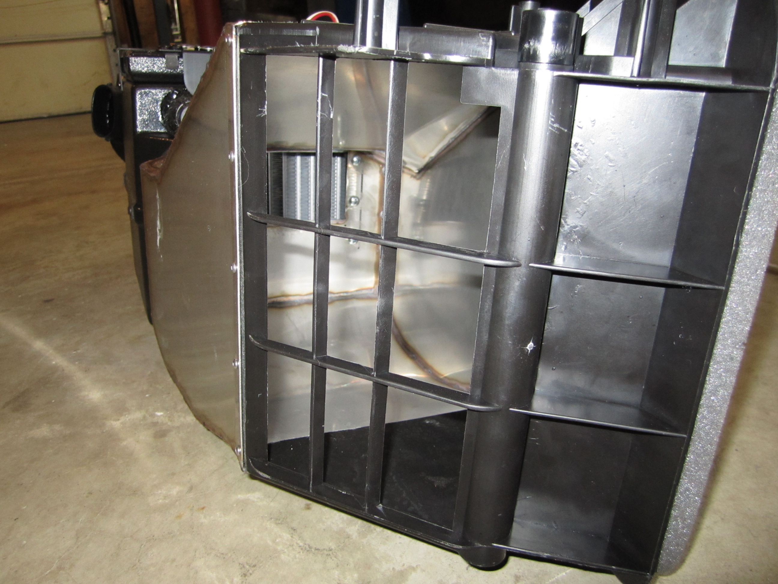

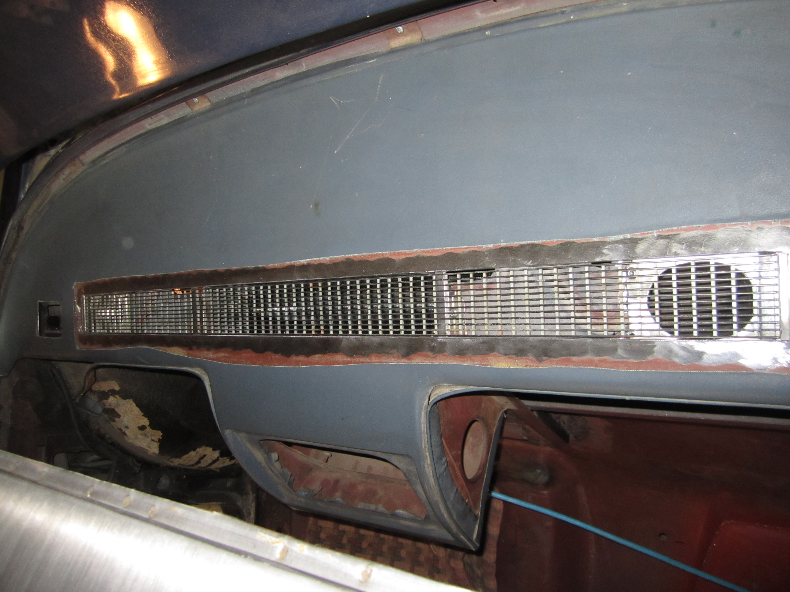

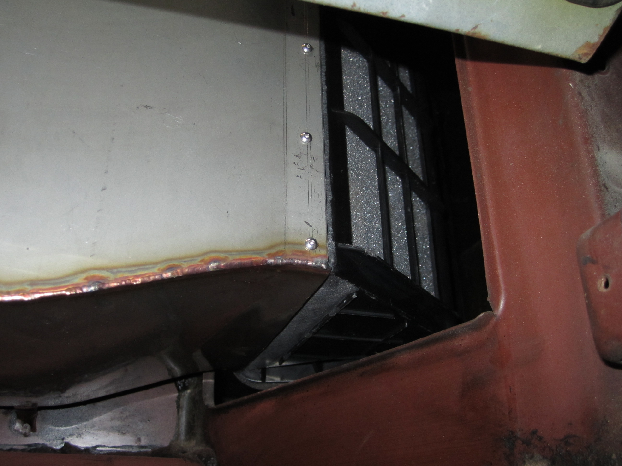

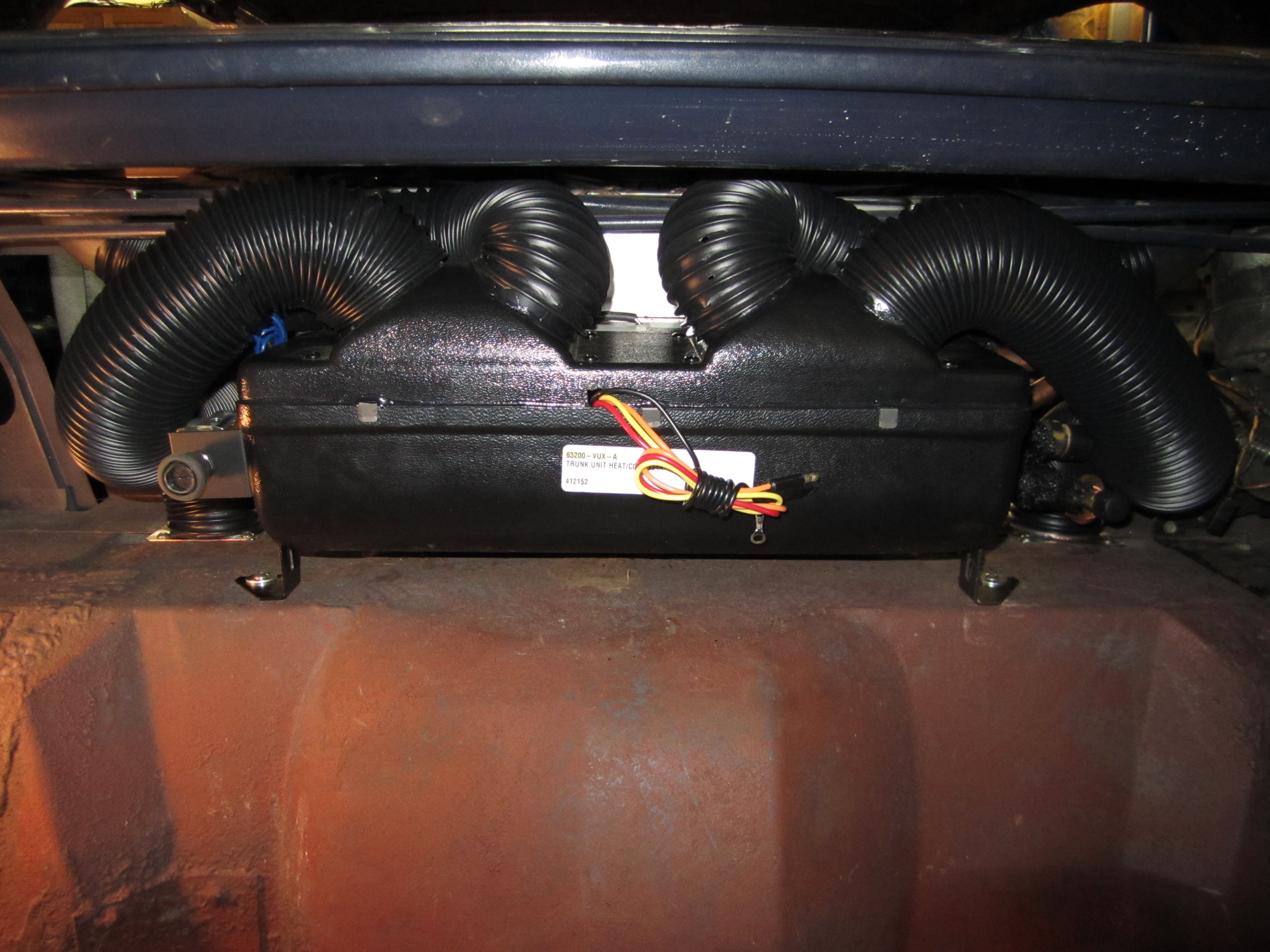

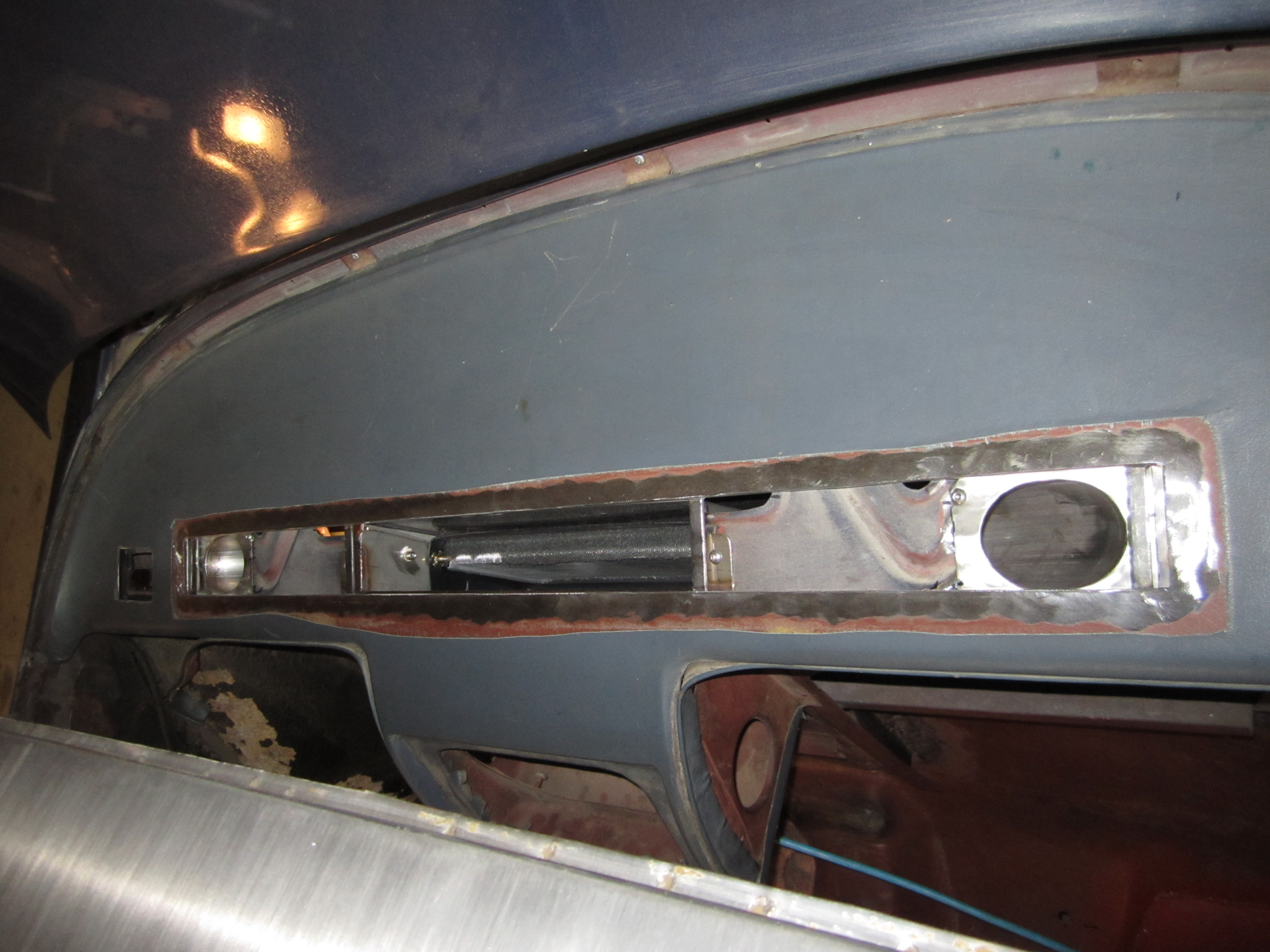

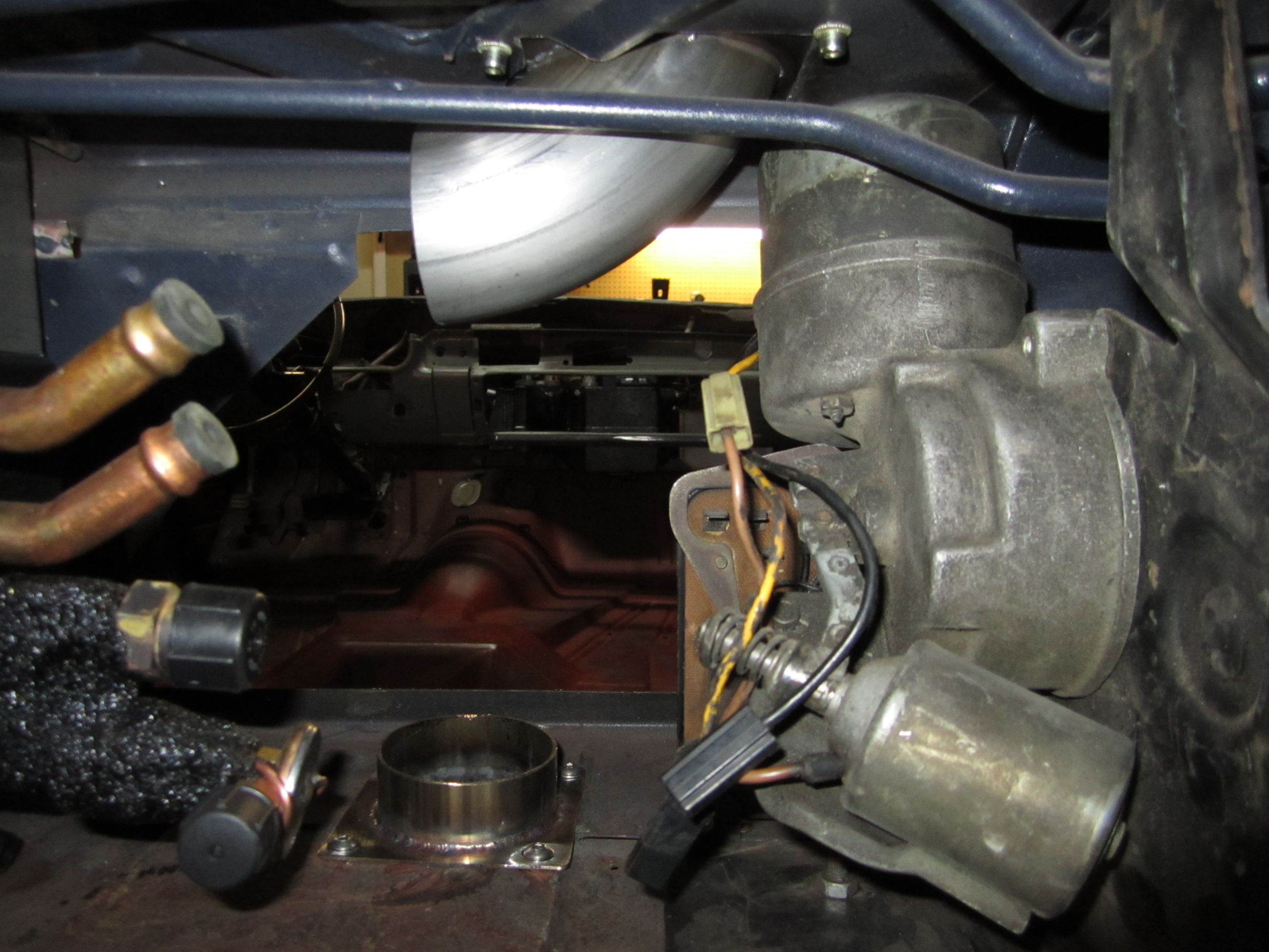

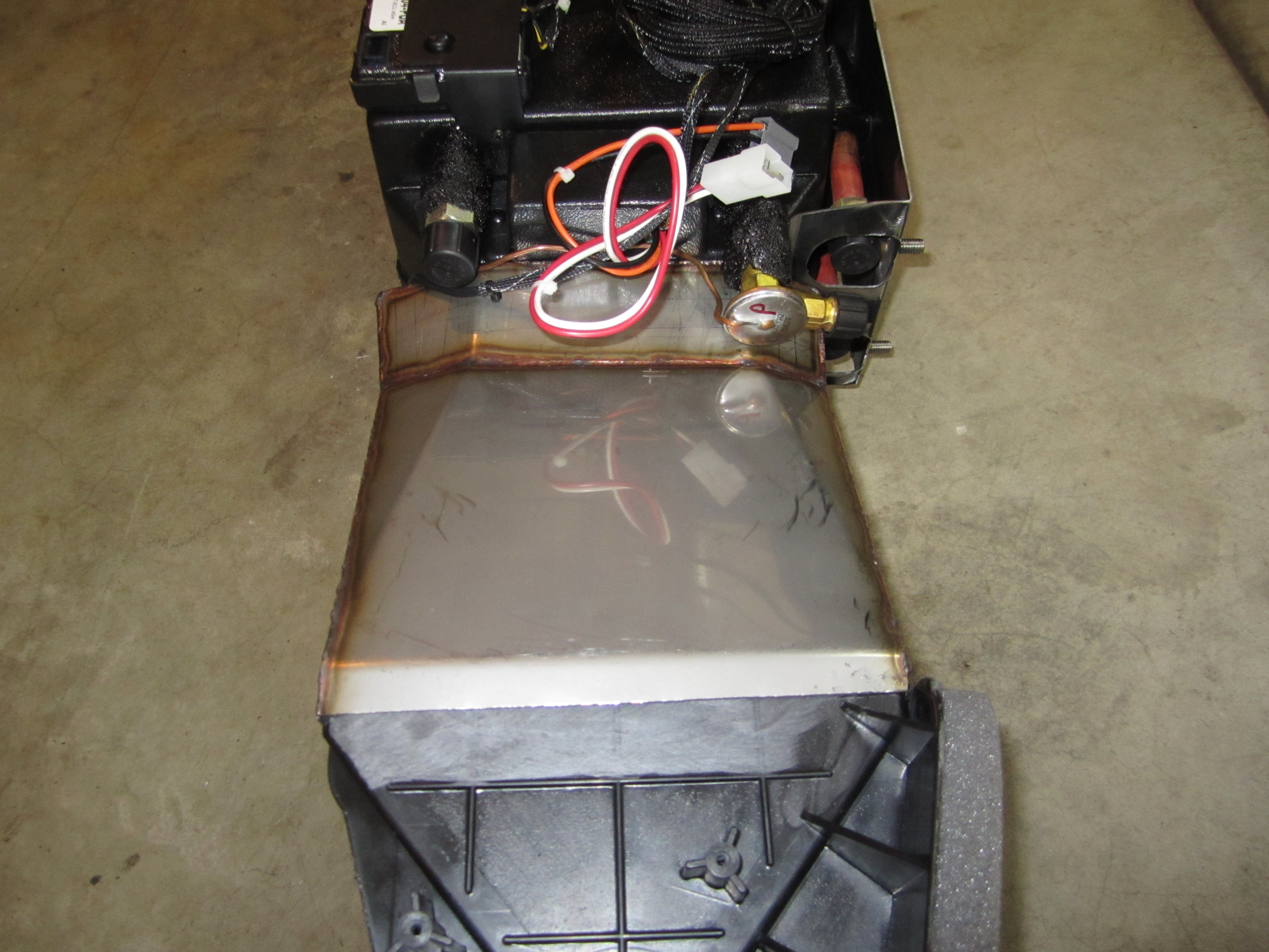

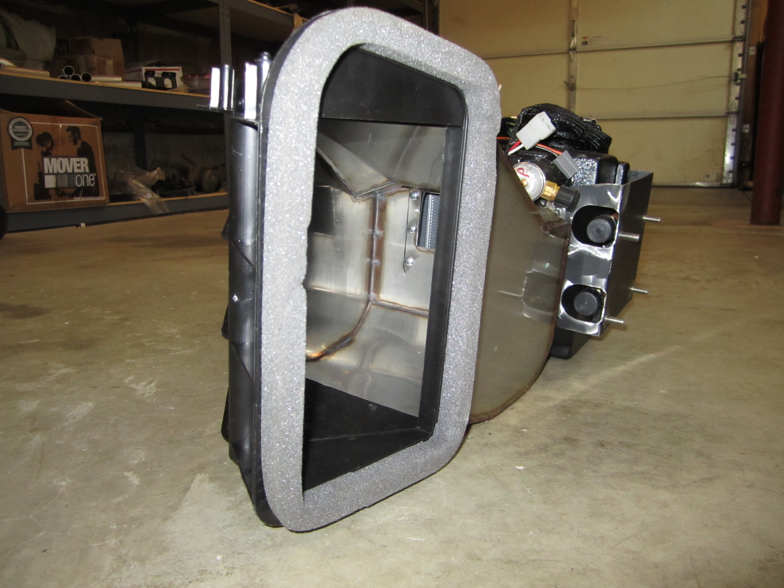

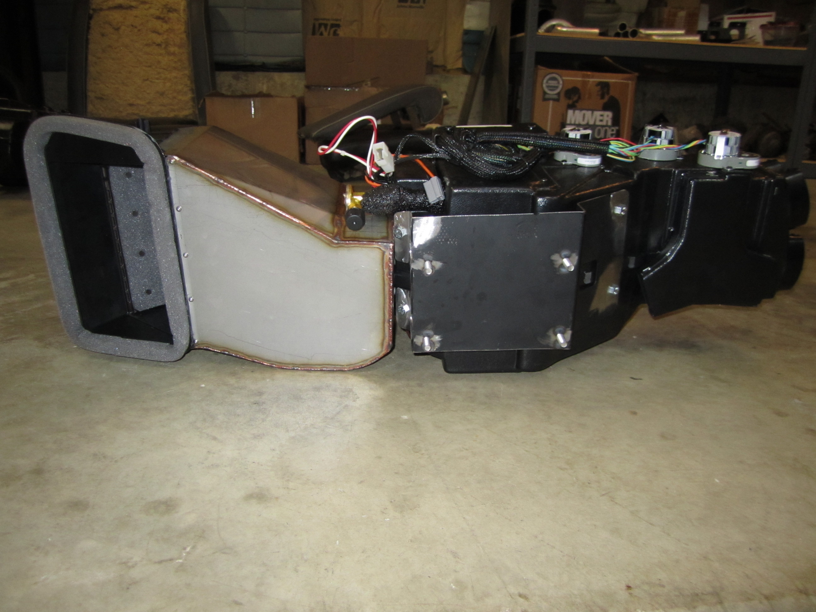

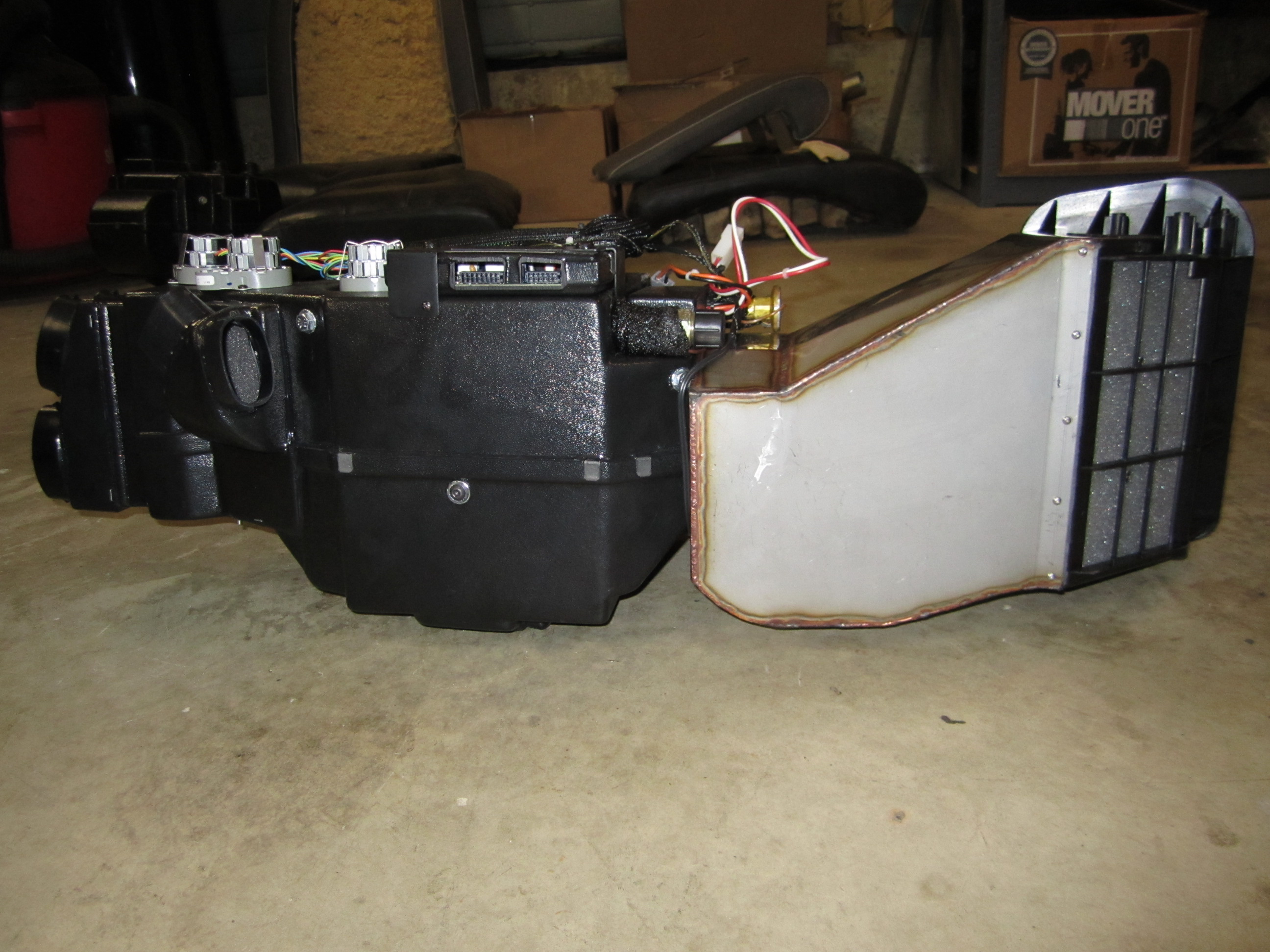

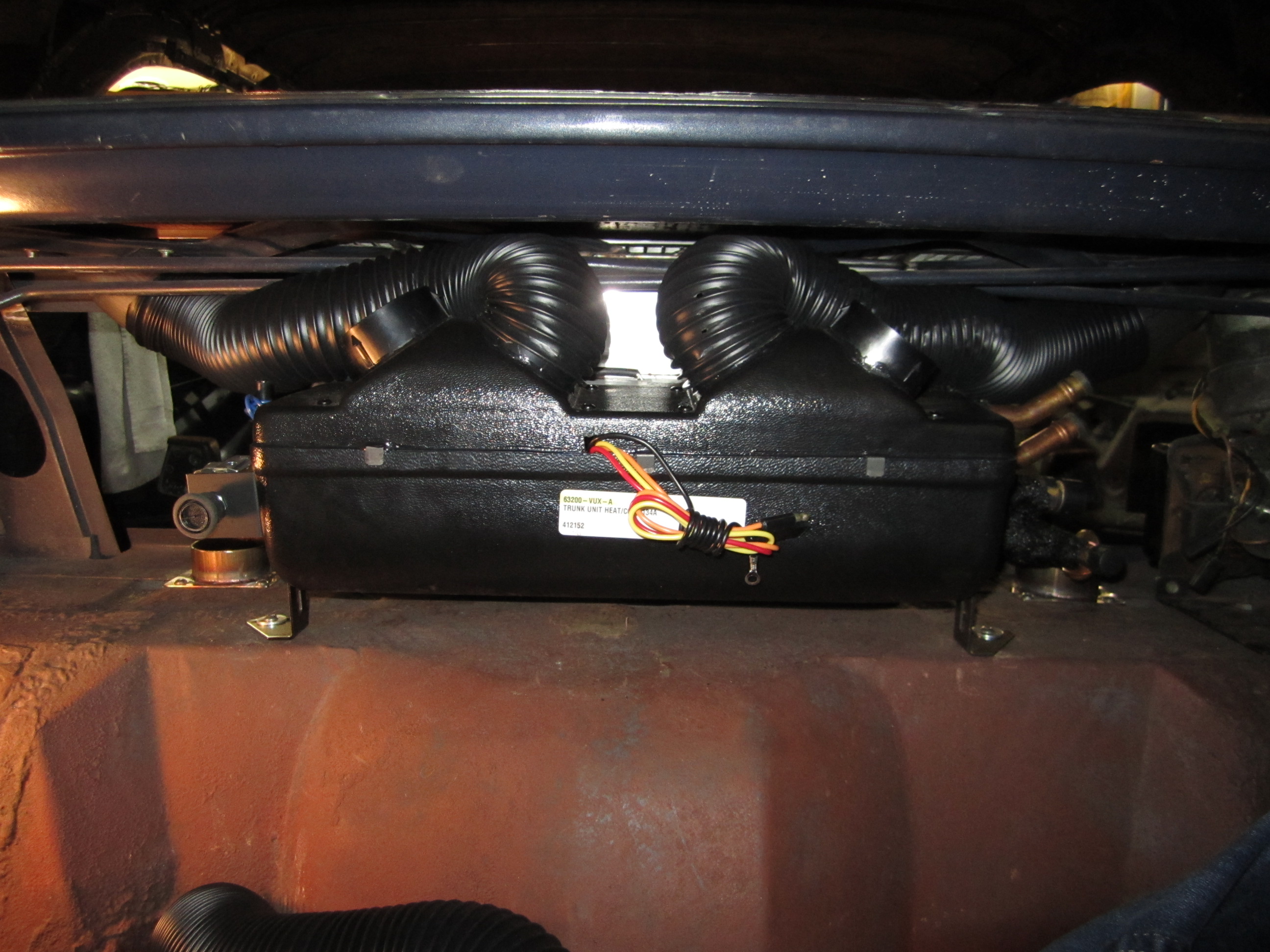

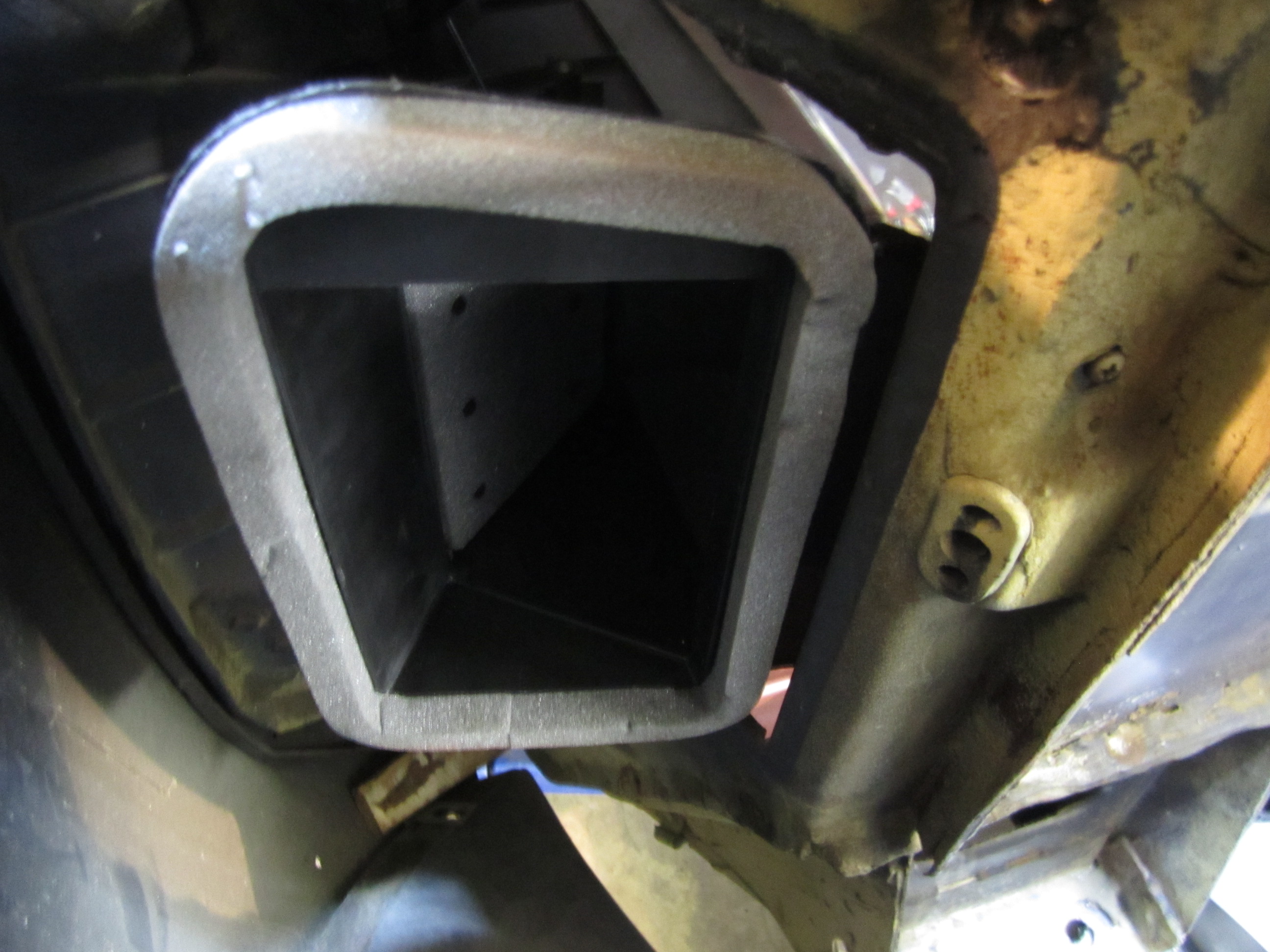

      Mine is far from being finished but I can tell you what I did.
      Vintage air gen IV up front. Built a fresh air/recirc housing for it as well.
      Used a 63200-VUX-A in the rear.
      Also a refrigerant shutoff solenoid so nothing goes to the rear evaporator unless it's on. 46200-VUH
      "Monster superflow" condenser 037030-OVR
      I don't remember the compressor part number but it was the same displacement as a SD508. SD7 is too small for dual air.

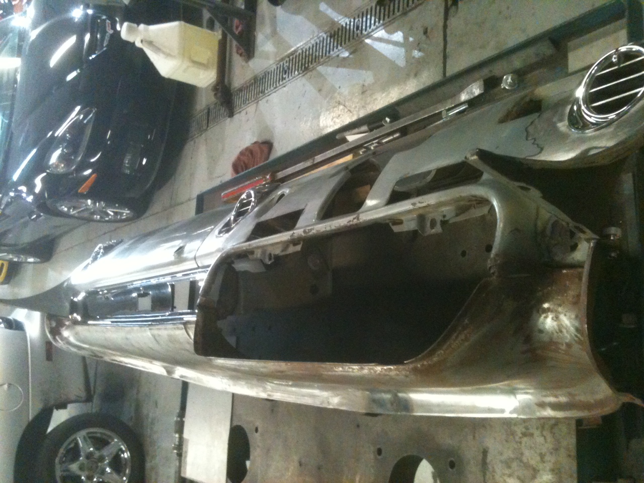

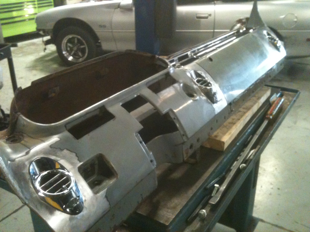

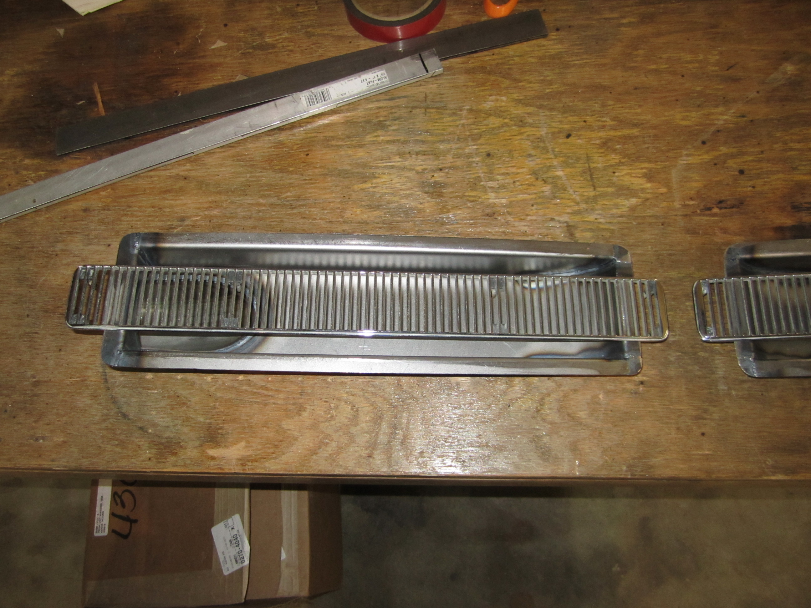

      Also removed the a/c vents that were at the base of the windshield and installed 63 cad vents in the dash as they are switchable on/off and adjustable direction.

      Now that's what I was asking about. Thanks you very much for your detailed reply and pics.
