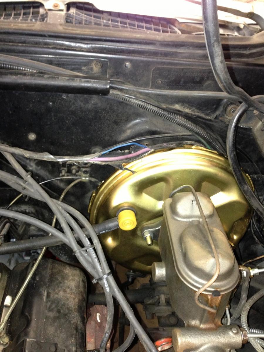

      Need help with shorted wire on 69 Impala
      Nearly done with the 5 speed swap on my car and was isolating the backup lamp wire on the steering column (ignition on) when I noticed smoke at the fire wall. Somehow, I have a shorted wire. Can someone identify what this is to help me figure out what's going on? I haven't done any extra wiring on this car and the only component I had to disconnect was the starter.
      I have been cleaning out the rat's nest of aftermarket stereo wires but it shouldn't have an effect on this. Anyway, here's the picture. The bundle is a blue, purple and white glass insulated wire. It's the glass insulated wire that is getting hot.

      Most of the GM's of that era use standard colored wiring. I bet these are the ones-
      Dark blue = oil pressure switch
      Purple = solenoid S terminal (starter crank) from clutch switch.
      White cloth = ignition resistive wire to + terminal on coil.

      You are correct. Now that I think about it, I have not hooked the distributor wires back up since reinstalling it (converted to HEI). Probably, I have a dangling wire shorting to the block.
