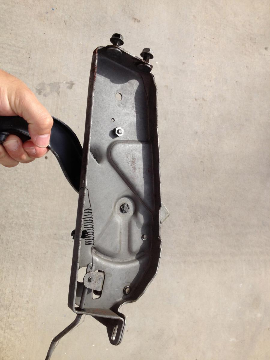

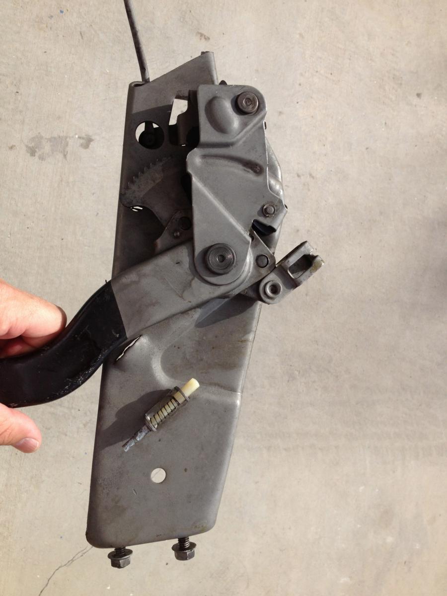

      I was at Harbor Tool yesterday picking up a sandblast cabinet when I saw this Evapo-Rust stuff and thought what the hell, I値l give it a try.
      I知 amazed at the results from an overnight soak. I知 reconditioning what ever I can from my 69 Camaro. With this stuff I can practically re use the whole car. If only I could dip the frame in it. Here is a after pic of the Ebrake. It was nasty but salvagable.

      Yes Sir. I picked up a small bottle to try. I used it on all the body bolts on my 68 C10 and I was amazed. 24 hr. bath, rinse and dry and they thread in like brand new. No more standing at the blast cabinet for hours doing bolts.
