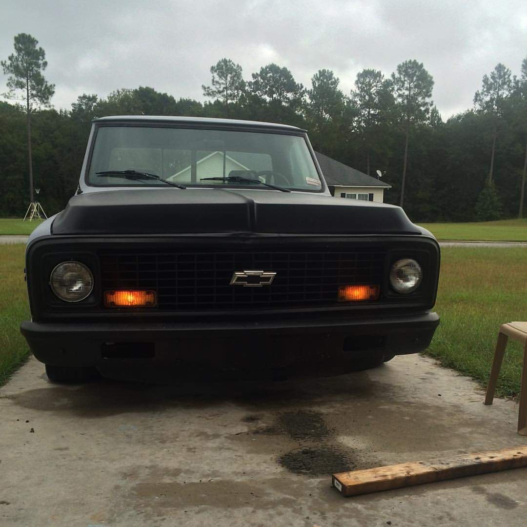

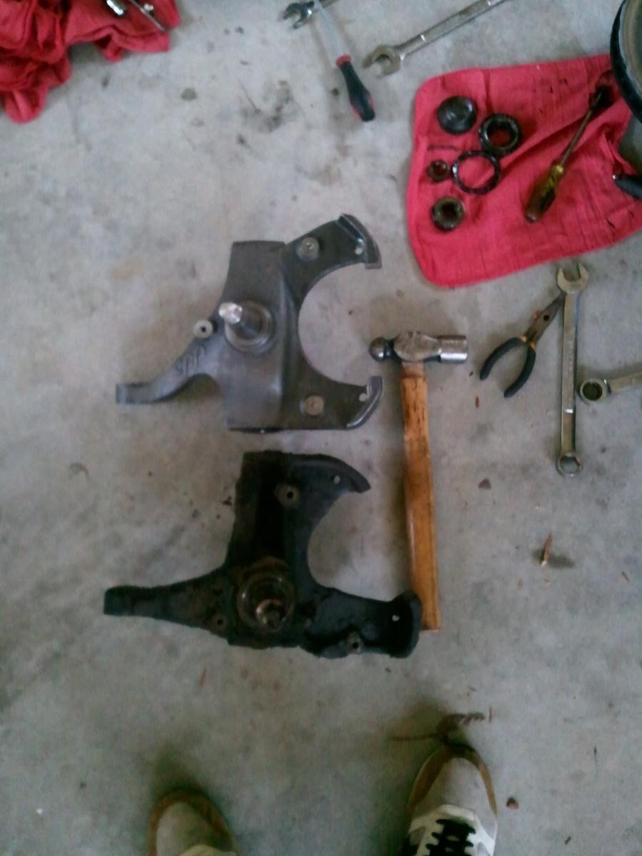

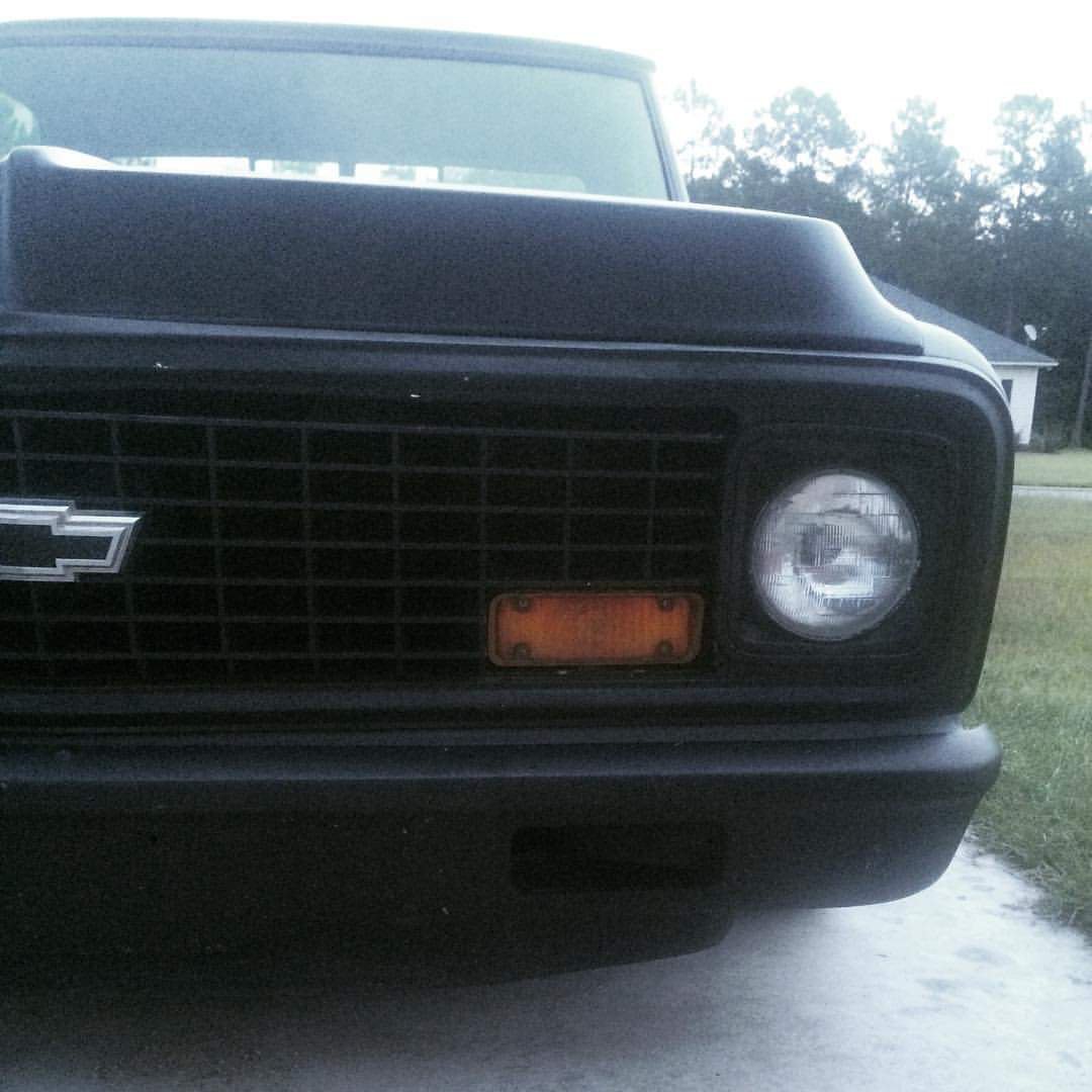

      I'm pretty fresh to the site but I figured I'd share my slow and steady buildup of my daily driver. My progress is at a bit of a standstill since I'm deployed to Afghanistan but my parts list is growing. My pictures are are limited since most of them are of it in its current state. So far I've rebuilt the rear with a 3.73 posi, mild shift kit in the trans, put a lopey bump stick in it, vortec cyl heads, drop spring and spindles for 5.5" drop in the front and 5" in the rear, front and rear sway bars and other smaller things. Keeping it drivable on a daily basis kills money for speed parts but it's nice to drive a classic everyday.
      Here's a couple of it when I first got bit by the handling bug and lowered it 3" all the way around

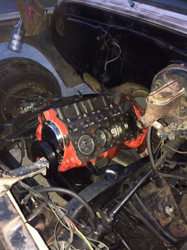

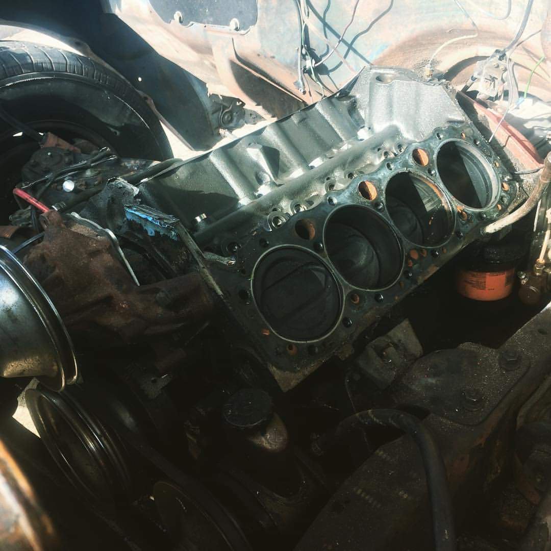

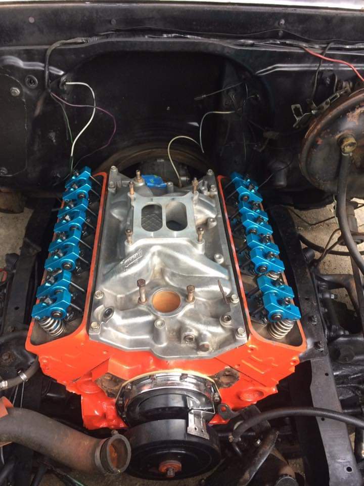

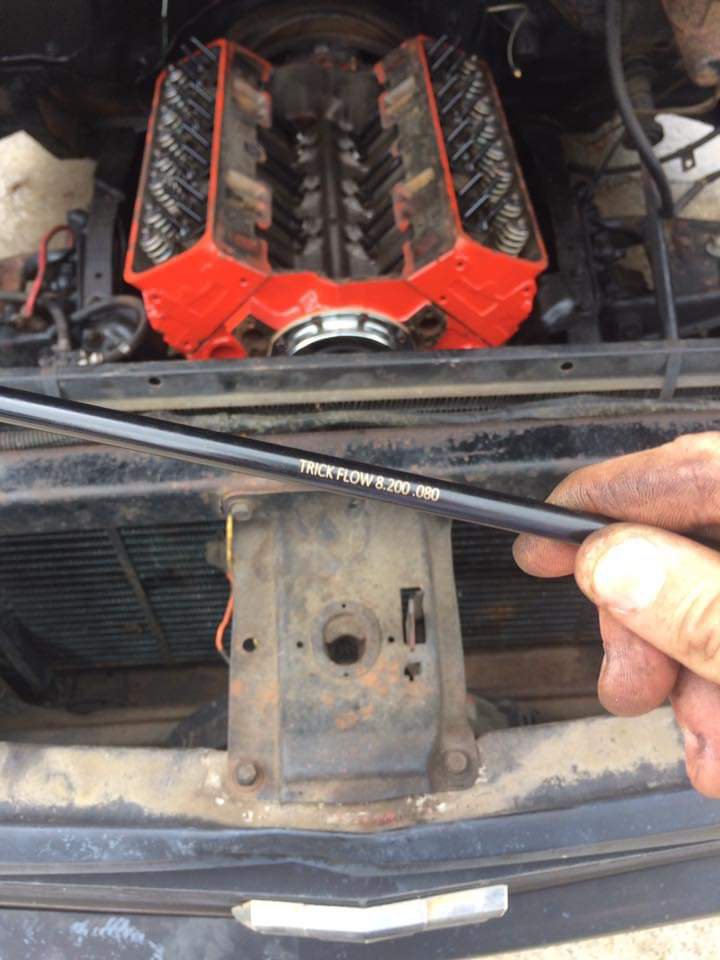

      The previous owner bought a remanned engine from advance auto that was on the receipt as a 350 but the casting was a 307. This kept me wondering what it really was until I pulled the old 305 heads off found out it really was a 350. The vortec heads really woke it up but the cam is almost too big for a stock converter

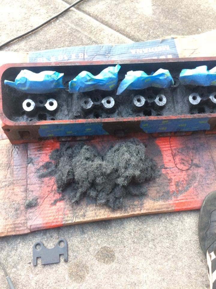

      Got caught by the road gremlins for not taking spark plug length into consideration. Had me fooled for a bit but finally got it straightened out

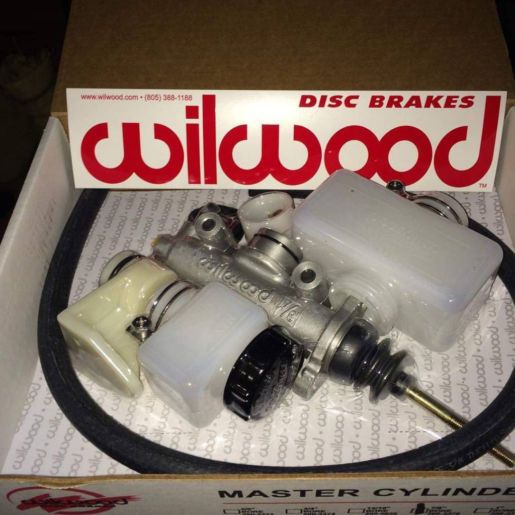

      Starting with relocating the turn signals and swapping in the 4 speed. I had to make my own hydraulic setup since I couldn't get all the linkages. Used a wilwood 7/8 bore master cylinder and a 7/8 bore slave cylinder from I believe a Toyota pickup. Name:  FB_IMG_1543806309827.jpeg

      Up next was the living room engine build. This was a long part because I spun the bearing while I was moving and still had to haul one last load. Limped it there and back successfully but then it sat forever because I went to Europe for 6 months. When I got back I limped it to the local junkyard and snagged a motor. Went through the thing and replaced all the bearings but never noticed the horrible ridge ring at the top of the cylinders, the block was already .080 over... I realized this after firing it up and having a God awful amount of blow by.
      Yanked that motor out and put the crank and all the bearings in my old block. Slapped it together and then drove it from GA to NC loaded down from getting out of the army. After I got back it started a slight knock and had about 5 psi of oil pressure at idle. Then an old army buddy hit me up with an offer I couldnt pass upName:  FB_IMG_1543807000686.jpeg
