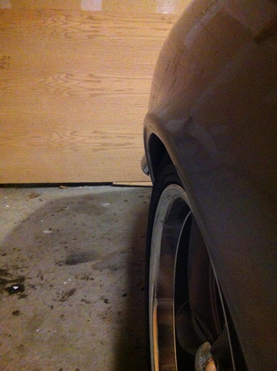

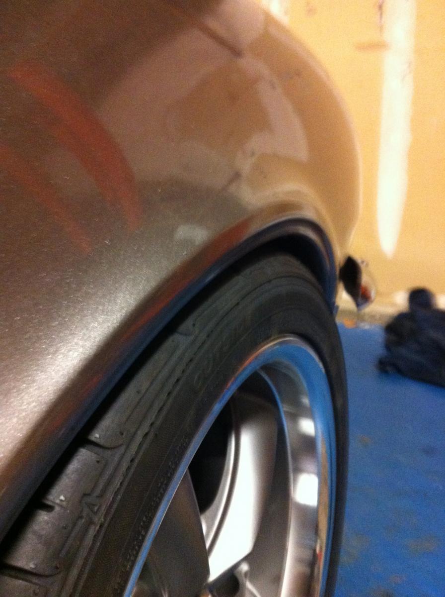

      Is my subframe off center?
      I just got a 68 camaro, and when I lowered it I noticed that the front drivers side wheel is inside the fender about half an inch and the passenger side is lined up with the outside of the fender lip. Is my whole subframe off-center? or could it be something else? It was like this before I lowered it, but you couldn't see it.

      Here is the front drivers sideName:  IMG_0759.jpg
Size:  123.1 KBName:  IMG_0766.jpg
      And this is the front passenger side
Size:  117.5 KBName:  IMG_0765.jpg

      Check your camber. It moves the tops of the wheels in/out.

      I "think" it's the whole wheel is stuck out more?

      Do you know if the fenders are the same manufacture? I had a similar problem and one day while looking at them noticed both fenders were shaped slightly different. I think the guy who owned it before me used a cheap knock off on one side. Change the fenders and it helped out. Also take it to a frame shop and have them check it out. It might have been damaged/repaired but still not be totally straight.
