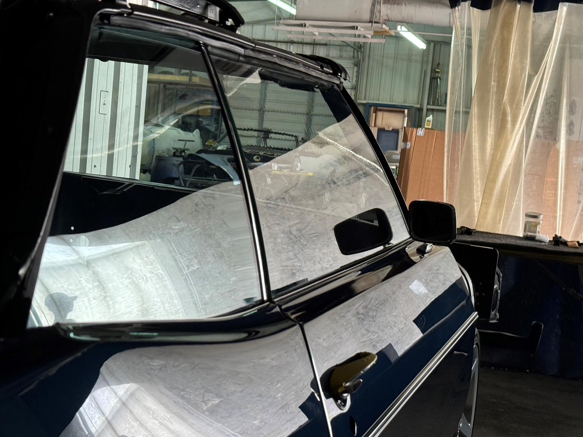

      Dropped off the rocker trim today and was greeted with more assembly work. I should have the car in my garage in a couple of weeks.
      That top frame I restored has just been sitting up until today. Aftermarket door glass is pretty wavy looking through it off 90 degrees and I don't know if there's anything to be done. There's only one vendor for it. The rear quarter glass is OE for comparison.
      Name:  new glass.jpg

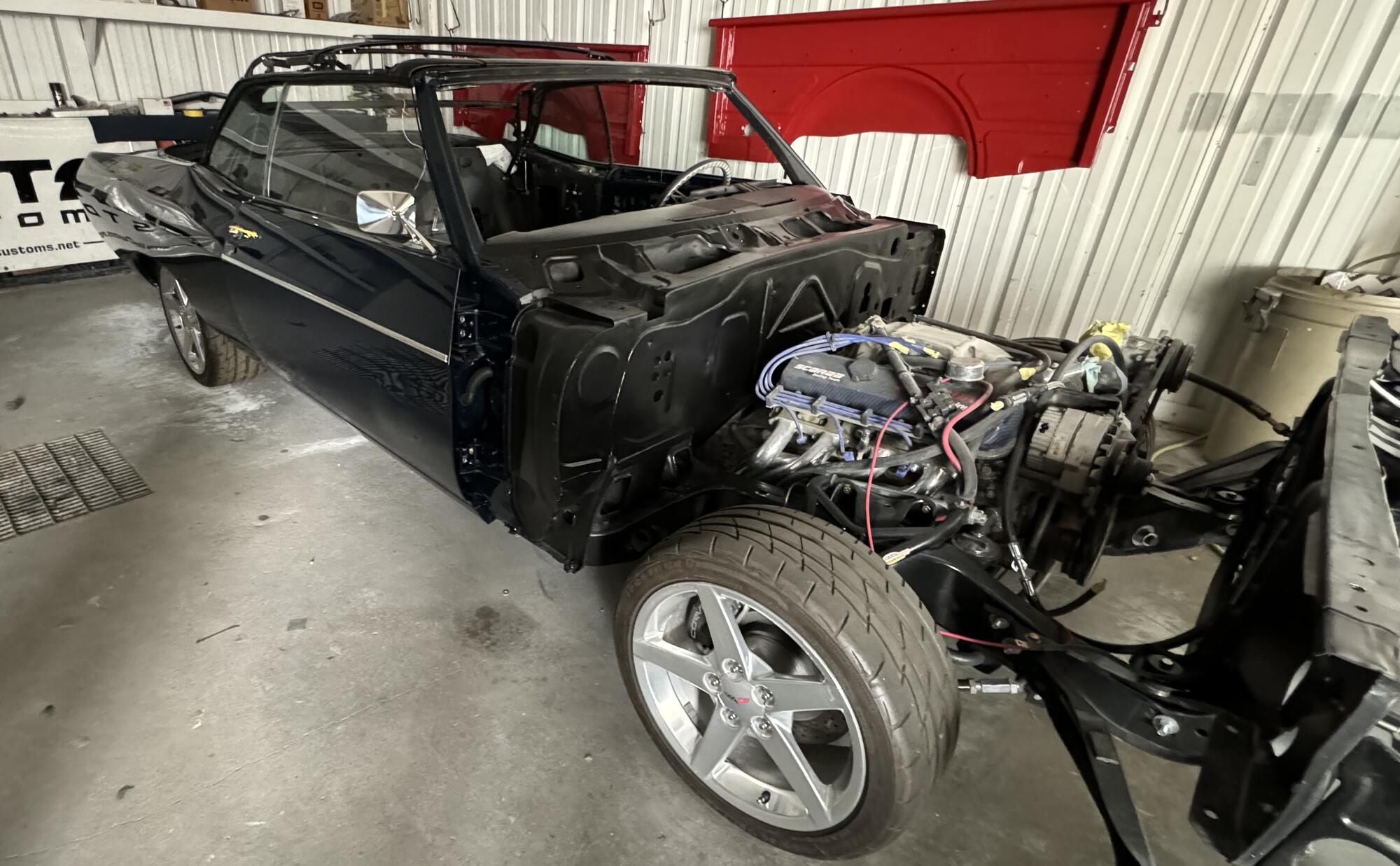

      Feb 2013
      South Carolina
      935
      She’s coming home this week!
      I wanted the fuel tank installed plus the shop resprayed the fender liners and assorted pieces to match the firewall. Now I’m on the clock

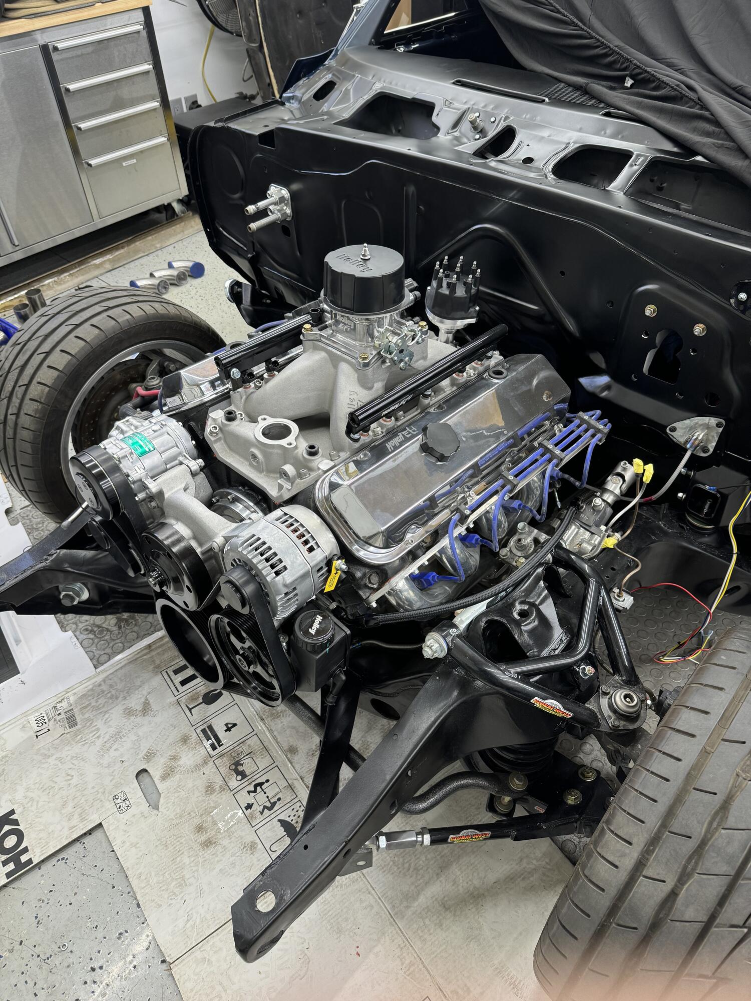

      Starting to put things back together. First two are engine and fuel lines. The Holley accessory kit was a splurge but I really like the package.
      Also have a Malwood hydraulic clutch pedal coming tomorrow. I was going to use the American Powertrain kit and I thought I had room because I checked the slave cylinder against the firewall some time ago. I think maybe the fender supports were not attached???

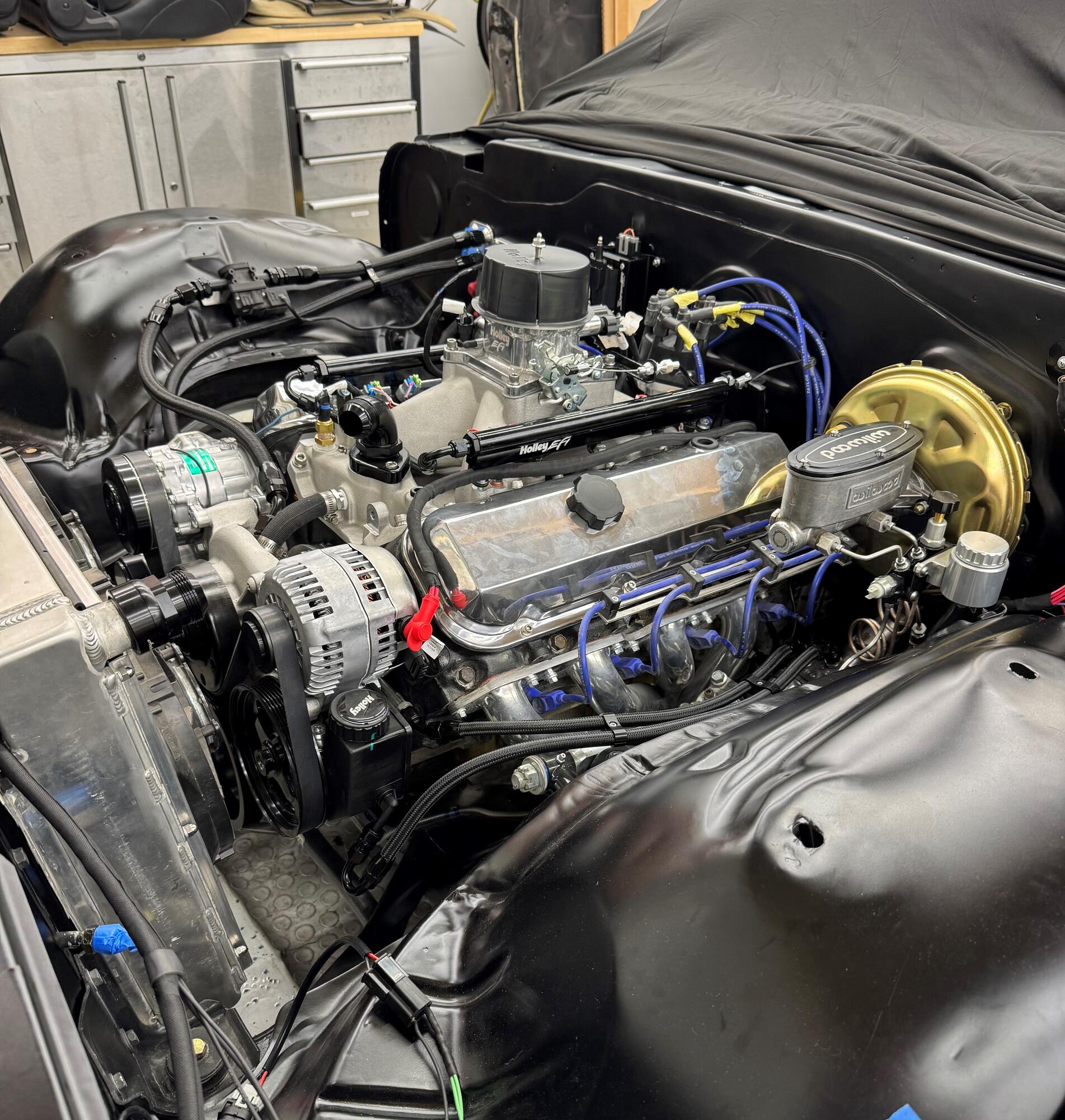

      Gratuitous engine porn.

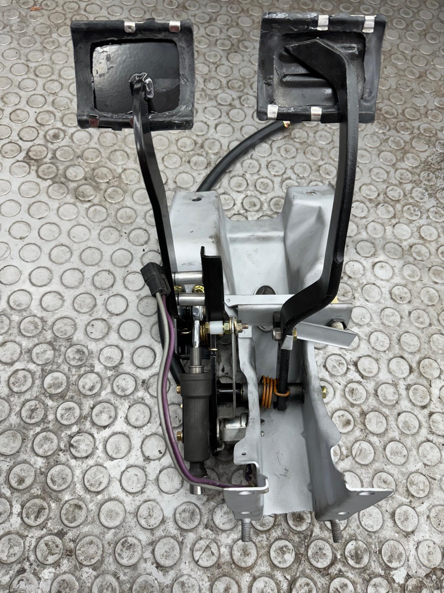

      Also been working on bleeding the clutch cylinder for 3 weeks. Bleeding is actually not the hard part, I needed to figure some things out. I couldn’t use the American Powertrain slave because there was not enough clearance. The Malwood pedal is a good piece but I had some fabricating to do in order to keep my factory clutch switch. After that I needed a firewall pass through since the factory linkage was gone. Figured the OE firewall boot would work but no. Made a panel to install a grommet and decided passing through a grommet at 90 degrees would not look the way I wanted. I came up with this. Firewall will still be sealed, I get my grommet and no awkward cable angle.

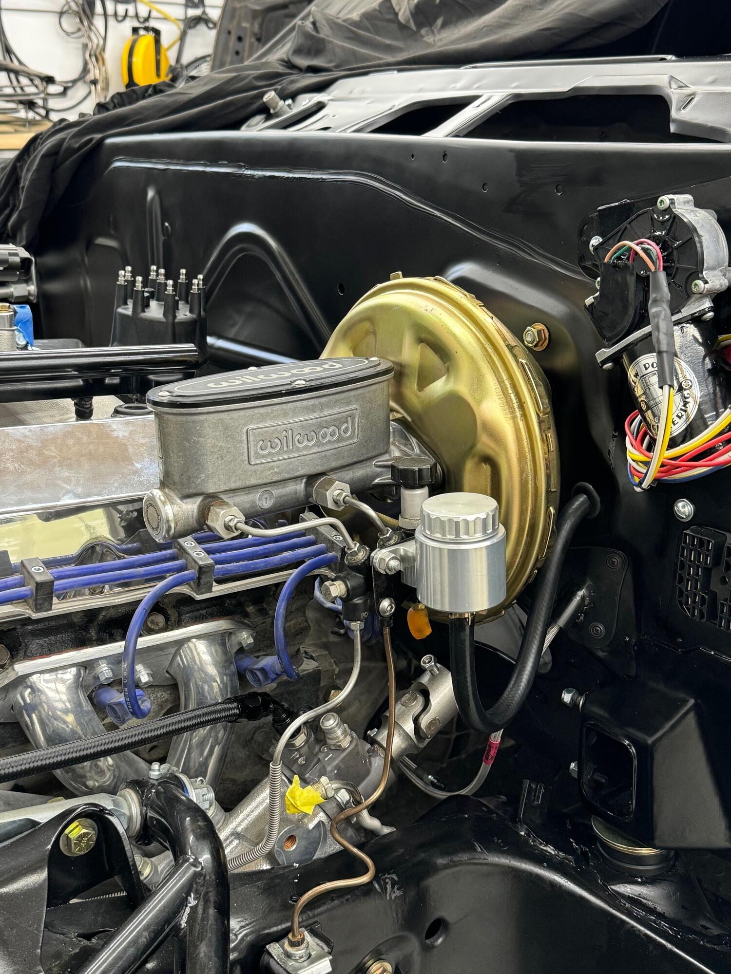

    8. #308
      Feb 2013
      South Carolina
      935

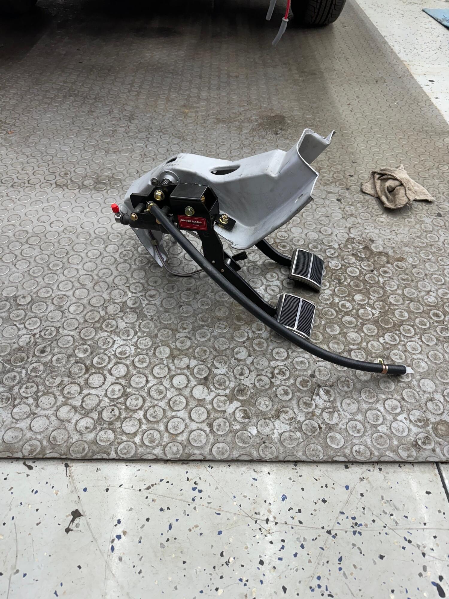

      Back to a working clutch. The Malwood unit is well built but I suffered from the usual "just be grateful they have a 69 Impala part" syndrome. The factory clutch switch was a challenge because the arc of the pedal is different and you can't just make a new pin to mount to the pedal. I learned this the hard way. Ended up with a nylon roller mechanism that moves the switch the correct amount and keeps OE operation. I needed to move the pedal over about 1mm with a shim to leave the switch enough clearance. Also, Malwood's method for pedal height adjustment does not appear to apply on the Impala model. I ended up shimming the mounting tab with about 4 washers to rotate the entire assembly forward and get my pedals to the same height. It was time consuming but I have something that looks clean and operates like it should.
      Name:  clutch pedal 3.jpg
      Name:  clutch pedal 2.jpg
      Name:  clutch pedal 1.jpg
      Pressure bled the slave cylinder and calling it done. Malwood's reservoir is the correct diameter for motorcycle/European fluid reservoirs but they chose a fine thread instead of a coarse thread so the pressure cap doesn't work. I bled from the line and attached the reservoir afterward.

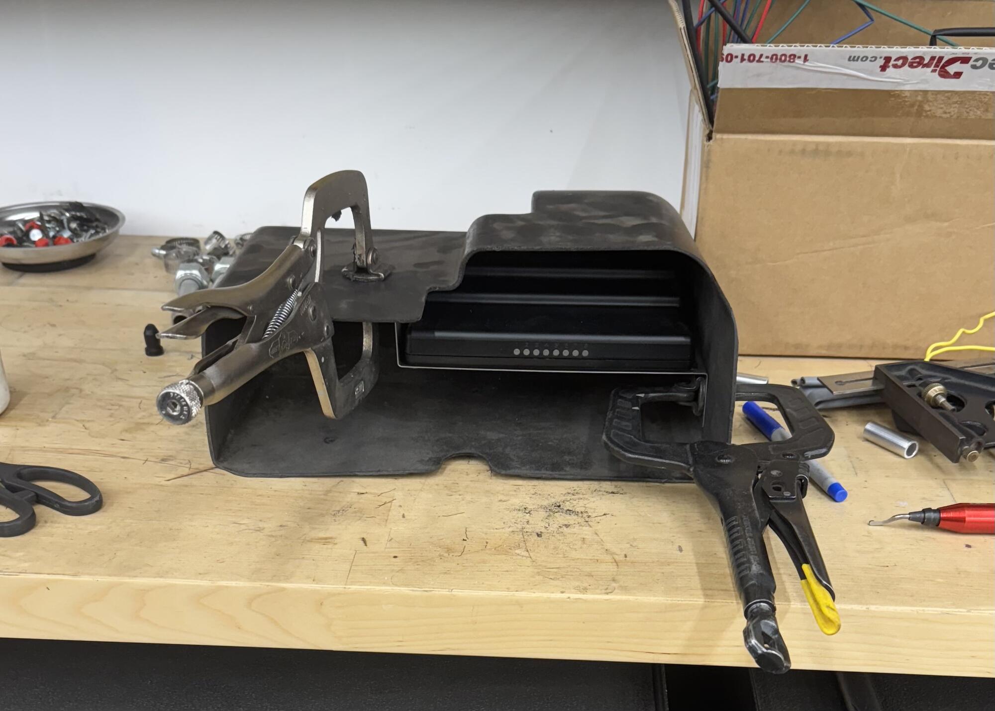

    10. #310
      Feb 2013
      South Carolina
      935
      Welded up the last of the exhaust this weekend and ground out the welds where pipe would be visible.
      Also figured out what I’m doing with the battery.
      Terrible time getting the convertible top cylinders bled though.

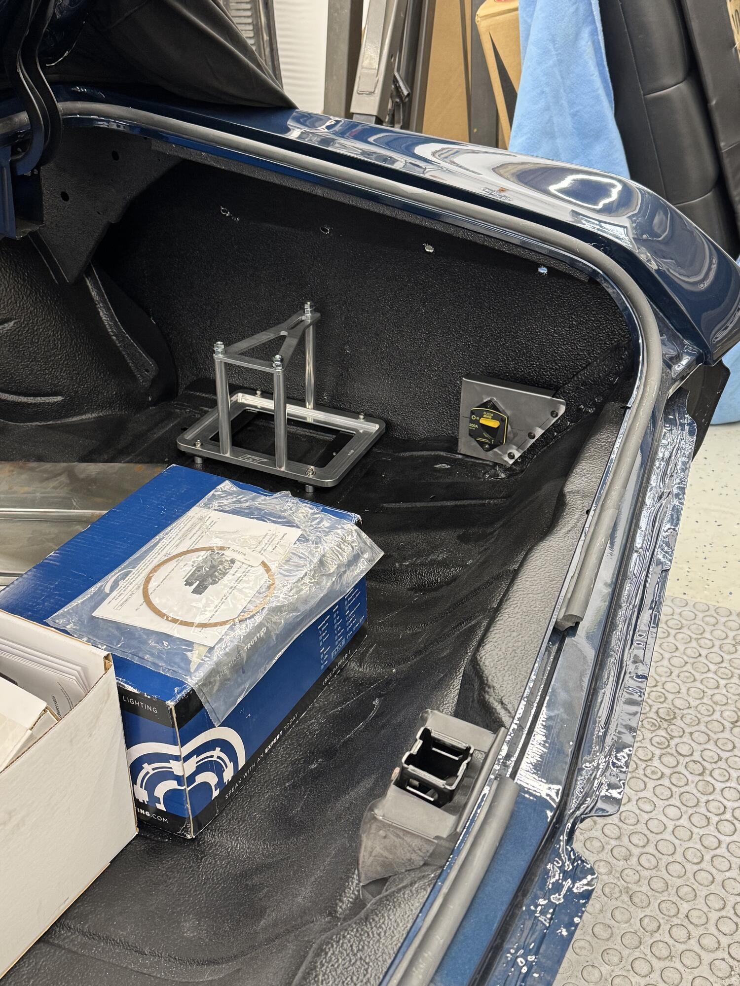

    11. #311
      Feb 2013
      South Carolina
      935
      So this is fun….

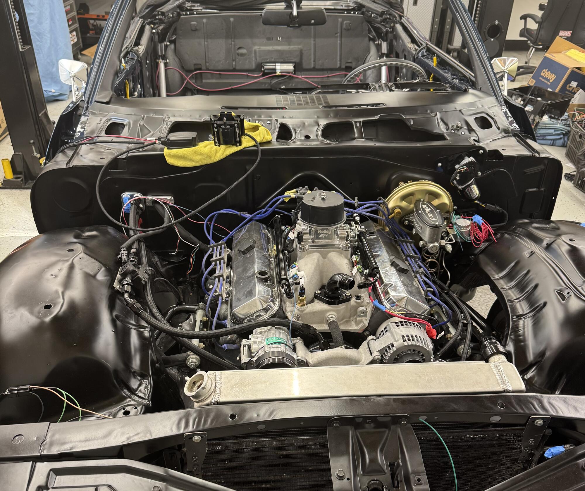

    17. #317
      Feb 2013
      South Carolina
      935
      Not much to see visually but this is weeks of crimping, stripping, soldering, and looming wires. All of the basic stock wiring is done and all of the ECU wiring is done. Still have some minor tucking and so on but here we are. Still need to hook up the fans and fuel pump. Then back to the fun stuff. I did go ahead with a new condenser when I realized the Vintage Air one would solve my AC compressor relocating to the passenger side issue so when that comes I'll use the open space opportunity to set up the distributor. That should be the weekend I try to crank it.
      Name:  engine wiring 1.jpg
