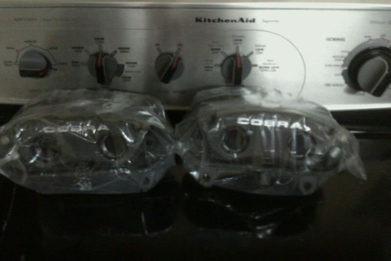

      Vintage Venom drilled/slotted Cobra brake Kit

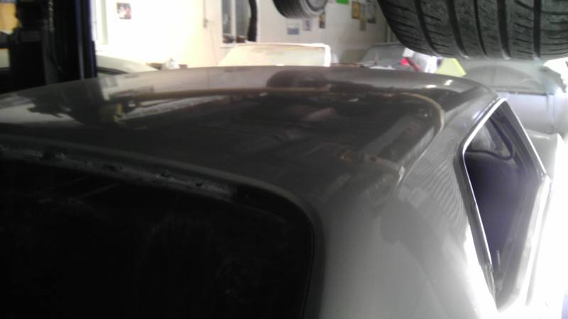

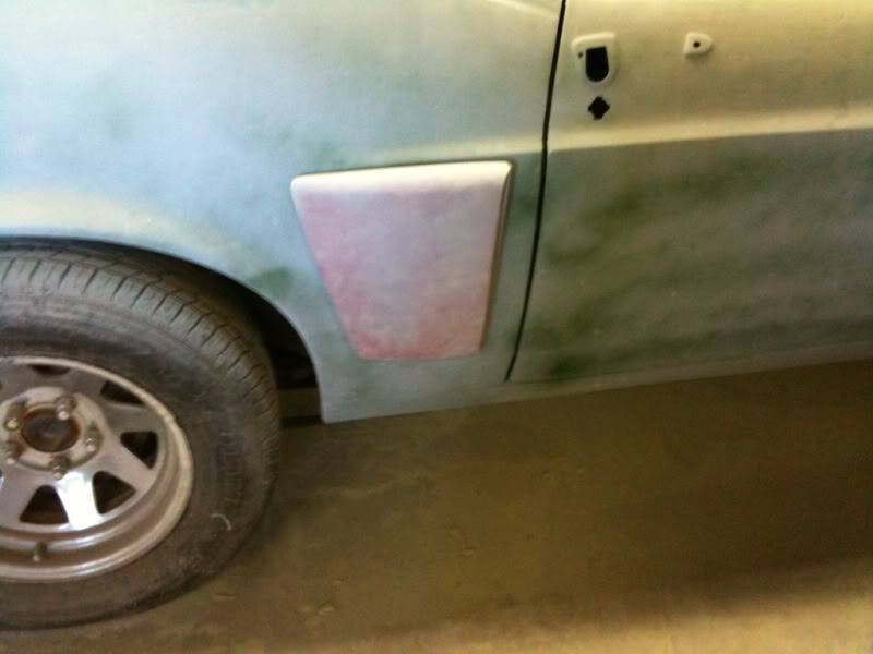

      currently debating if I should paint the hood or not:
      Anyways here are some pictures of the build:

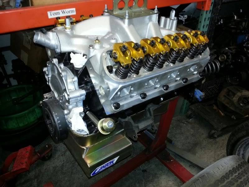

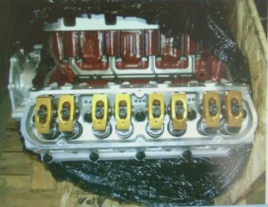

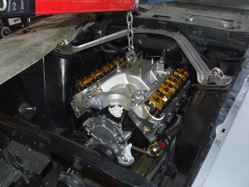

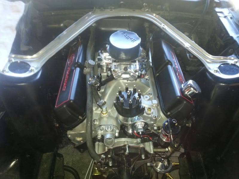

      Engine/brakes
      thats all I have for now I will post updates as I go :D

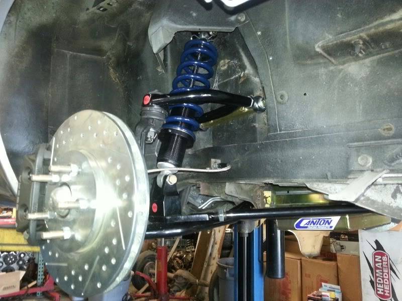

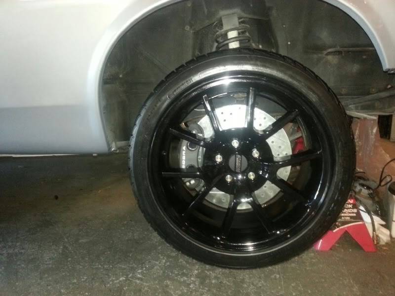

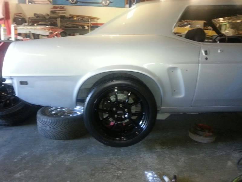

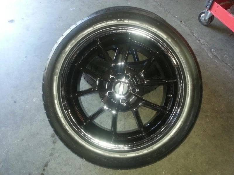

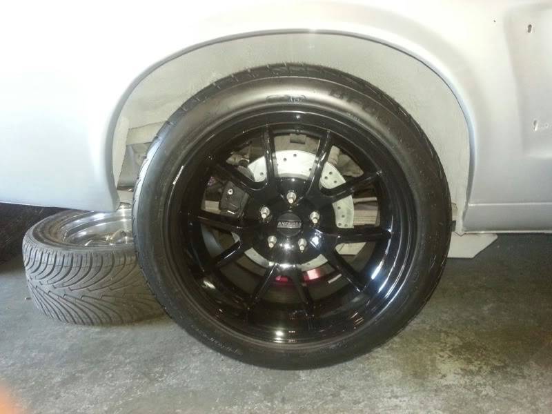

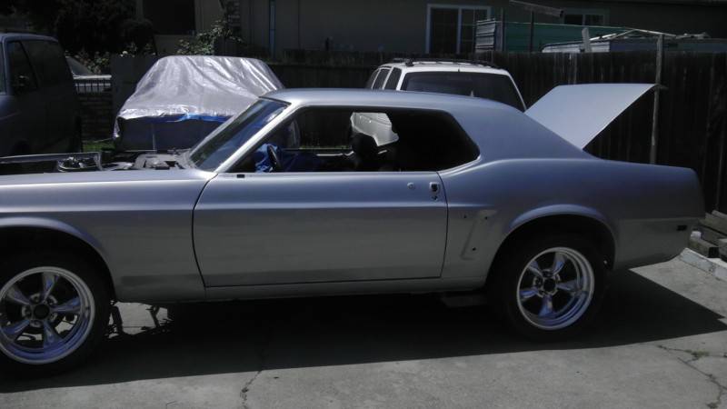

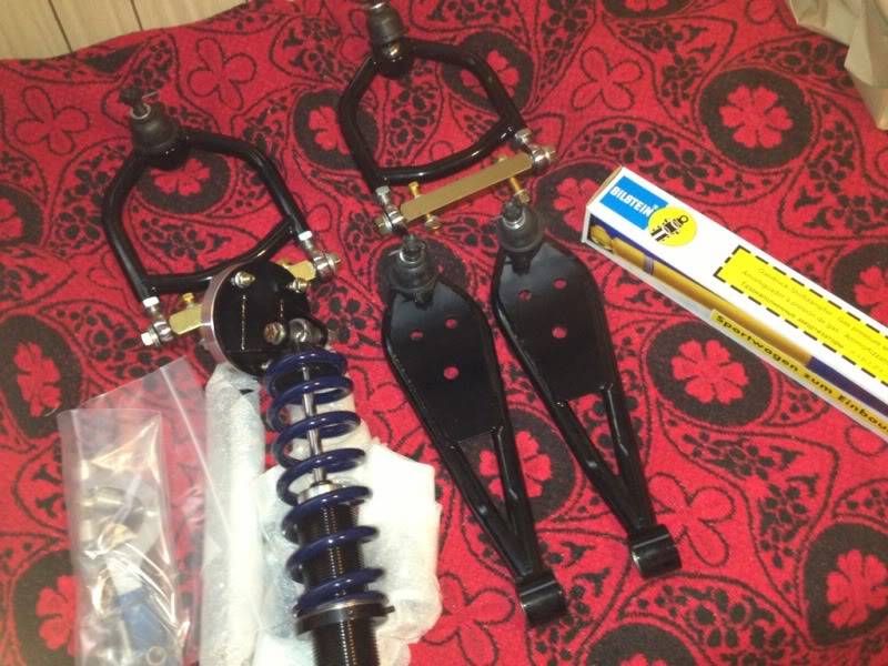

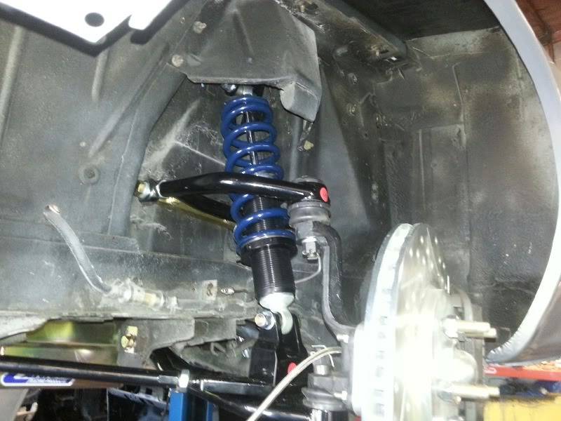

      Just received my coil over conversion from Street or Track!!! Can't wait to install them, Thank Shaun!

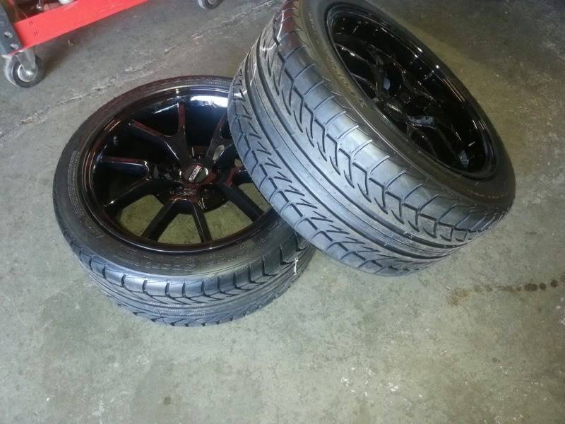

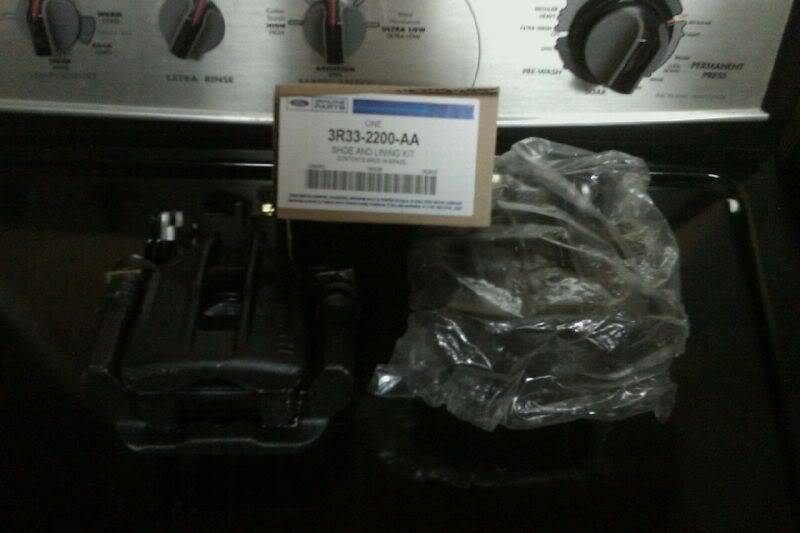

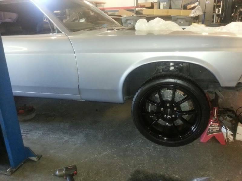

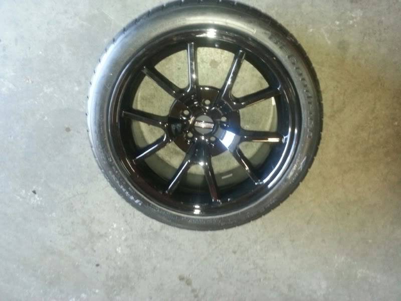

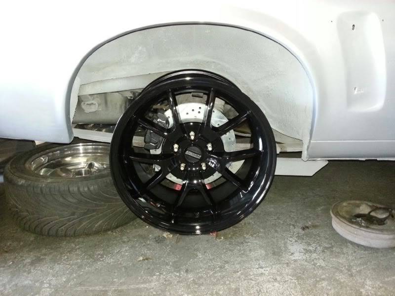

      news: so we have the tires mounted and we are waiting on lug nuts. we did encounter a problem the rear brake lines are wrong so we will be replacing that along we are debating if we should/have modify the e-brake so the shop will be calling Vintage Venom.
      Slowly but surely the car is coming along nicely. :D

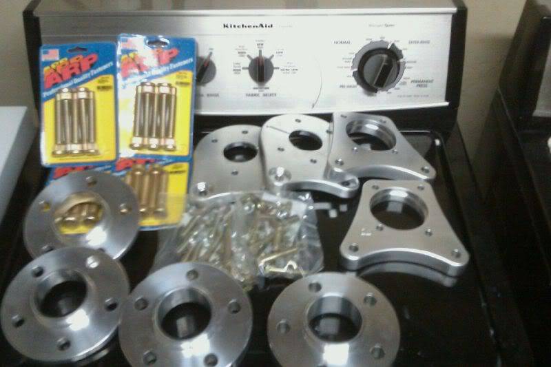

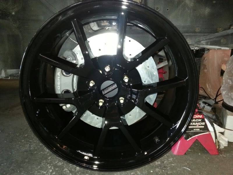

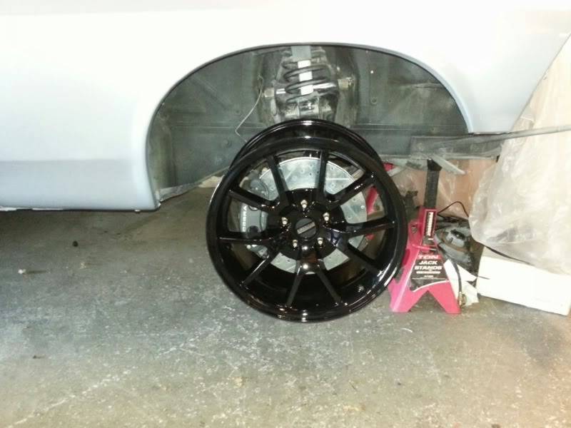

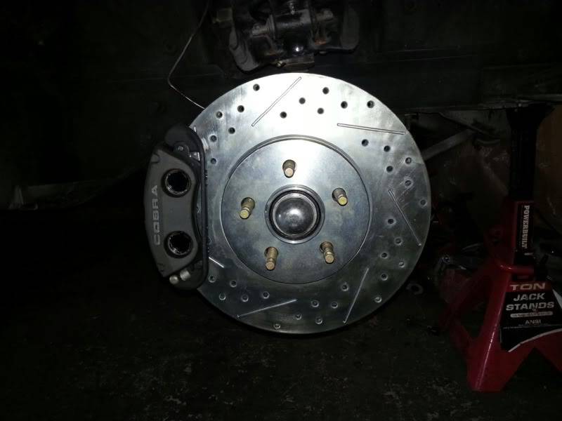

      Where did you get the brake brackets from?
      Jun 2010
      Redwood City, CA
      69
      these came with the brake kit, they are from Vintage Venom. http://www.vintagevenom.com/front-di...ersion-kit.htm
      1969 Mustang Coupe 392w Stroker
      16,129
      Quote Originally Posted by rwcstang View Post
      I am assuming that the spacers are to allow for the use of the newer Mustang wheels?
      Jun 2010
      Redwood City, CA
      69
      yes, this spacer will require me to run new mustang wheels or any aftermarket wheel as long as i keep it under the specs of the 99-04 mustang.
      from the site:
      "The spacer is best located between the hub and the rotor. This maintains the direct interface between the two working surfaces (the wheel and the rotor) and simply serves as a hub modification. Additionally, the ARP stud knurls grab the spacer once installed making it essentially integrated with the hub. No more fumbling with wheel spacers every time you pull a wheel off..! Also, this design allows the spacer to be fully piloted by the original hub allowing the spacer to properly pilot the rotor and wheel concentric to the hub. Therefore, neither the rotor nor the wheel is relying on the wheel studs to determine their locations."

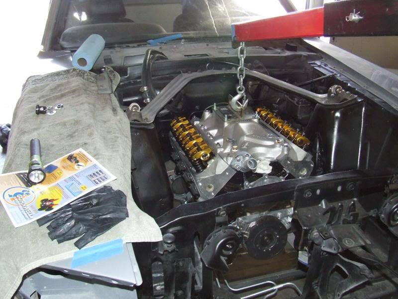

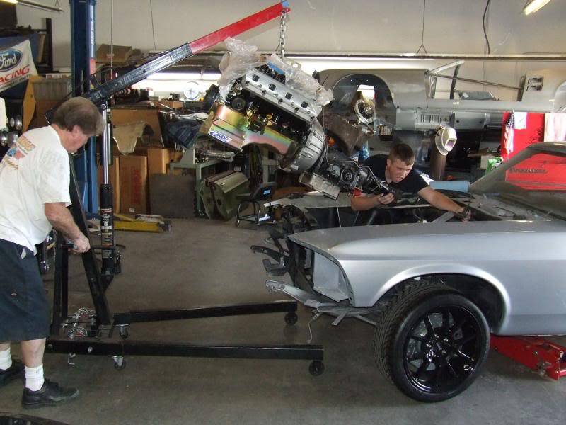

      You have a well thought out street car underway. Wheels, brakes, suspension, and drivetrain are all nicely updated and much more sorted out than my first attempt, that's for sure. I would suggest a mounted fire extinguisher, a seat with good side supports, and a panhard or watts link as your next few mods. Then just drive the heck out of it!
      on edit- I also meant to say those engine cranes make me nervous. Years ago, I had a piston fail on me while my fathers 350 SBC was out. I was rolling it out from the car and without notice or any sound really it just let the engine smash into the driveway. In hindsight, the piston may have sideloaded the seal momentarily as I tugged the crane away from the car, but holy crow. Totally destroyed the stock pan and oil pickup, and my faith in hydraulic jacks and lifts. Moments before I had my hands under that thing... Live and learn.
      Jun 2010
      Redwood City, CA
      69
      Quote Originally Posted by gsxrken View Post
      hey Gsxken,
      thanks for the tips, I was thinking of going with Maier racing's panhard and subframe connectors since I live 20mins away from from them. as for the seats, I'm really leaning toward scats rally car seats but I'm not sure if they are worth the money though... I wanted to go with TMI Sport seats but I've read alot of ppl complaining about their kits.
      I never had a problem with the engine cranes, but man that is a nightmare. makes me think twice! lol

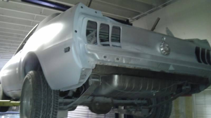

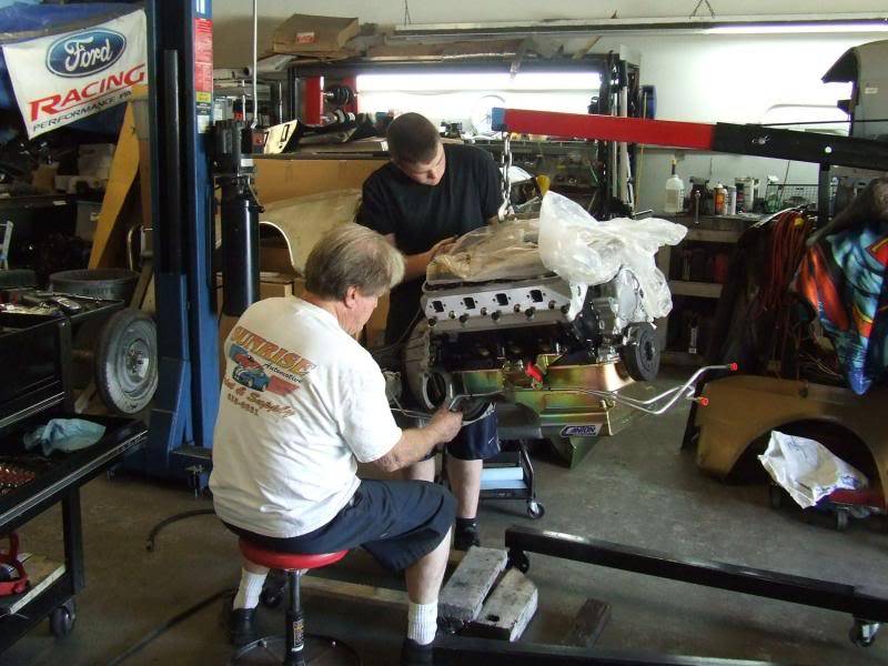

      new pics, sorry I didn't get any more pics. I will be taking pics later with the SOT setup along with new leafs and shocks and Exhaust :D

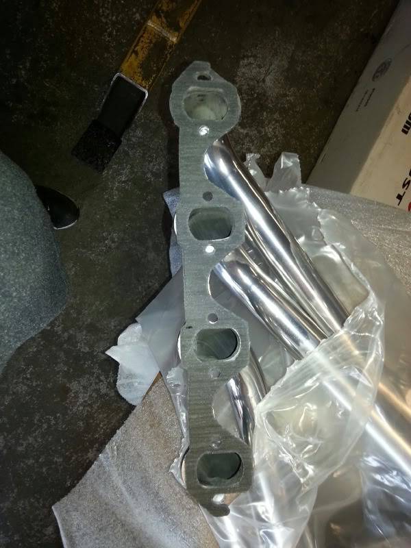

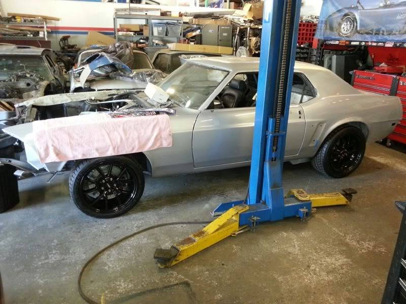

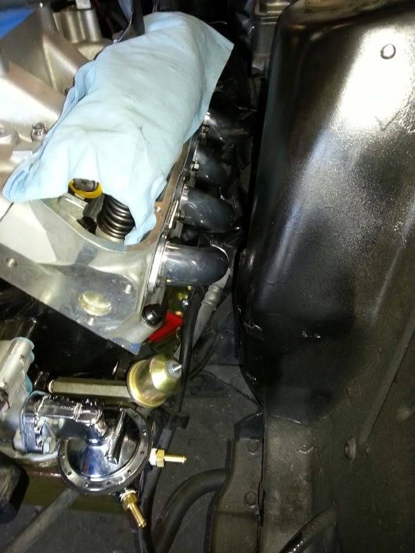

      Updates:

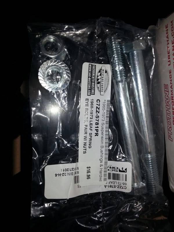

      my SOT Coil overs and Leafs are going to be installed today, I had to buy new bolts and HD shackles.
      Also, my exhaust is getting fitted and with the new headers.
      Jun 2010
      Redwood City, CA
      69
      Update: SOT set-up is installed with the shelby drop! :D now the leafs! pics will be uploaded soon! :D

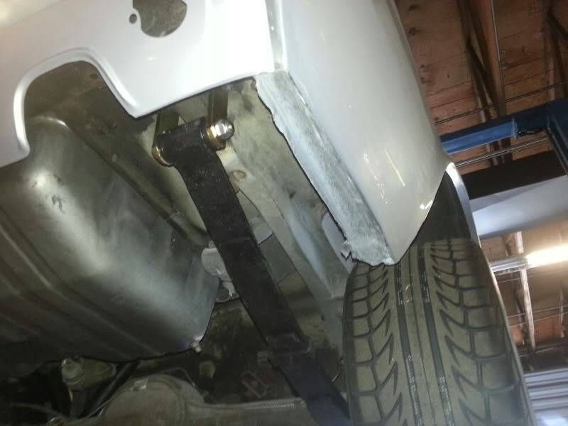

      Jun 2010
      Redwood City, CA
      69

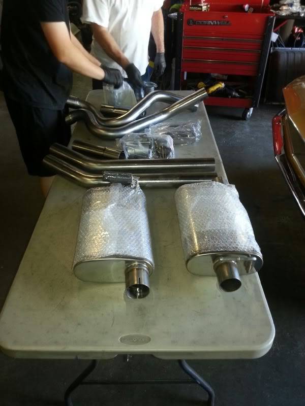

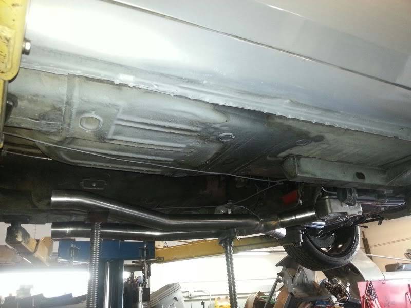

      Rear Leaf springs and Bilstein shocks are installed. I also noticed my sway bar bushings were done so I replaced them with polyurethane bushings and now its time to get the exhaust fitted:
      Exhaust:

      thanks, still have alot to do. it's located at NorCal motorsports in Sac

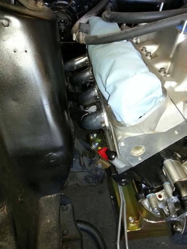

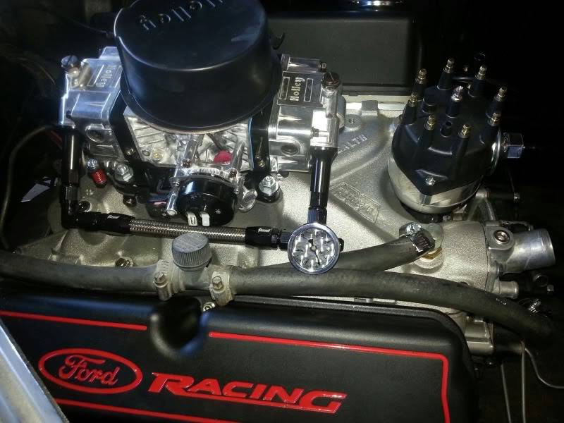

      alright so some good news everything on the motor is being fitted. only thing that's left to replace are:
      brake/fuel lines
      front belt drive accessories
      welding up the exhaust tips
      breakin/tune motor
      adjust the coil over height
      wheel alignment
