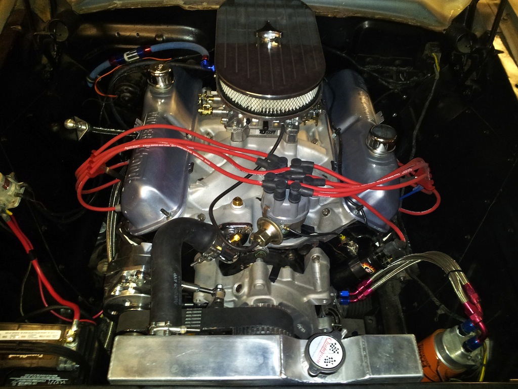

      It will fit...
      Found this on another forum - can't say if it is correct or not:
      5.0L DOHC
      28" Length
      26" Height
      27-1/2" Wide

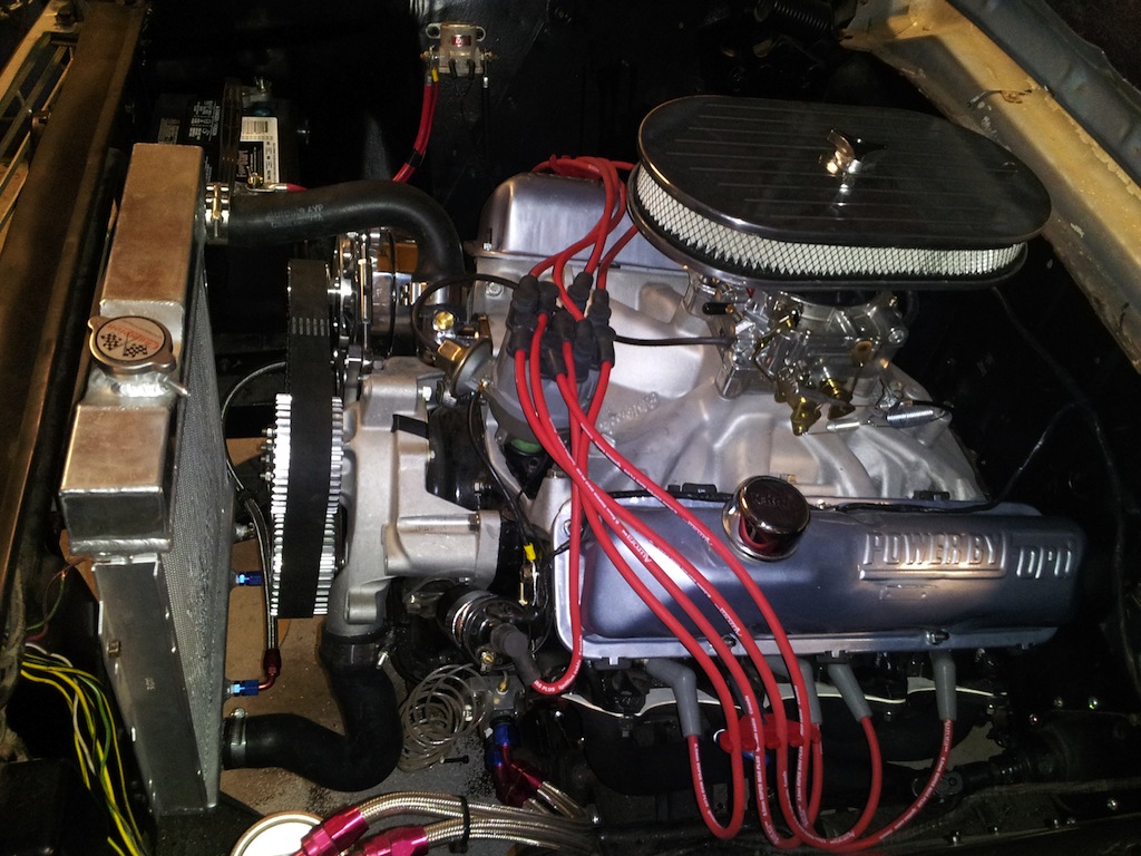

      My opinion is that it would be relatively easy to get it to fit if you do something similar to what Doodler did to fit the mod motor - removed the inner fenders completely and open up the trans tunnel area. I have an FE 390 in my 65 Falcon and a C6 trans and it required some cutting, removing shock towers, new tunnel, moving brake MC over to clear VC etc but it does fit.... and they are also fairly big motors - long and wide.
      Name:  Motor in and running.jpg
      Name:  motor in and running 3.jpg

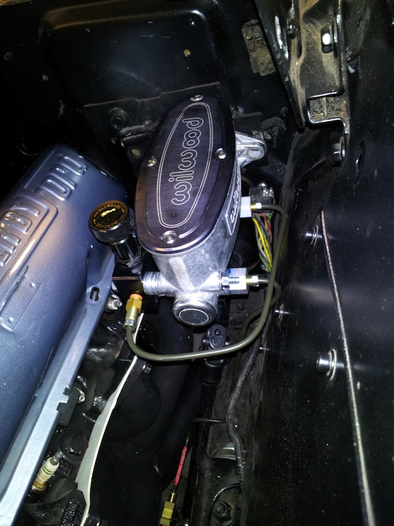

      This is the master after it was moved over 2" closer to the inner fender - it would not clear before even with the "low pro" stock valve covers.
      Fe details:
      Name:  Screen shot 2013-04-16 at 4.22.26 PM.jpg
      Name:  Screen shot 2013-04-16 at 4.22.52 PM.jpg
      I would be far more hesitant with swapping one in this early with the complexity of the ECU and wiring to get it to work properly in your older car. Drive by wire pedal, sensors everywhere, EFI retrofit to your fuel system etc. But if you feel confident with that end of things I say go for it - would certainly be bad ass!
      For what it is worth...most people I originally talked to said putting an FE in the Falcon was stupid, too nose heavy, look like a 4x4, headers will drag on the ground, handle like standing on the nose of a skateboard.....Now that it is in and done all those guys seem to have forgot those comments and think it was always the best option

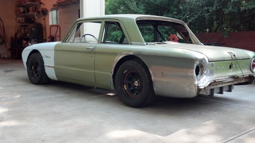

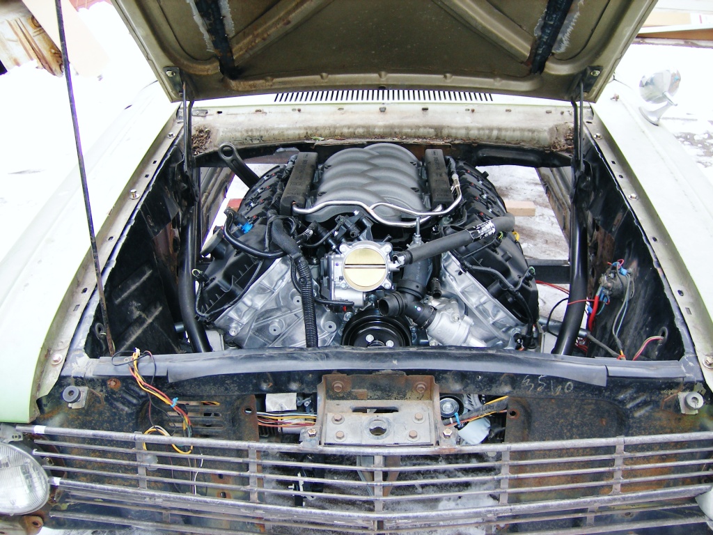

      63 falcon WITH a Coyote 5.0 already installed
      I know this is kind of a dead topic for you but....
      I Was looking around on the h.a.m.b. site and found this neat stock car inspired 63 falcon with a 5.0 coyote motor. Lots of work but will be deadly when done.
      http://www.jalopyjournal.com/forum/s...3+falcon+build
      Man that looks HUGE in there

      65Falkone, thanks for the pics! Damn! That motor IS HUGE!! Kind of glad I am going with the SBF now Looks a fun project though. I will eventually find something to stuff a Coyote in LOL!
      Roanoke (FortWorth) Texas
      786
      That motor is just STUPID large. I need to find someone at Ford to slap over this. Just stupid! Dont they know their customer base is doing averything they can to stay loyal. We could use a little help here Ford! Anyway...
      Love the look of that Falcon though.

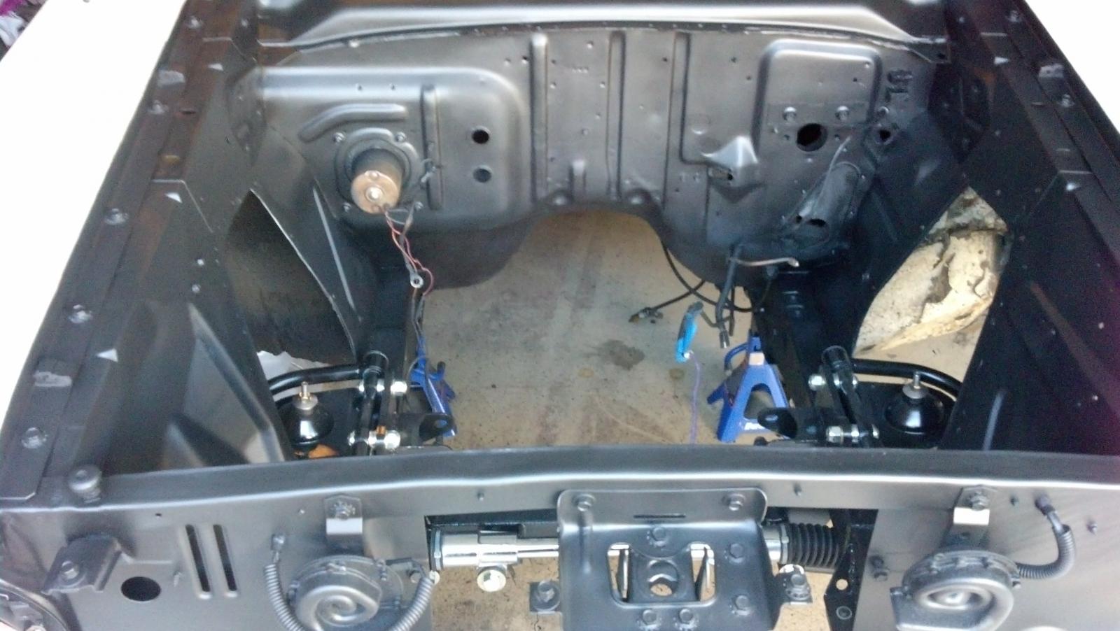

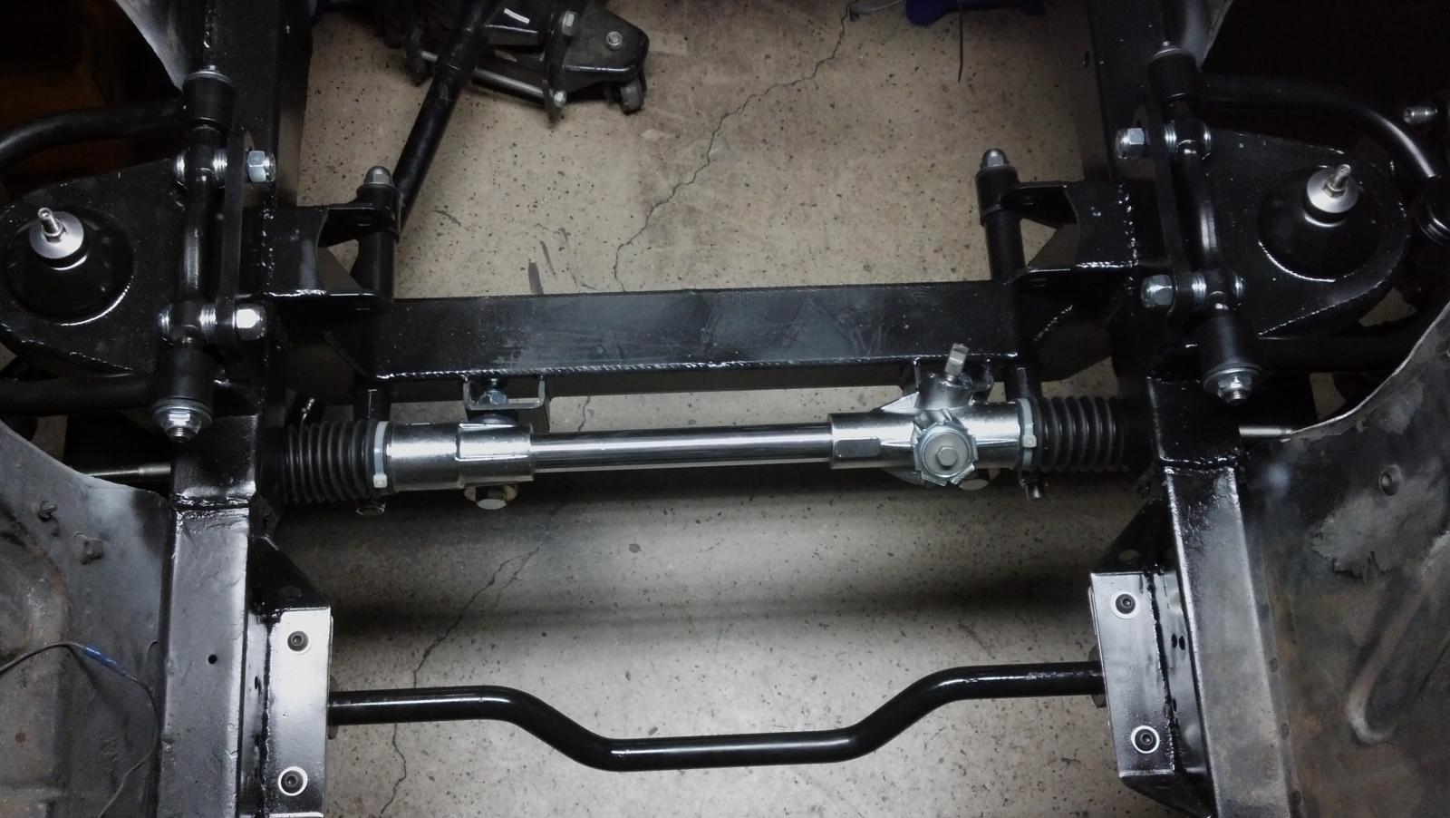

      Here are a few pics from the last couple of months. Will upload more soon. Can t wait to drive this thing!!Name:  3E33Fc3N25N85Ga5J6cc762e181e0b6f81f82.jpg
Size:  39.2 KBName:  316569_178591628952167_1985233322_n.jpg
Size:  144.6 KBName:  2013-01-13_15-50-00_750.jpg
Size:  92.1 KBName:  523345_195777670566896_1153650401_n.jpg
Size:  44.9 KBName:  379687_195777697233560_92549301_n.jpg
Size:  54.2 KBName:  2013-02-03_18-19-48_629.jpg
Size:  105.0 KBName:  2013-02-03_18-17-50_222.jpg
Size:  86.3 KBName:  2013-02-08_16-54-56_793.jpg
Size:  128.7 KBName:  2013-03-02_14-42-22_421.jpg
Size:  187.6 KBName:  2013-03-03_17-45-46_856.jpg
Size:  83.5 KBName:  2013-03-09_20-17-02_354.jpg
Size:  164.2 KBName:  2013-03-09_17-58-01_235.jpg
Size:  111.2 KBName:  IMG_20130421_183726_618.jpg
Size:  155.0 KBName:  IMG_20130426_171751_116.jpg
Size:  142.9 KBName:  IMG_20130331_201105_520.jpg
