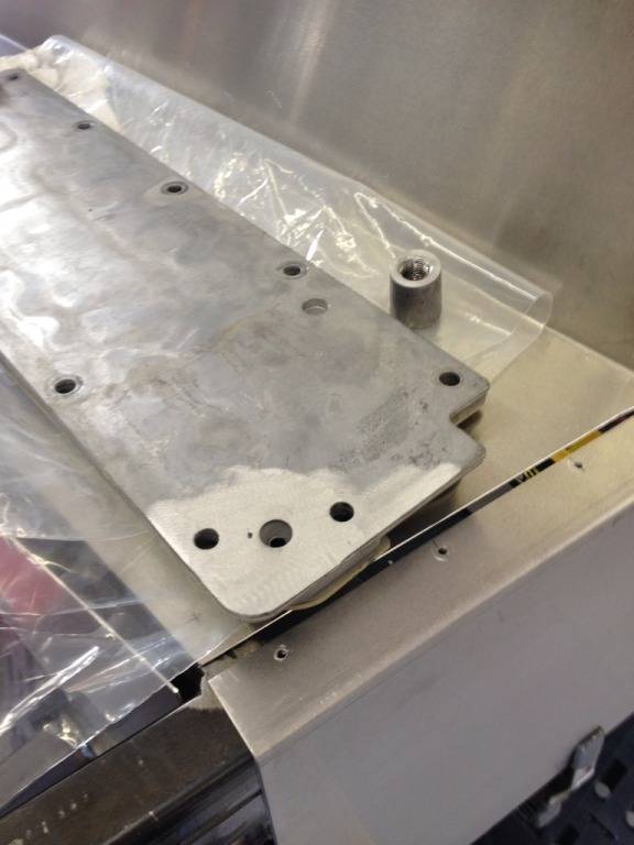

      I also installed the Corvette style oil pan (loosely) and pick up. The engine will get a Corvette harmonic balancer and water pump also to clear the chassis.
      Side note, I ordered LS9 push rods and timing chain with the cam. Further research shows them to be the same GM part numbers as the L92 timing chain and push rods. Looks like GM puts the good stuff in the truck engines too!

      To that end. Can someone advise what the substance is called that GM puts in the corner of the gaskets? It is an off white and stays tacky, sort of like plumbers' putty. Though I realize thats not what it is.
      It's donkey spunk...LOL
      I've used black RTV with success.

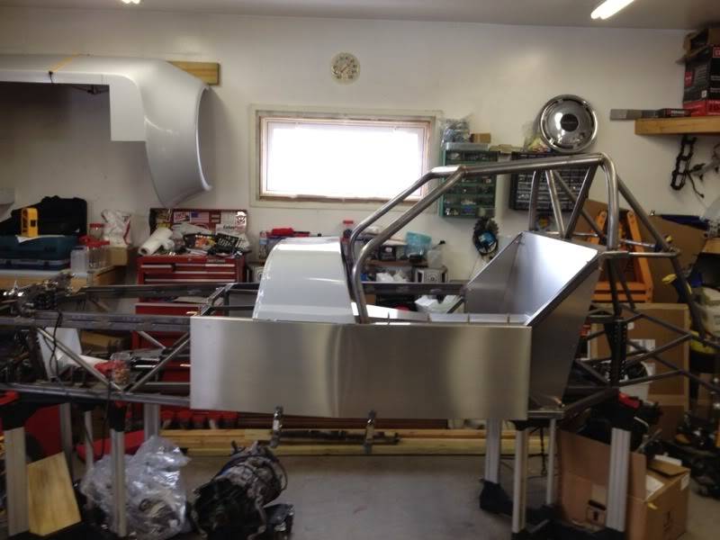

      I got a little more work in today. I finished off the top of the trans tunnel. All the clamps, lumber, and square stock are to create the slight bend in the panel as it transitions to flat:
      I cut in the rough shape of the scuttle onto the fire-wall shelf, and fit the fiberglass dash to the scuttle's rear side:
      We made up templates out of cardboard yesterday. That really helped making the cuts to the shelf and dash.
      I completely wrapped the fiberglass dash in painters tape to avoid scratching it.
      I only have a couple more pieces of aluminum to fit (the other side panel, 2 trim pieces that go under the hood, and a simple foot well panel).

      I was able to finish off the aluminum panels.
