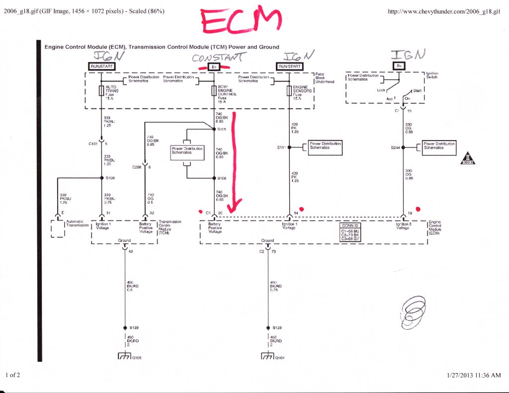

      Hey all,
      One more electrical question about the trans... Do I need to supply the TCM with (switched or constant) 12v on Pin 31, in the same manner the ECM is?

      Let me add the wiring diagram for a better picture of what I'm talking about...
      It seems to make sense to wire the TCM the same way the ECM is powered as per the factory wiring diagram. Just looking for confirmation before I hide all the wiring.
