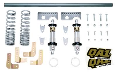

      Bird 77 Philippines project Part 4
      Coil-Over Conversion, Rear, Universal, Kit.................. adapted for my application
      Brand:QA1 Precision Products
      Manufacturer's Part Number:ALN4000K
      Part Type:Coil-Over Kits
      Product Line:QA1 Pro Coil-Over Conversion Systems
      Summit Racing Part Number:HAL-ALN4000K
      UPC:806990000811
      Suspension Height Adjustment:Stock
      Coil-Over Kit Position:Rear
      Recommended Rear-End Weight:1,551-1,850 lbs.
      Shocks Included:Yes
      Adjustable Valving:No
      Gas Charged:No
      Extended Length (in):16.250 in.
      Collapsed Length (in):11.125 in.
      Upper Mount:Eyelet
      Lower Mount:Eyelet
      Shock Body Material:Aluminum
      Shock Body Finish:Clear anodized
      Bushing Material:Steel
      Bushing Color:Natural
      Coil-Over Springs Included:Yes
      Spring Rate (lbs/in):175-350 lbs./in.
      Spring Finish:Silver powdercoated
      Crossmember Included:Yes
      Adjustable Mounting Bracket Included:Yes
      Hardware Included:Yes
      Welding Required:Yes
      Quantity:Sold as a kit.
      Notes:Included 12 in. coil-over springs.
      Here's an easy way to convert your stock rear suspension to a coil-over suspension. You get everything you need with these QA1 Pro coil-over systems, from shocks to nuts and bolts, complete installation instructions, and even decals!
      Name:  Bird 77-suspension 1.jpg
