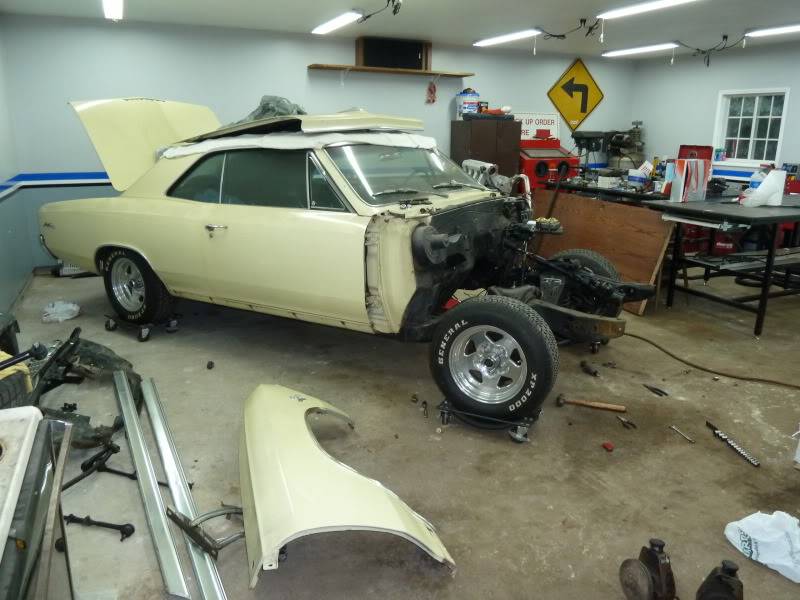

      Once I took enough time and $$ to finish the dettached garage, we brought the chevelle over to my place to start on the rebuild and get it back on the road.

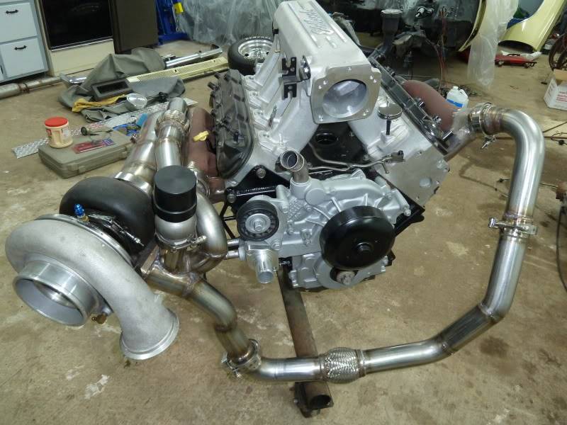

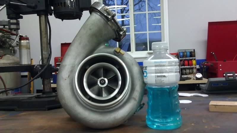

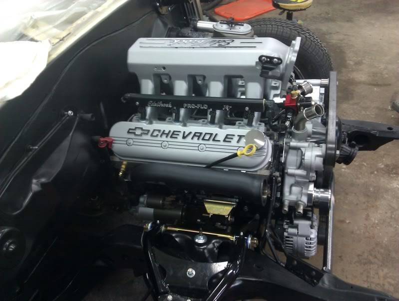

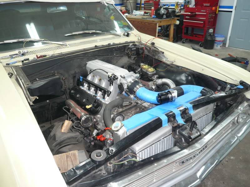

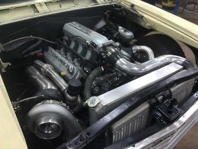

      We picked up a lq4 from a wrecked truck, added a used turbo cam from ls1tech, push rods, head studs, and LS9 head gaskets. We topped it off with a Edelbrock pro-flo due to it being a great looking intake and a very good price point. The turbo kit was built by me and was built around a used Gt4276 Turbo. The turbo is rated to 1250 HP with the compressor and exhaust housings.

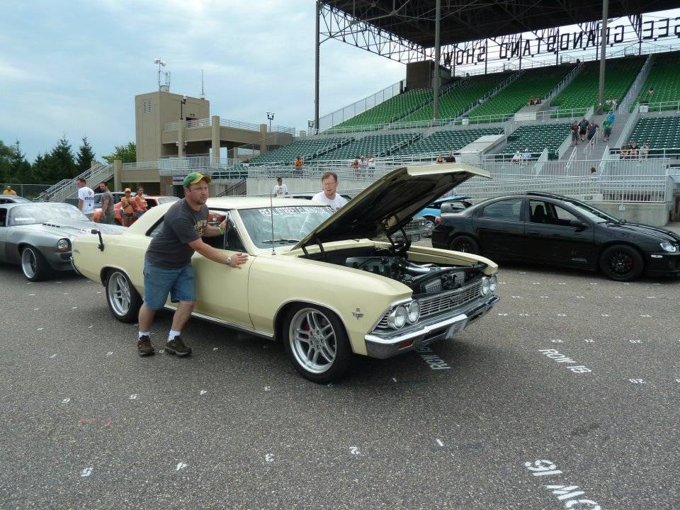

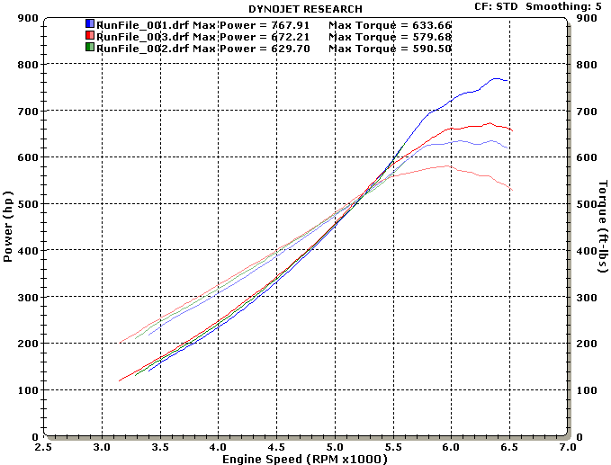

      The car puts down 767whp on about 16 psi, and is quite the handful on the street. We did Car-Crafts Real Street Eliminator this year and now want to work on getting into more autocross/road course type events. It is a great option to drag racing, and we had a lot of fun.

      Hanging in the shop
      In process Mock up
      Turbo Shot
      Engine Shot
      In the car for good

      Dyno Sheet
