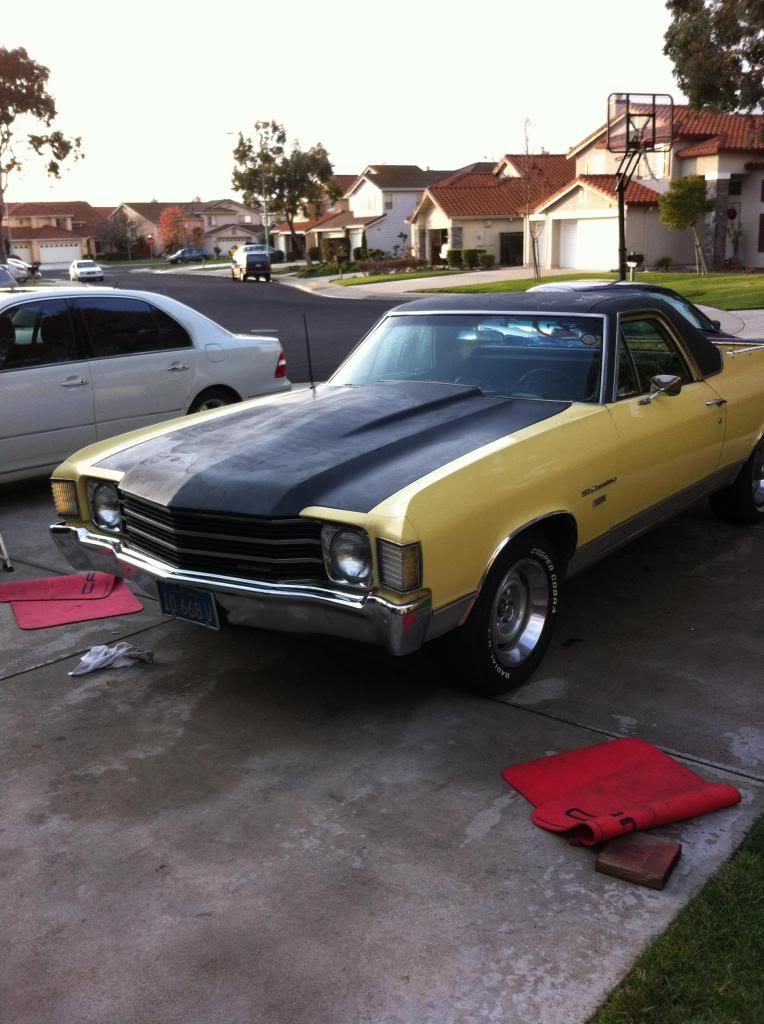

      Hey everyone! This is my 72 El Camino that my dad got as my first car last year for $2500. The car sat for almost 20 years by the time we got it and it didn't run. It had a tired original 350 and factory 4 speed. everything was original. Funny part is the only engine problem was the distributor was in the wrong firing order lol. The shifter was stuck and wouldn't move so we took it out and wire brushed it clean and it works great now. I drove it for a while with a clutch that slipped like crazy. Some of the valves had been knocking for a while and it finally gave up on the way to school. My plan is to upgrade it as I go. Still haven't found a name for the project. I'm open to suggestions! Also I'm only 17 and still new to the world of autocross and would really appreciate some guidance so I can really get into racing. Any advice as far as clubs for SCCA I can join and events going on I can compete in would be great. I really love autocross and road racing and would love to get more involved. I will post more pictures of what we've done but some will come slowly because we're not building it all at once.

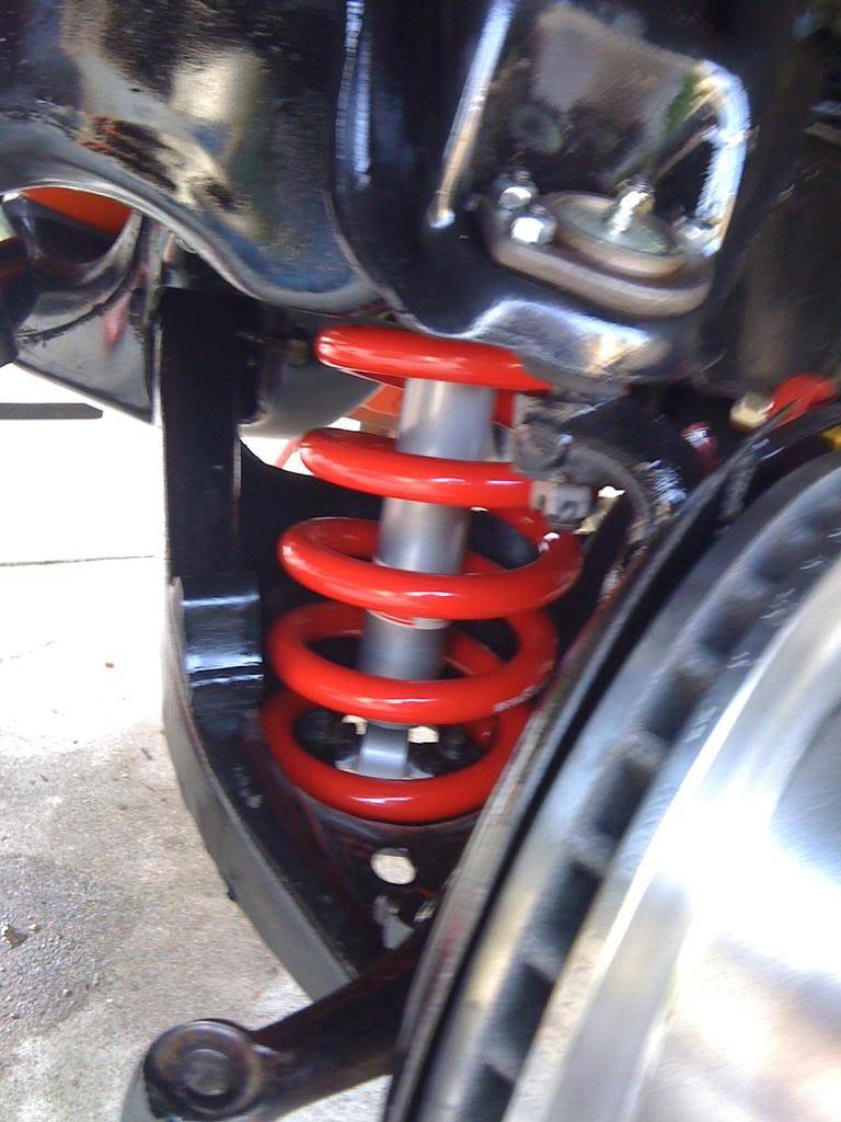

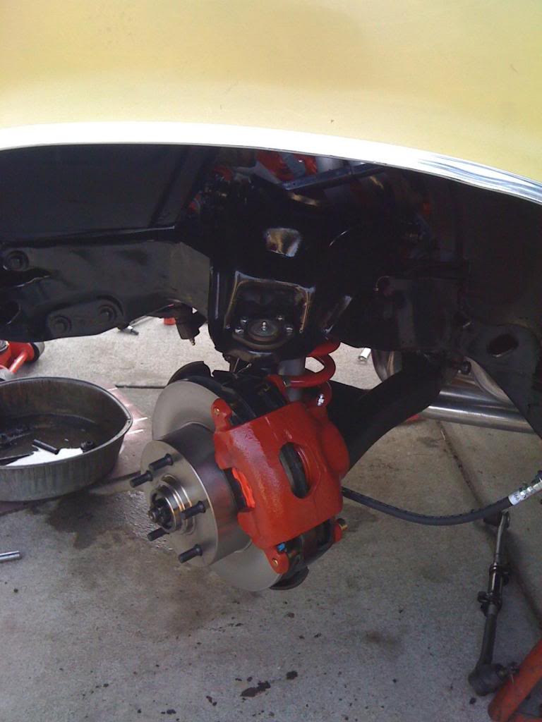

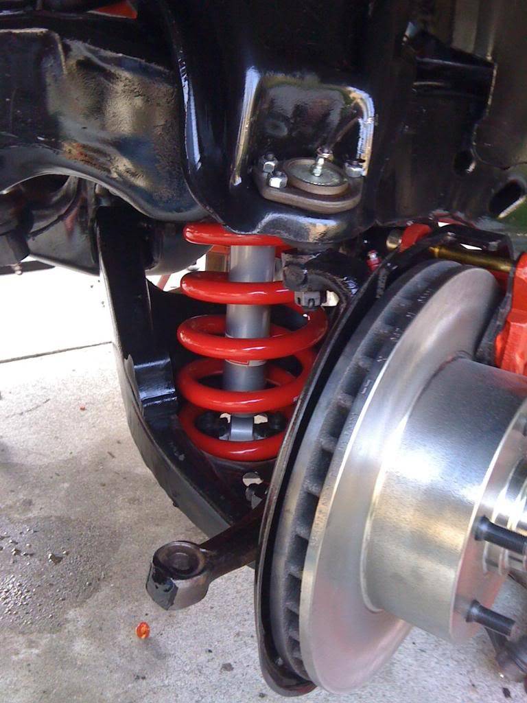

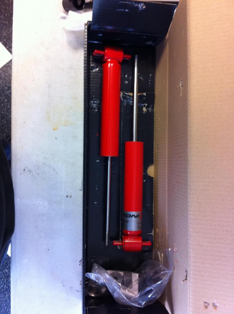

      Suspension:
      BMR 1" front lowering springs
      KYB shocks (front only)
      Everything else is stock suspension
      Supposed to get DSE front speed kit 1 and rear speed kit 2 tomorrow so that will be going on.

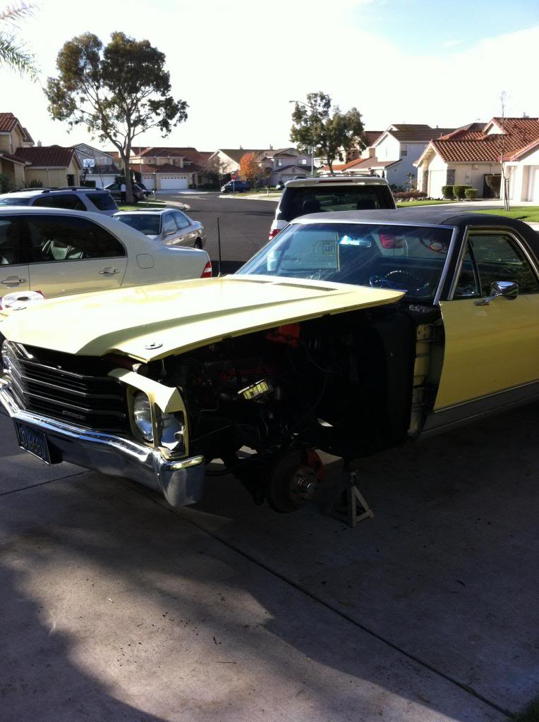

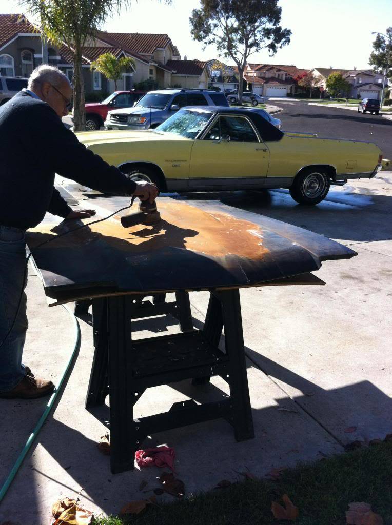

      Once it broke down we decided to pull it. I think it was orange once before lol.

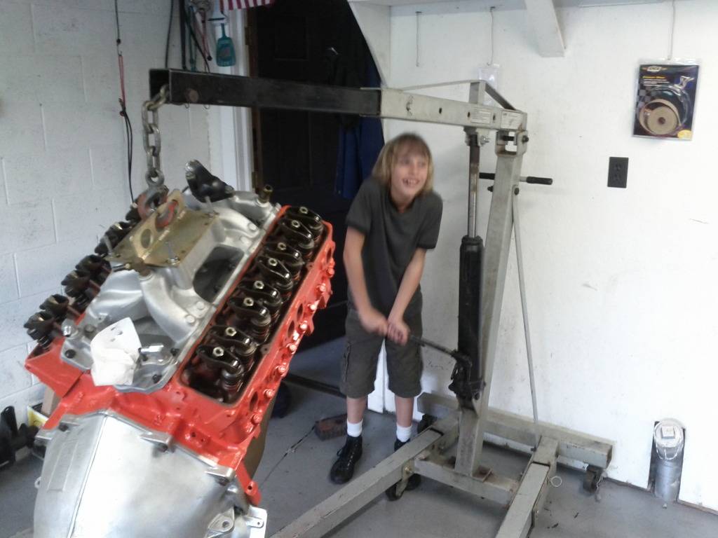

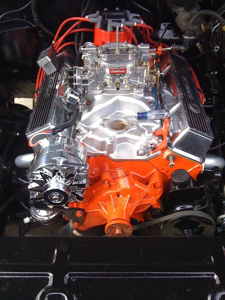

      Fresh motors are a thing of beauty.
      Edelbrock 2101 performer intake, form a junkyard.
      Mom even helped with putting the motor back in.
      For a couple seconds anyways.
      All hooked up and ready to go.
