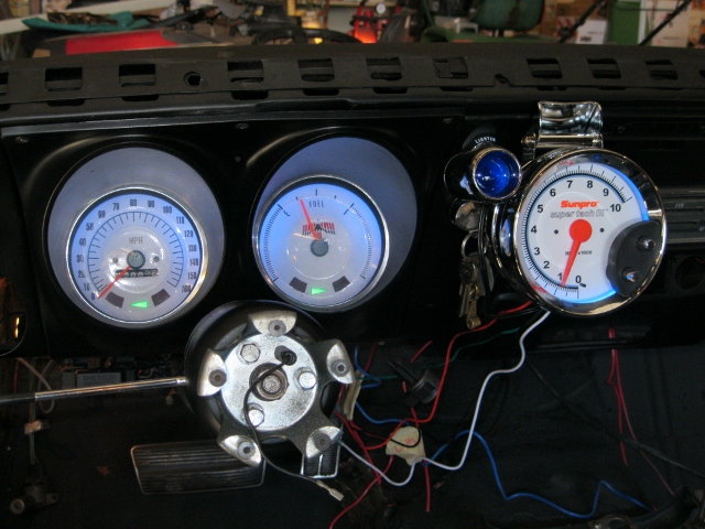

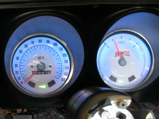

Size:  207.2 KBI have maybe $40 bucks in my entire set up, I did paint the metal back stop white and went w/ blue led dash lights and white face vinyl over lay from white face gauges .com I believe

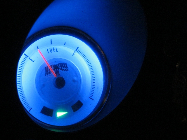

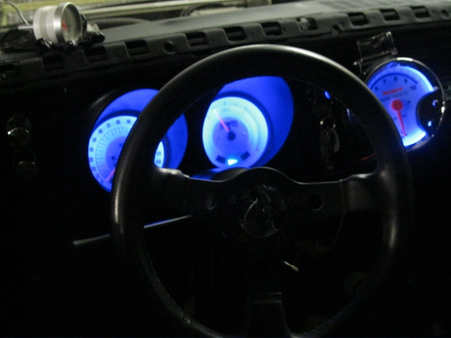

Size:  186.0 KBI sent you a PM but they are extremely bright and they are just 4 blue LED 194's as the picture I posted above was taken inside but in the day light w/ a garage door open, difference is top one has flash off and bottom has flash on but it is way more visible than it ever was with the factory bulbs and or black original gauges. Again for price and time I put into it I was more than happy at the end result. I am adding this with white 2.5 inch gauges w/ blue lights as well on A pillar to complete effect.
