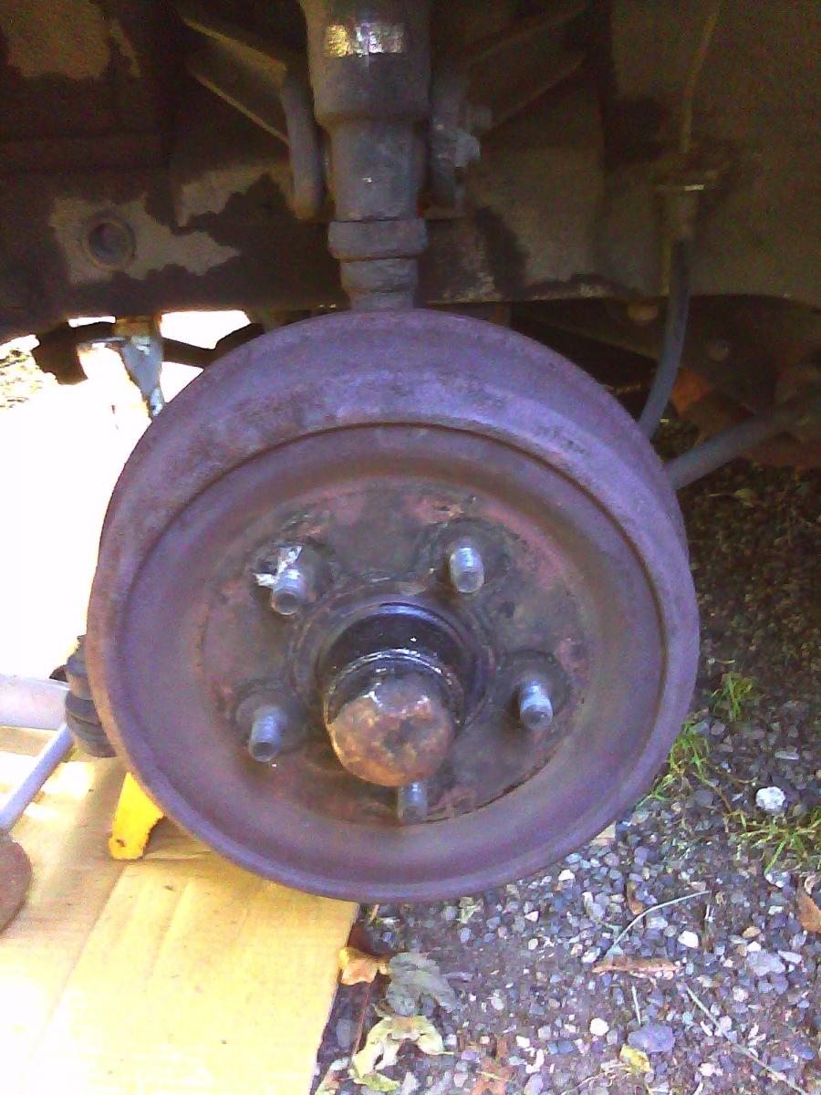

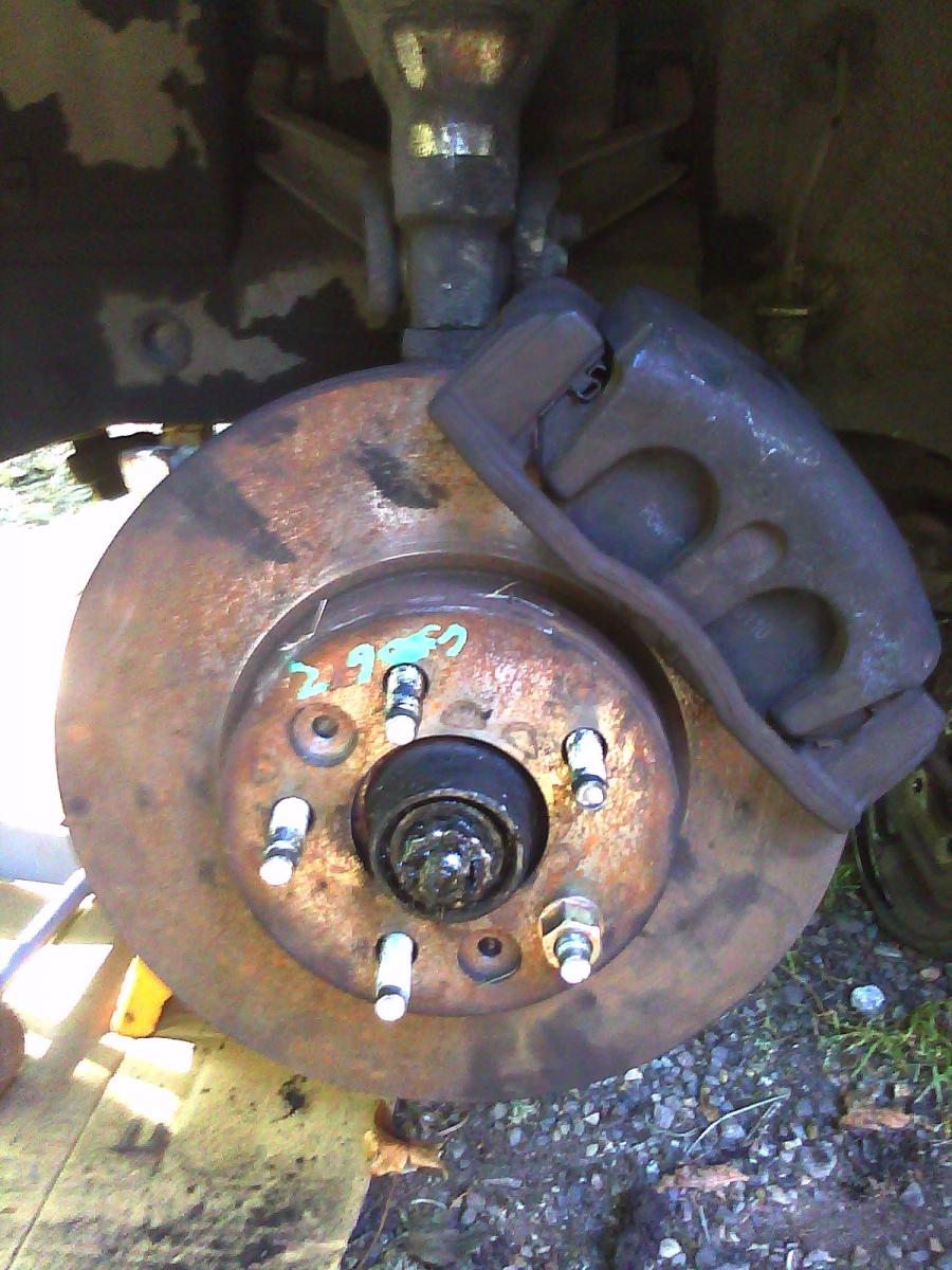

      Wrecking yard brake special installed. These are off a gently used '01 Crown Vic. Gotta love AMC's bolt on spindles.
      Name:  rotor installed.jpg
Size:  145.3 KBName:  bracket and hub.jpg
Size:  140.0 KBName:  bracket installed.jpg
Size:  155.1 KBName:  drum before.jpg

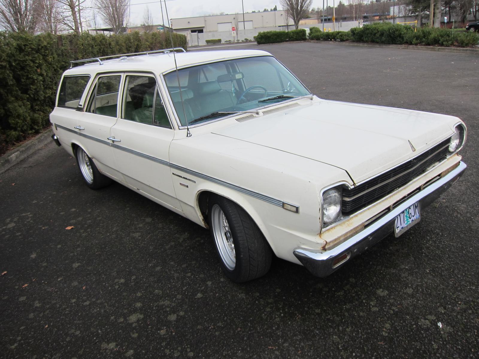

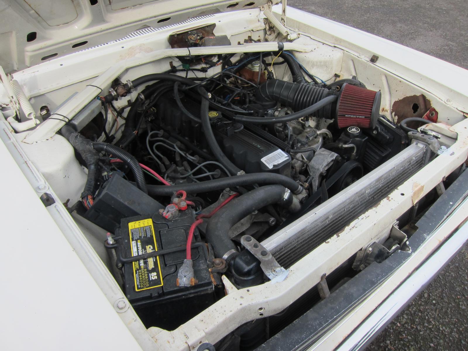

      Cleaned it up:
Size:  327.3 KBName:  IMG_1135.jpg
Size:  235.1 KBName:  IMG_1112.jpg
Size:  272.4 KBName:  IMG_1116.jpg

      That long roof is sweet. The 4.0L is stupid tough with 300k not a problem on a GC or XJ. What was your mileage on that recent trip.
      Thanks
