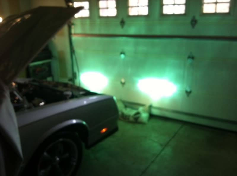

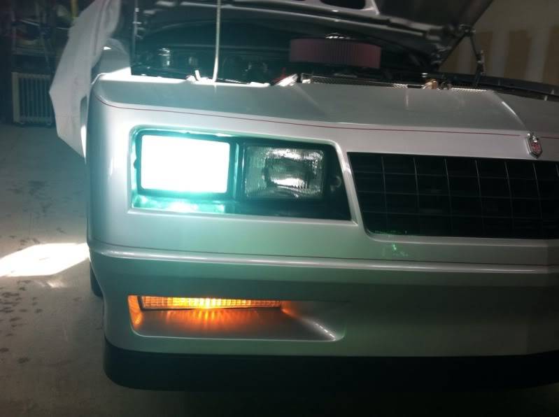

      Hey everyone i did the h4 conversion with 35watt hid kit 6k

      Do you the projectors on your Monte?
      Jul 2012
      Traverse City, MI
      574
      Definitely no projectors. Do you have space behind your light buckets for a retrofit?
      I have a special place reserved in my heart for guys with HIDs and no projectors.

      68
      Lights are pointed more towards the ground not blinding anyone plus the car is lowered. Thanks

      from your lighting pic looks like you have hot spots/beam scatter
      should of did a more distant lighting pic to show how bad or good the light cutoff and or hotspot/beam scatter is

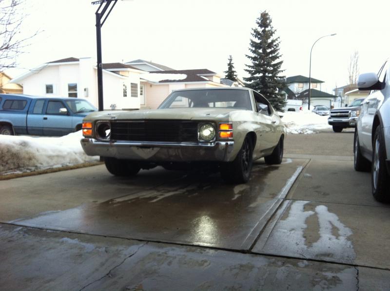

      Like said above. Please be respectful and remove them. I ran traditional bulbs until I wanted HID's. Heres a pic...
