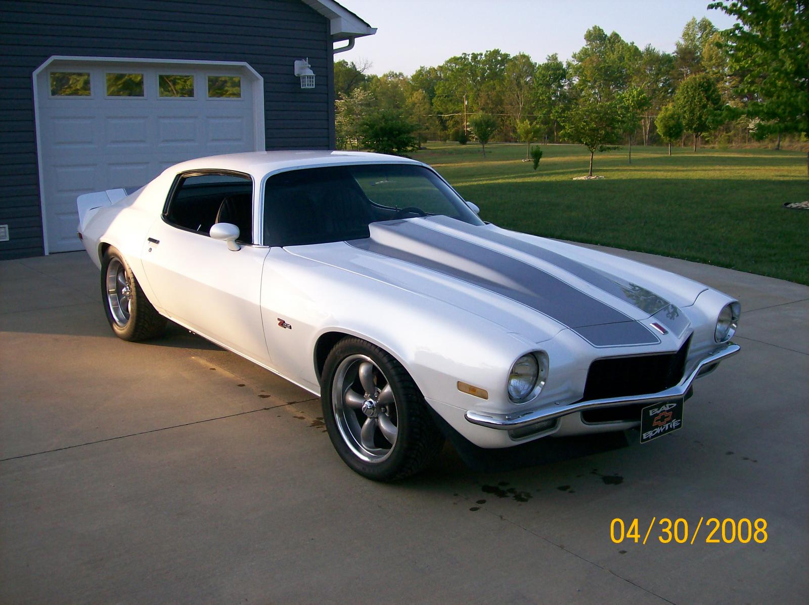

      i used the toyota white diamond on my old camaro . i changed the formula a bit though on the base i used staight white off the mixing station leaving out the yellow.on the mid coat added silver pearl Name:  my camaro 002.jpg

      Not to hijack but that looks kickass! That is close to the look I want for the van. What color are the stripes? I am planning to use either a steel or titanium pearl to get that two-tone look.

      NICE, that is the color combo i want for my 68 camaro just need to decide if i want to do the z/28 stripes or just the nose stripe.

      stripe is a home brew of silvers and black . painted car before the wheels then went back and matched the stripes to the wheels
