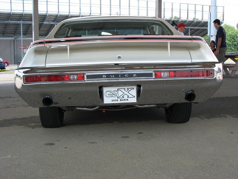

      Also, notice the differences of the rear spoilers; the Prototype GSX has a 3 piece rear spoiler (end pieces are molded into 1/4 panel extensions, and center spoiler lifts with trunk lid):
      Name:  Prototype GSX rear spoiler.jpg
      Production GSX spoiler is only 1 piece:
      Is there anyone who could duplicate these (Prototype GSX style) front & rear spoilers for my project (at cost for materials & labor, of course), or does anyone have suggestions/advice for best materials to use, to fabricate these pieces, myself?
      My original idea is to use a reproduction GSX spoiler, install it on one of my extra (Skylark) cars, then use a (filler/bonding material?) to attach the sides & mold/shape into the 1/4 panel extensions. Once the sides are solid to the 1/4 panels, cut the center section aligned with the sides of the trunk lid edges. Close/fill the open edges of the cut spoilers ends, for the 3 piece spoiler end result.

      My business partner I'm working with on my custom carbon fiber/ fiberglass rear spoiler and other misc parts is interested. However we would need to locate a car to work with for test fitting no luck doing that yet.

      I think a 70 Chevelle could be used for the rear spoiler. Might be easier to find than a skylark.

      yes any A-body spoiler would wro. and you can by a repro gsx poiler so..just as easy to get a buick spoiler..
