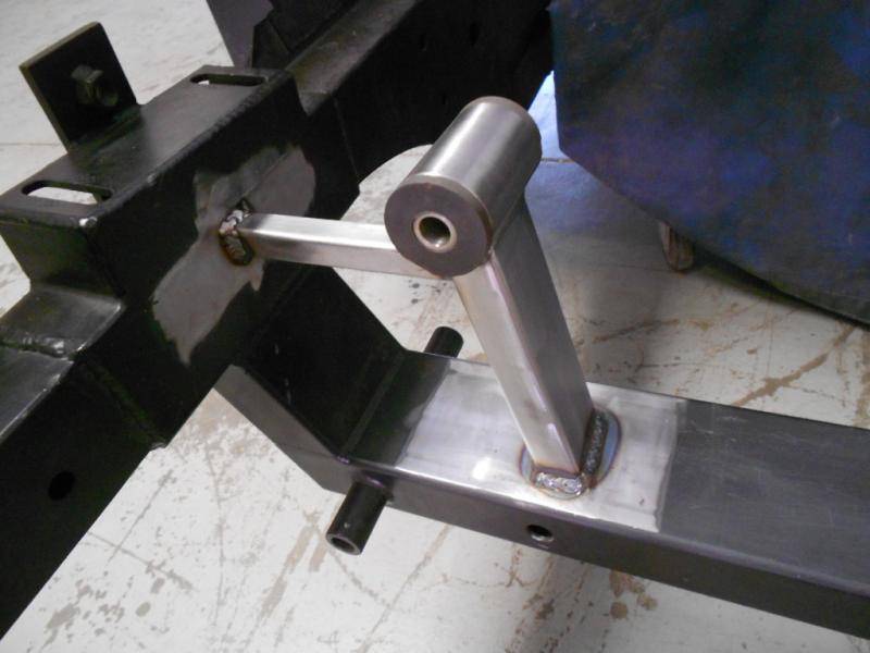

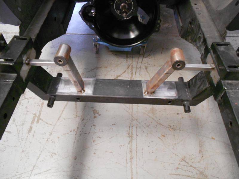

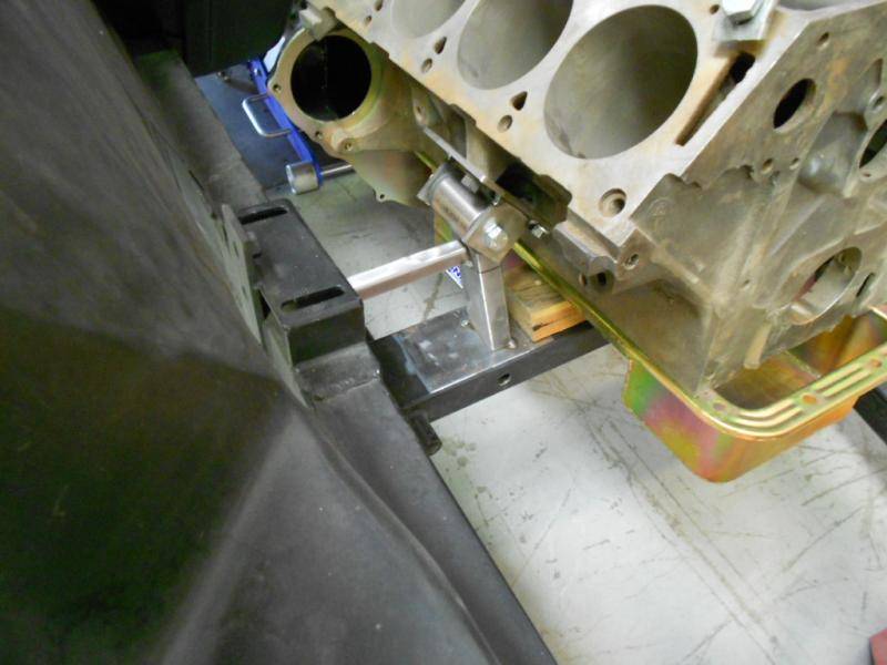

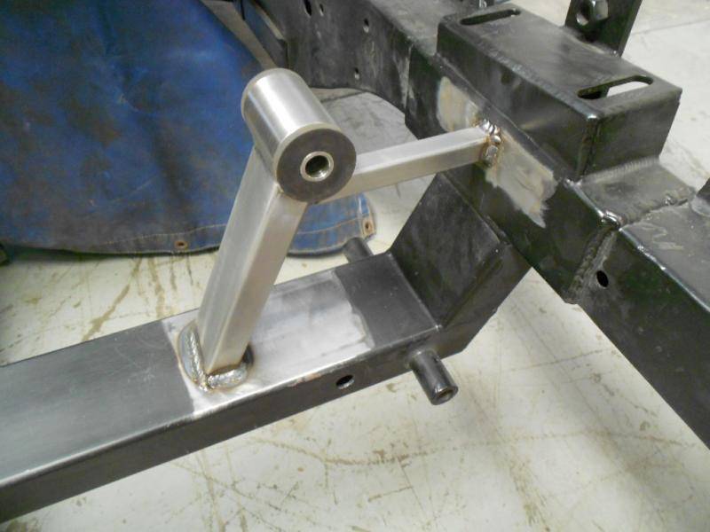

      Brian welded the motor mounts in place. Now when you order a kit from Rod & Custom the motor mounts are already welded.

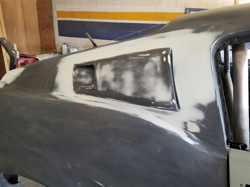

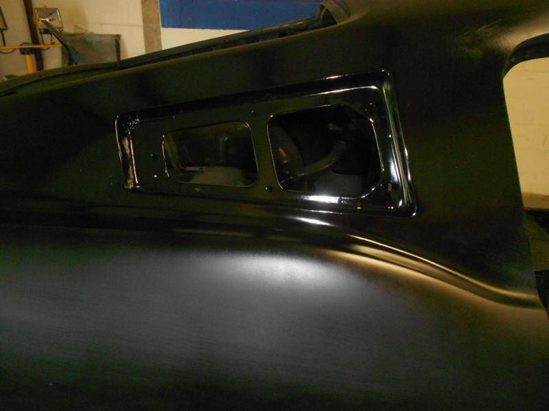

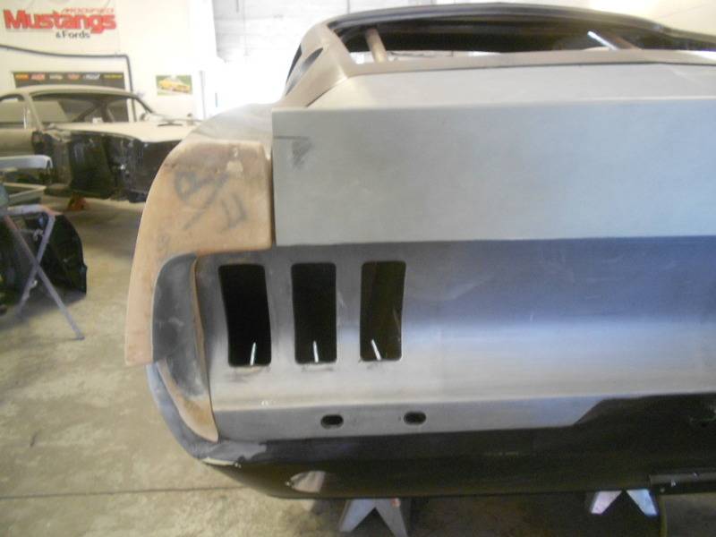

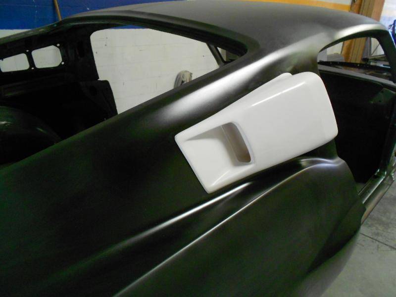

      The new owner did not like the Eleanor non functional quarter scoops so we cut them off and installed Shelby scoops.

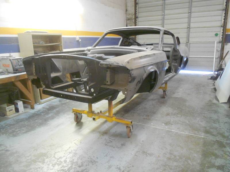

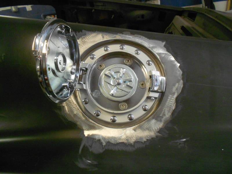

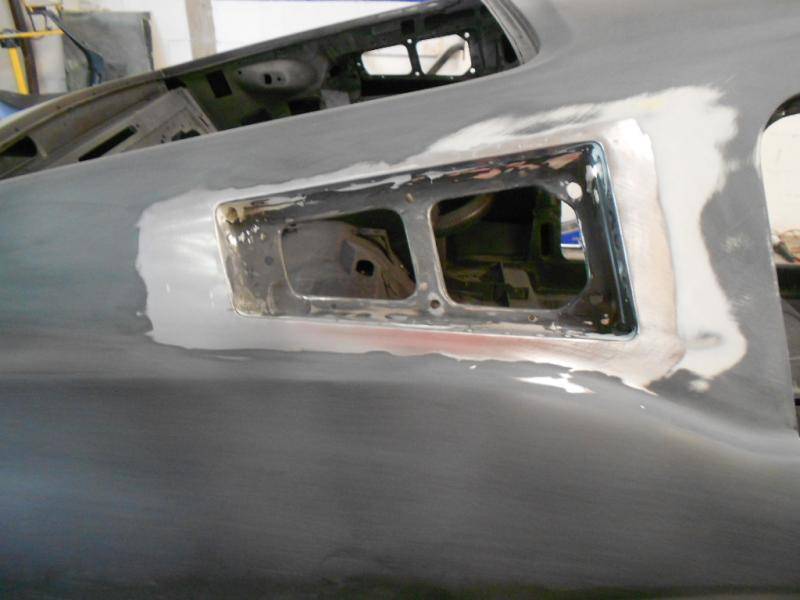

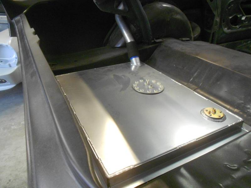

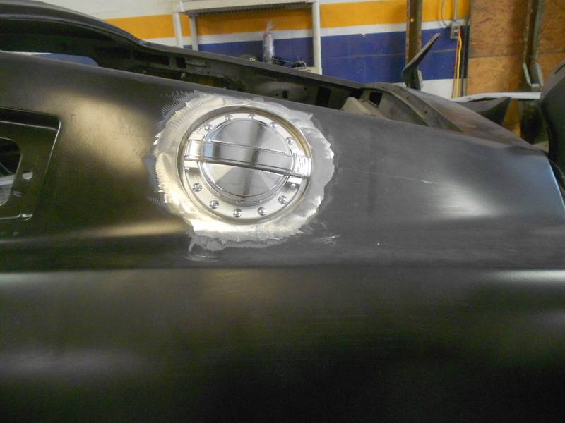

      This project was on hold for a few years and the owner has decided on a few changes. I'm sorry to say he has decided not to go with the SOHC but is going with an aluminum FE just not sure how big it will be yet. We will also be doing a few modifications to the body.
      It is out of storage and back in the fab shop.
      The first thing Brian did was finish lining up the sheetmetal

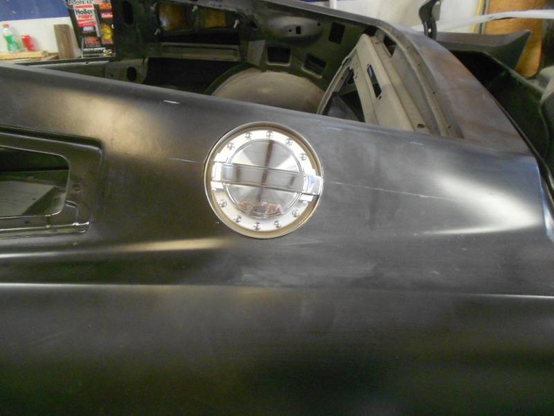

      Starting to install the Mustang to Fear gas filler kit.
      Welded in place and the welds ground

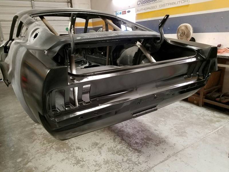

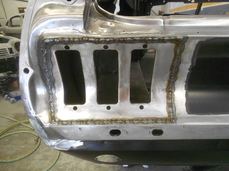

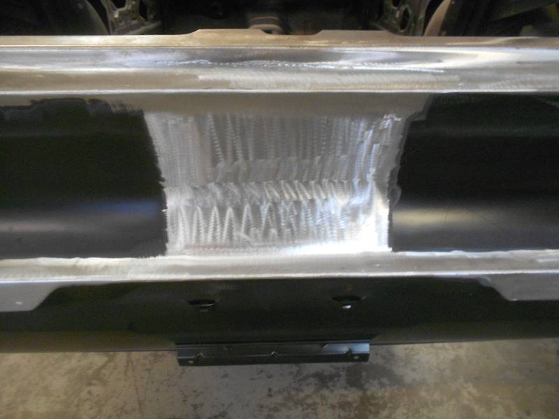

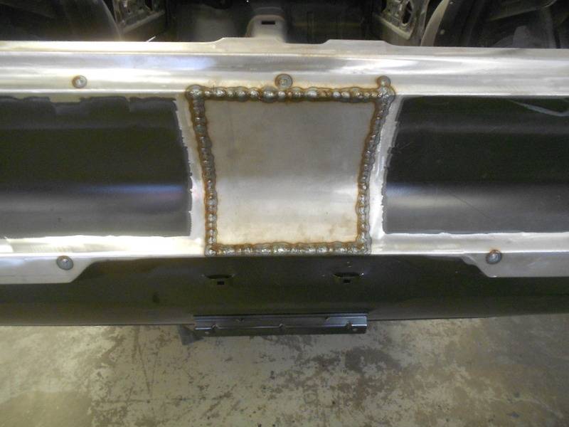

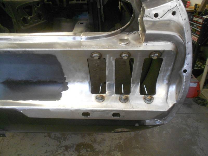

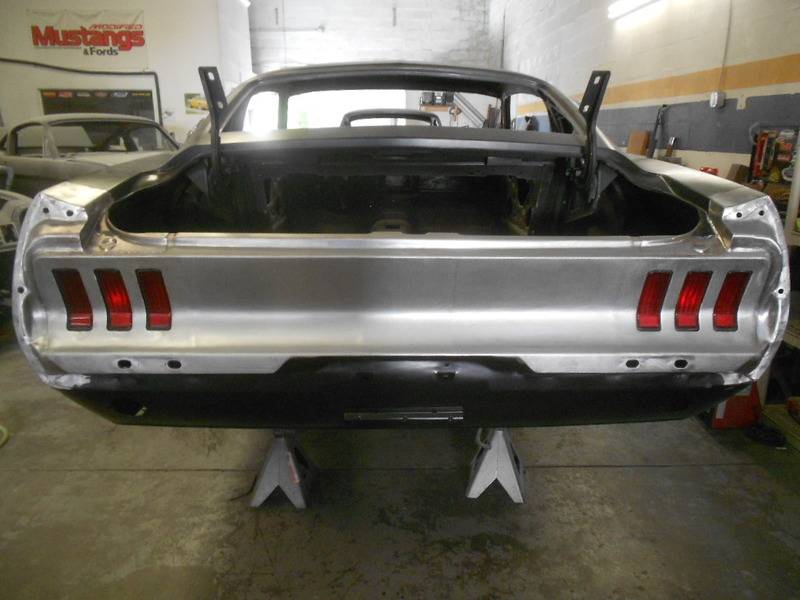

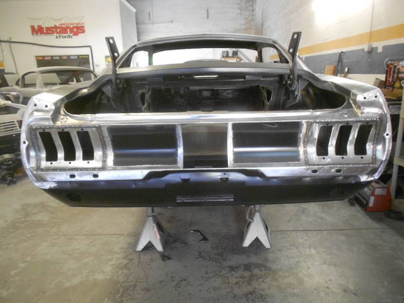

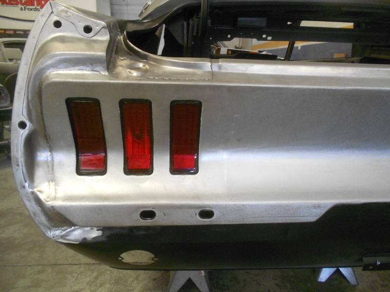

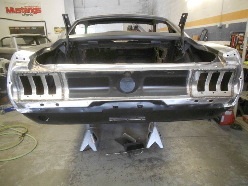

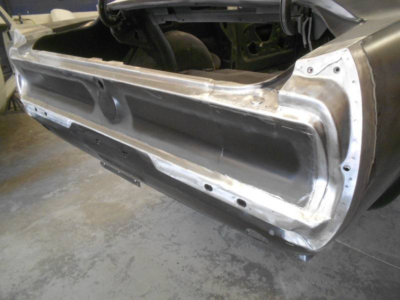

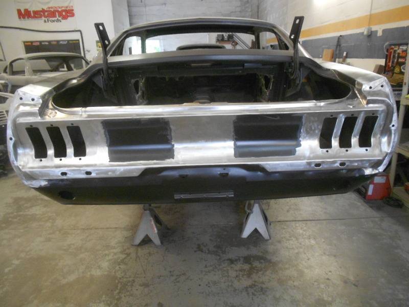

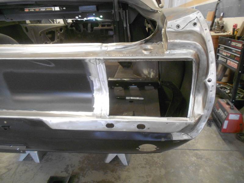

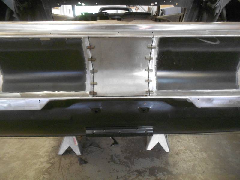

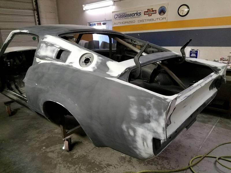

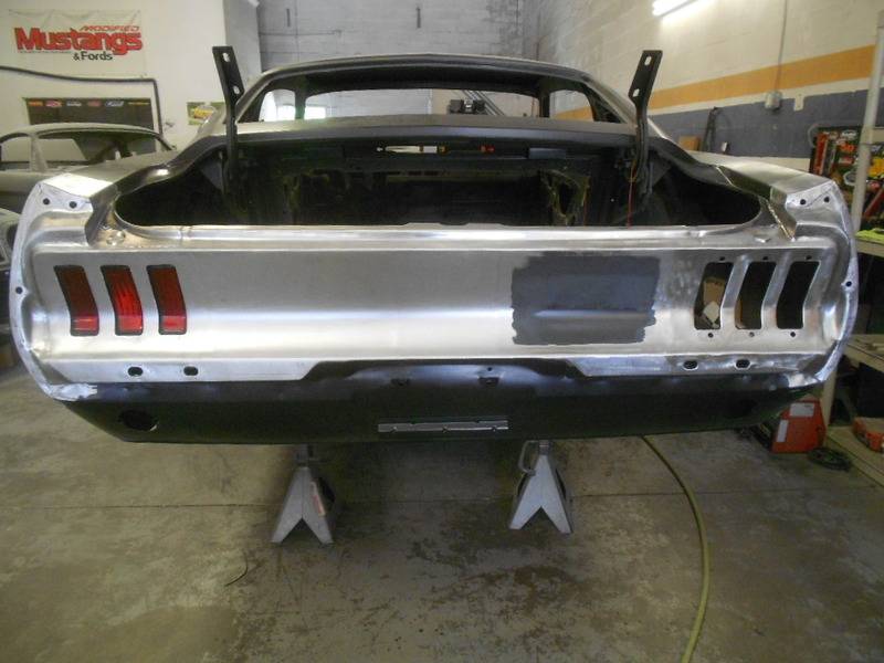

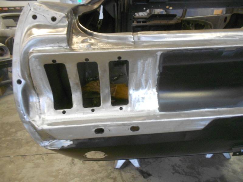

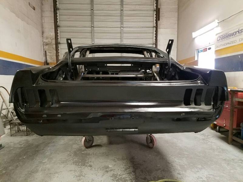

      The owner decided he didn't what the Shelby/Eleanor taillight panel that was installed before he bought the car. Brian had the fun job of cutting off the fiberglass taillight panel and end caps.
      We bought another taillight panel to cut out the stock taillights.
      After a lot of measuring and Brian standing back looking at them to make sure they were straight he welded them in place.
      Since we have a side gas filler we decided to do away with the original one.
      Brian cut out a section of the new taillight panel and welded it in place.
      After a little grinding
      Stay tuned for more modifications to the rear in the future.

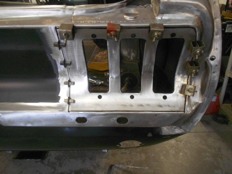

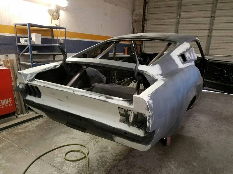

      Brian finished grinding the right side.
      Carriage bolts were welded to the taillight panel and ground down to hold the taillights
      He still has to finish the right side. He bolted it together and tack welded the carriage bolts removed the taillights and finished welding both sides. This is how they look before he grinds them down and weld them one more time before the final grinding.

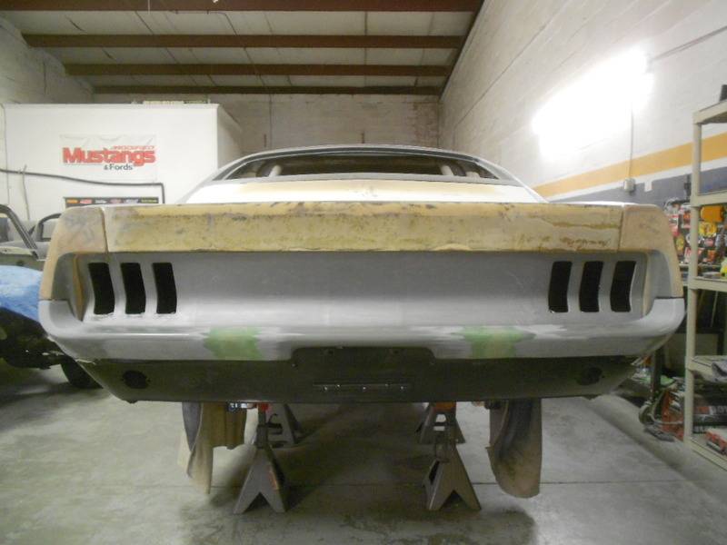

      Brian finished welding and grinding on the taillight panel

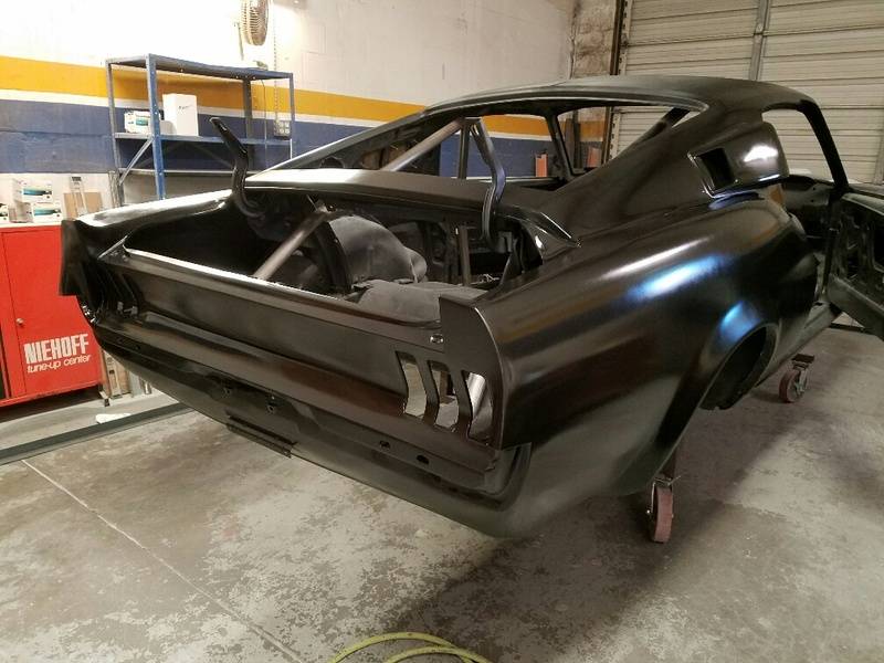

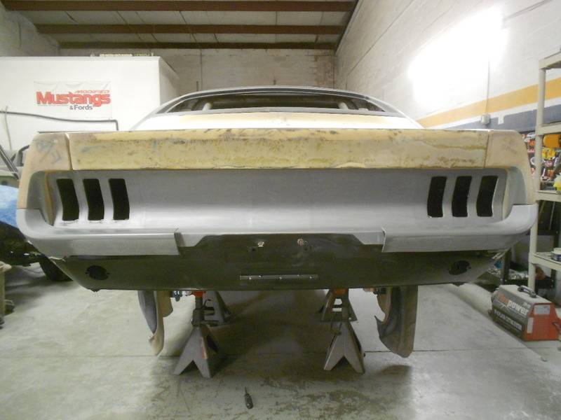

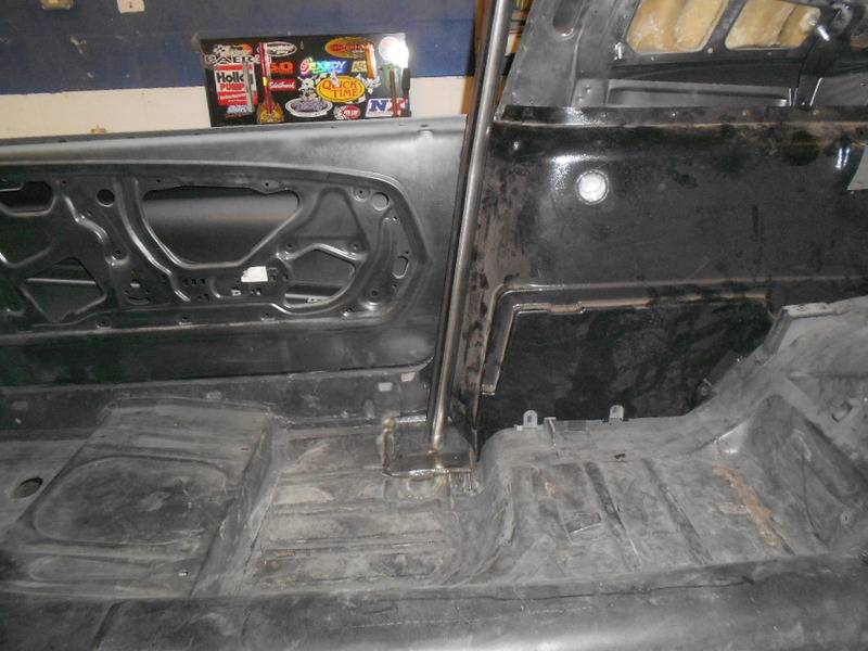

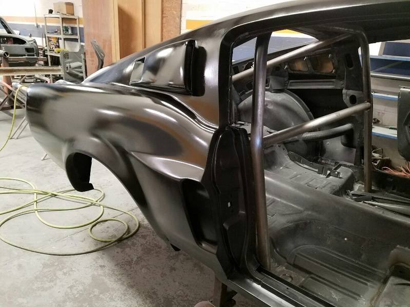

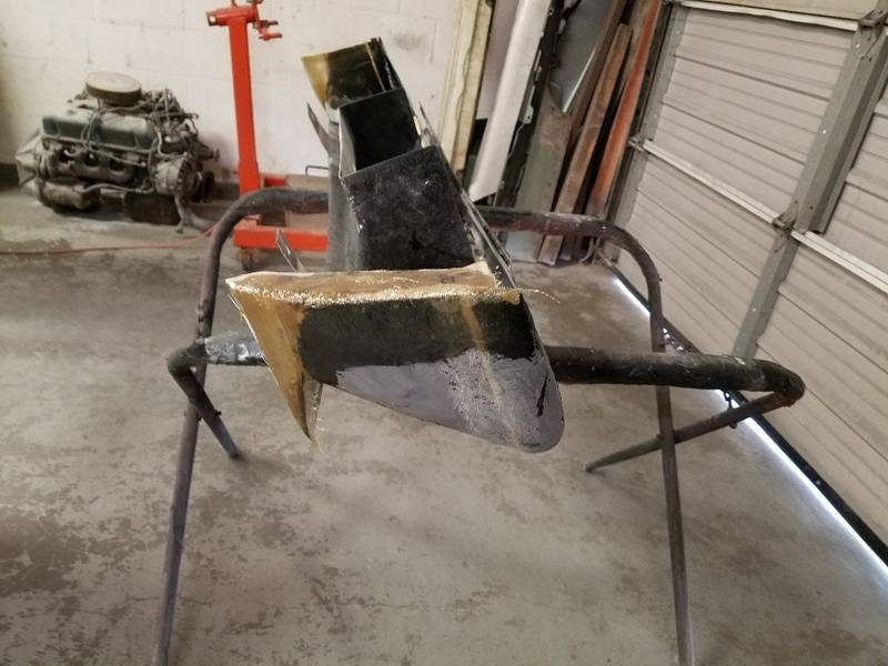

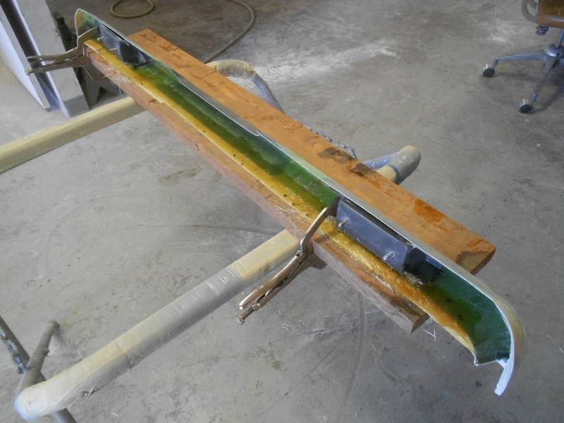

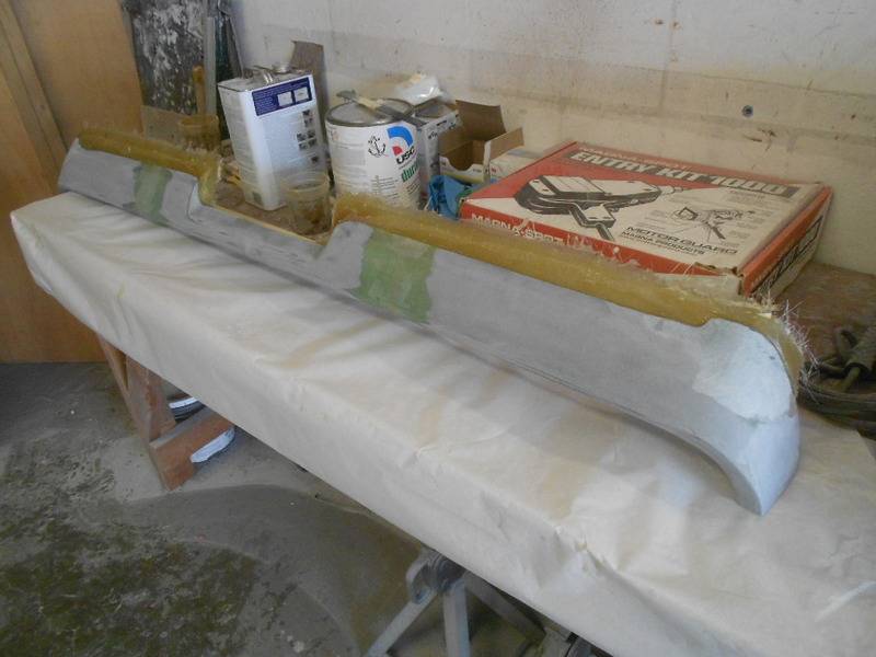

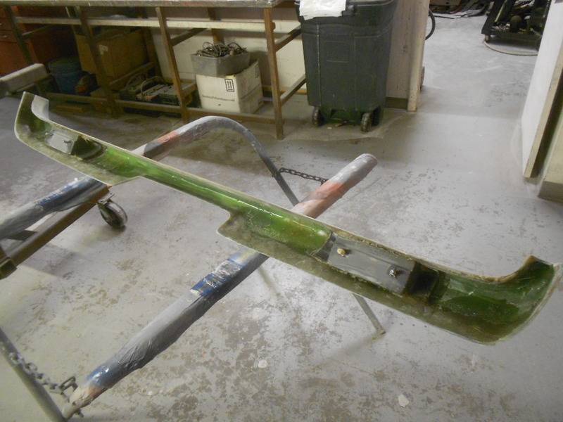

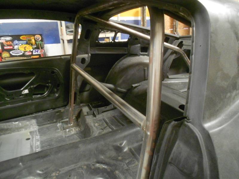

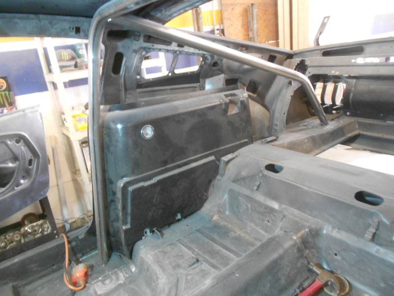

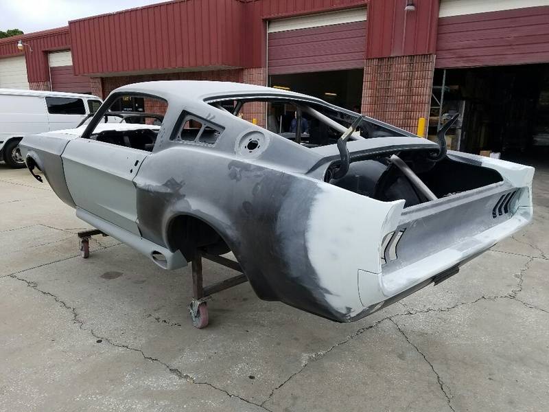

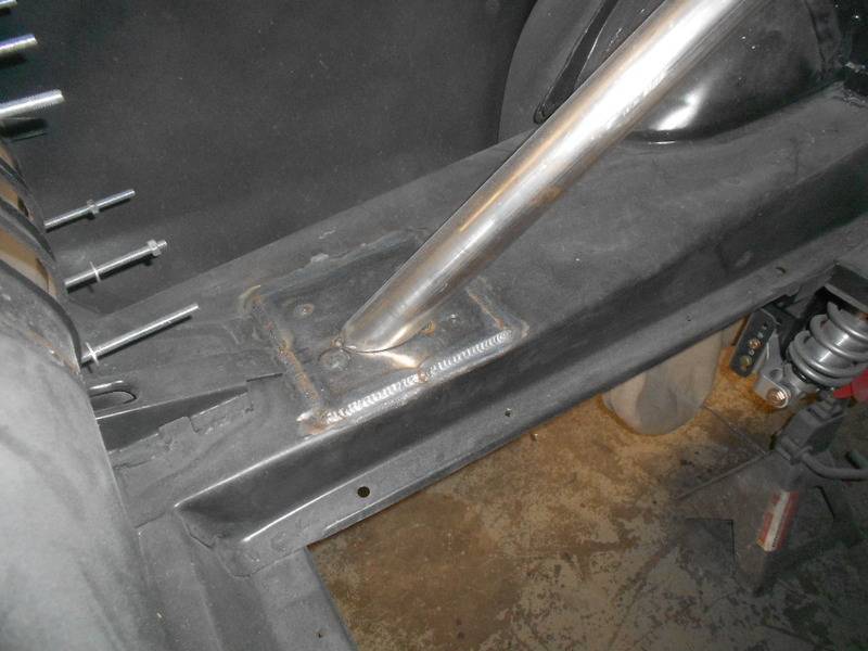

      We decided to install a roll bar and I bought a kit from S & W for a 1968 Mustang

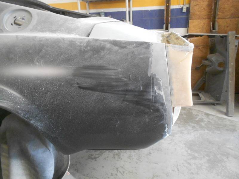

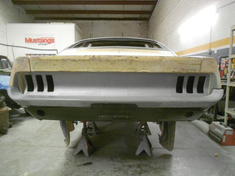

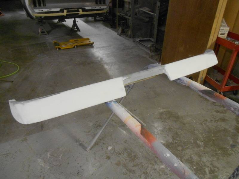

      We wanted to do something different so we cut about 1" off the end caps and spoiler.

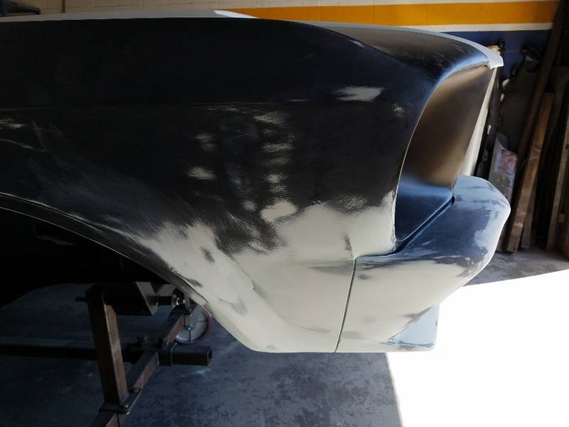

      As you can see in this photo the bumper needs to be narrowed

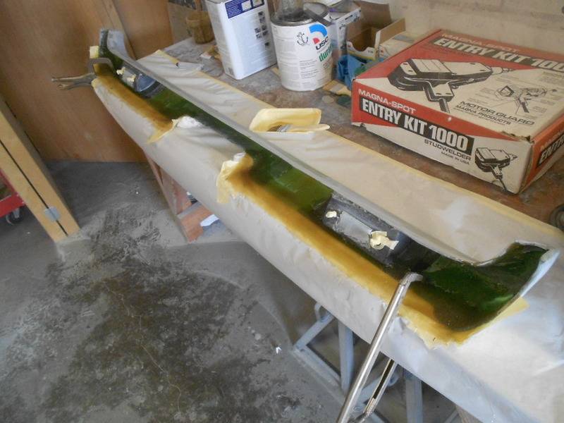

      I cut the center out of the bumper and lined up both ends with the end caps.
      I will have to add fiberglass to get a tight gap
      Bumper fits better now but still needs a lot of work to look right
      The gap was larger in the middle so I added fiberglass
      We also added fiberglass to the bottom of the bumper

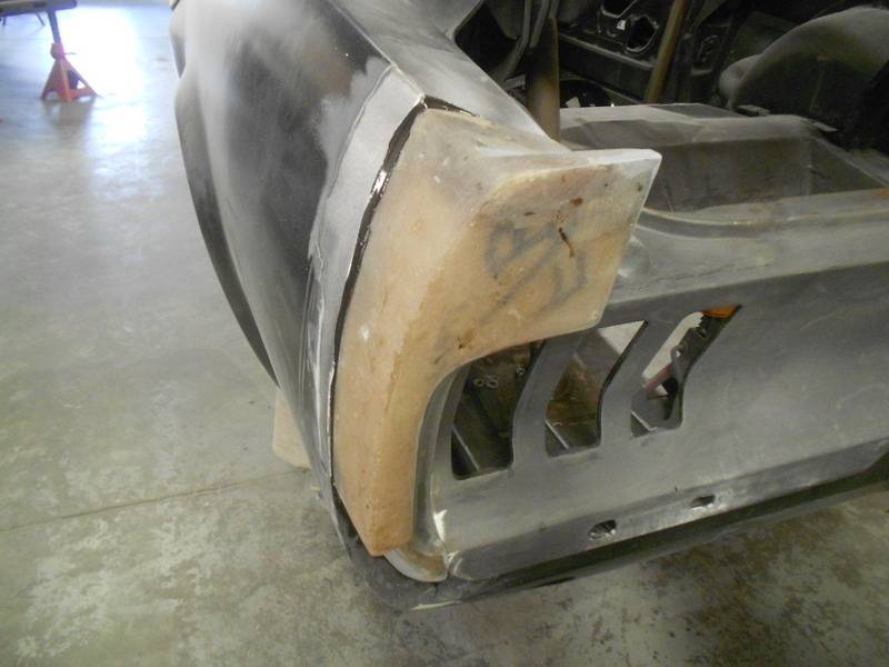

      The end caps were bolted and bonded to the quarter panel
      I also added a little fiberglass
      Bodywork ruffed in
      We now have a nice tight gap around the rear bumper
      Epoxy primed
      Next step is to finish the bodywork on the taillight panel and rear valance

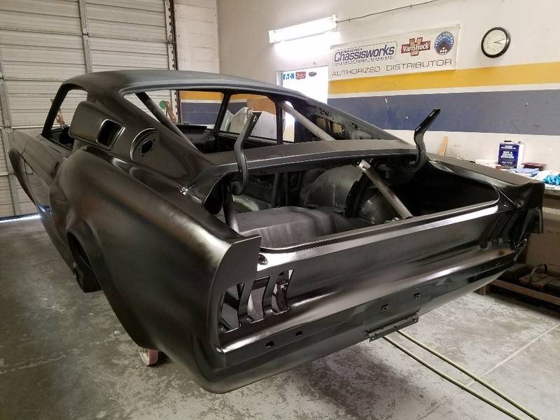

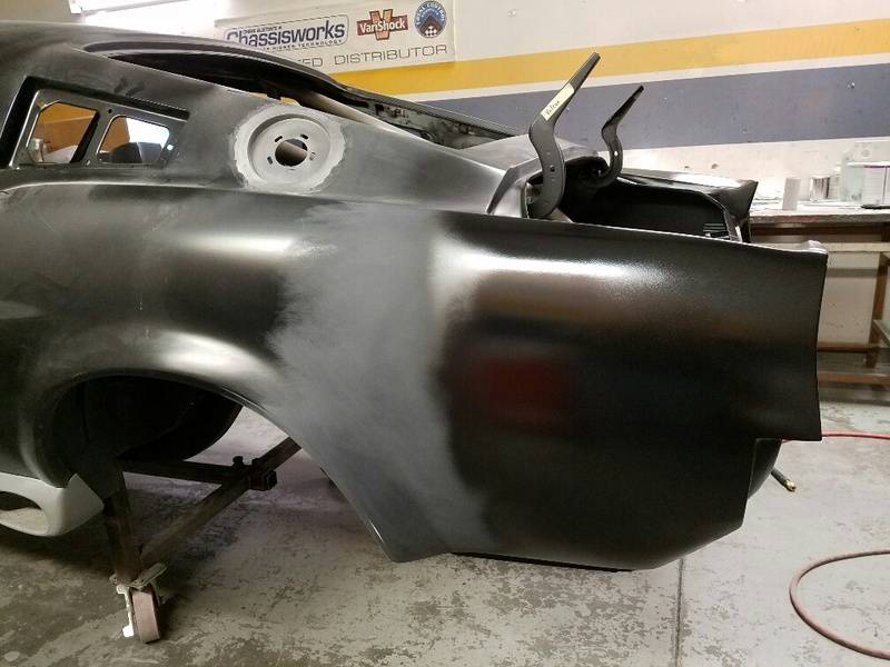

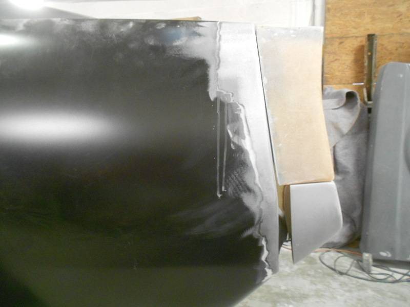

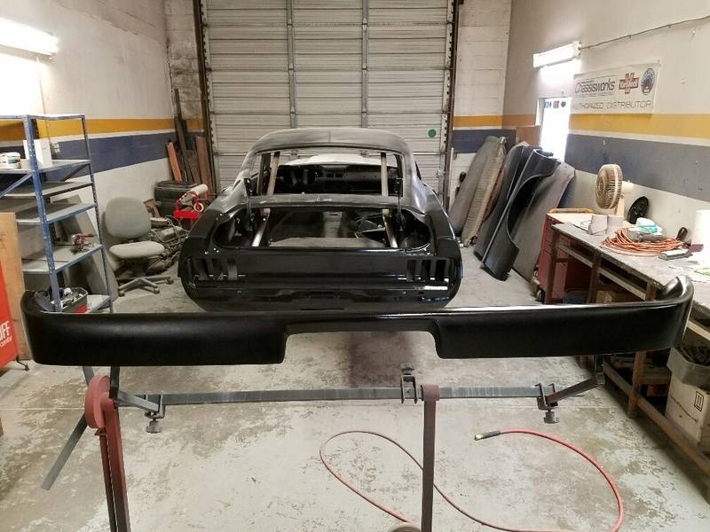

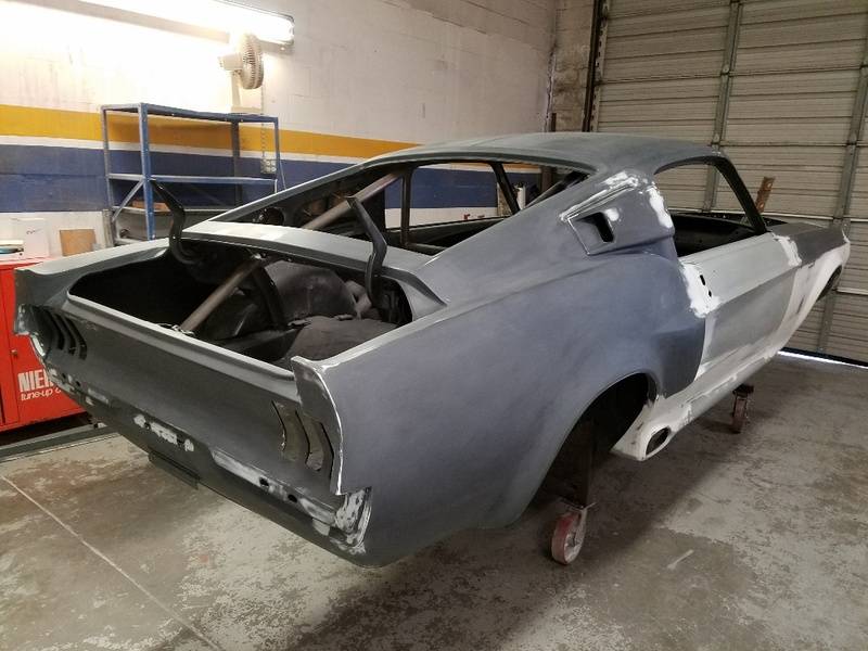

      Quarter scoops were bolted and bonded with 3m8115 panel adhesive.
      Major bodywork finished on the rear of the body yesterday
      Today I sprayed two coats of SPI epoxy primer

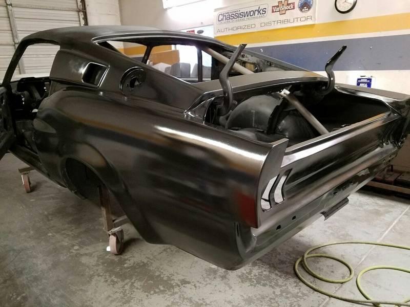

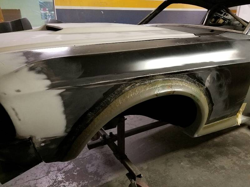

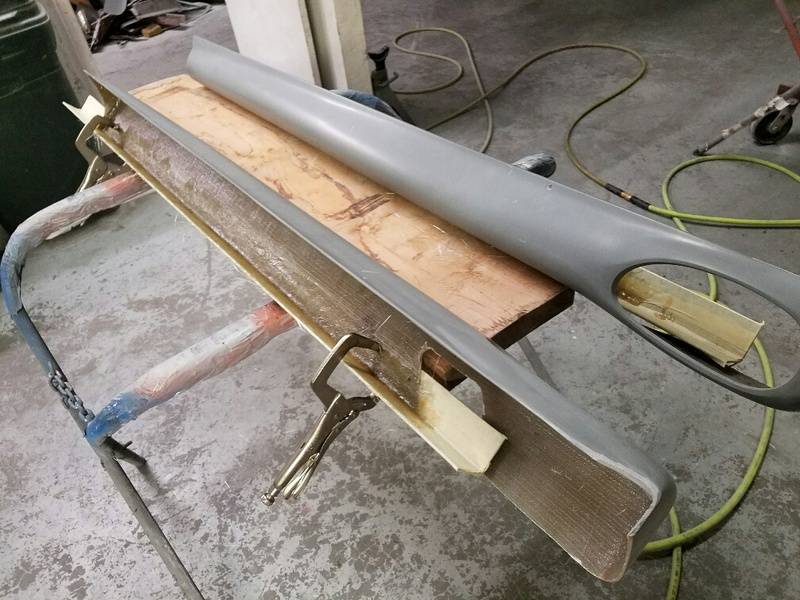

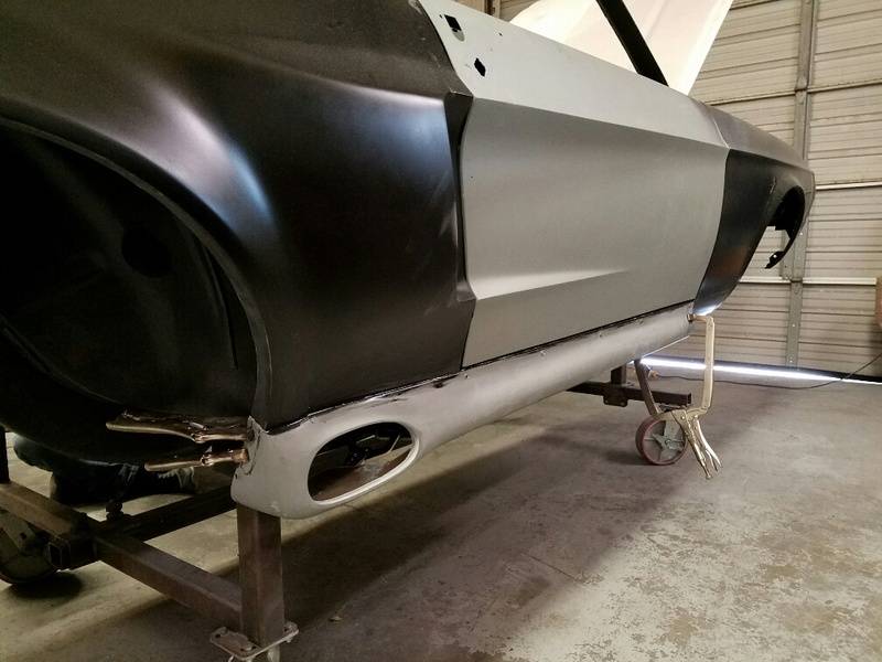

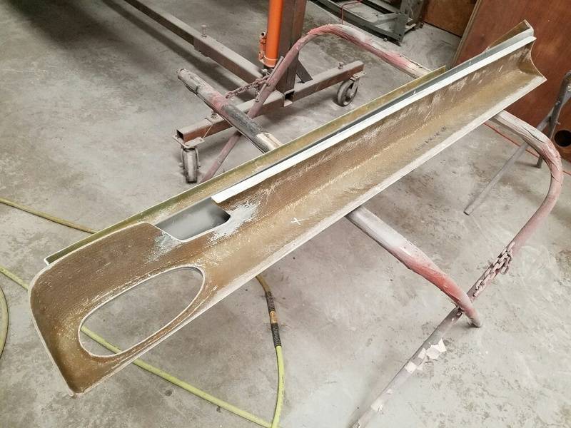

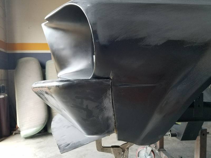

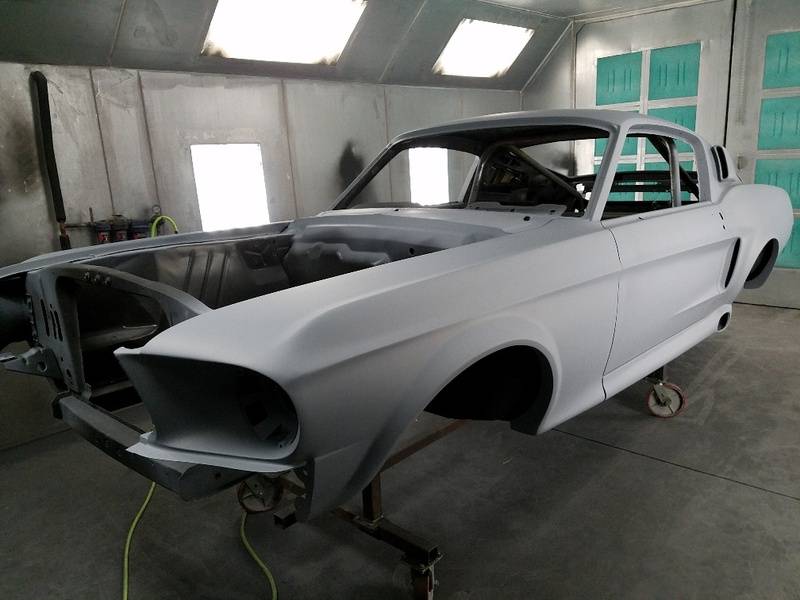

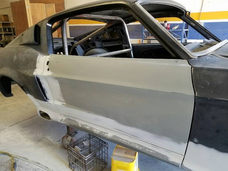

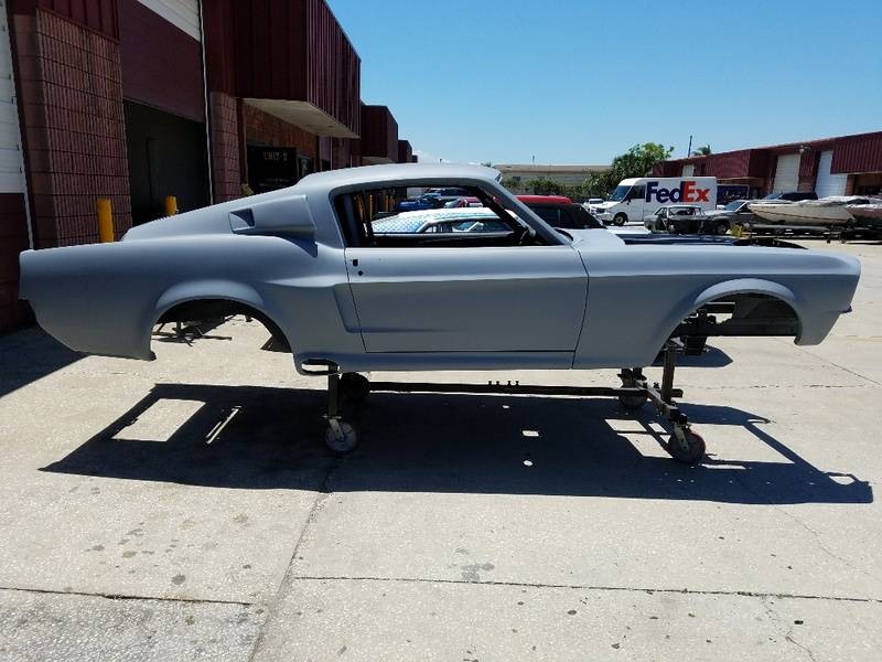

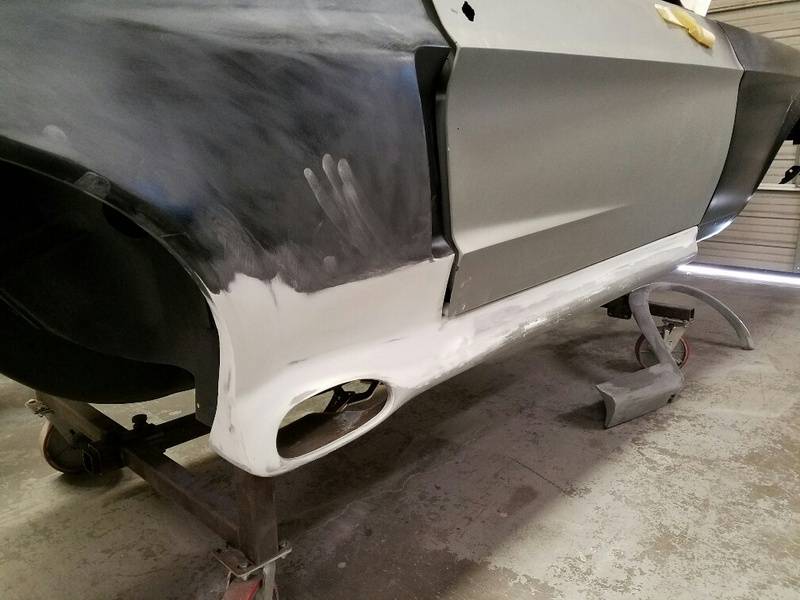

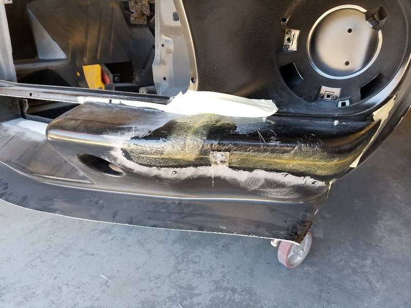

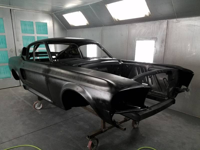

      We had to add fiberglass to the side exhaust skirts to give us something to bond to the pinch weld.
      Bonded to the rockers
      Started the bodywork

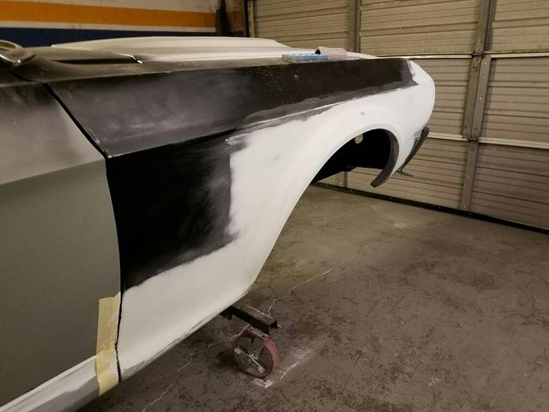

      Headlight bucket was bolted, bonded and fiberglassed to the fender
      Front fender flares installed
      Bodywork getting everything to line up
      Ready for a couple coats of SPI epoxy primer

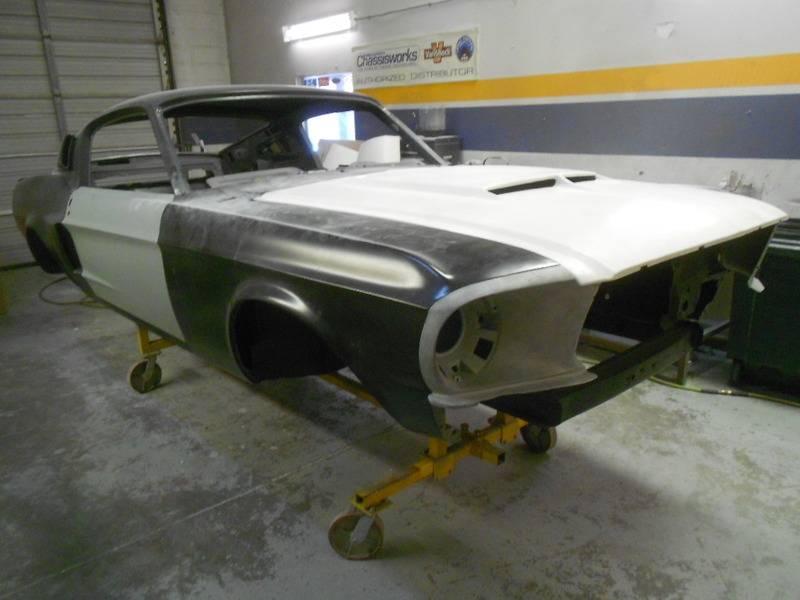

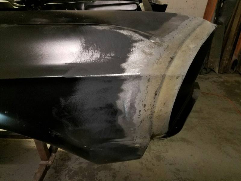

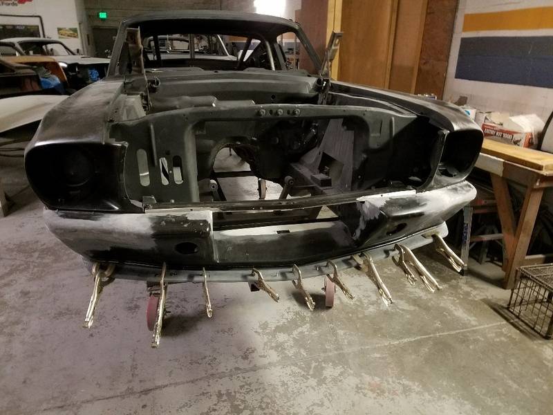

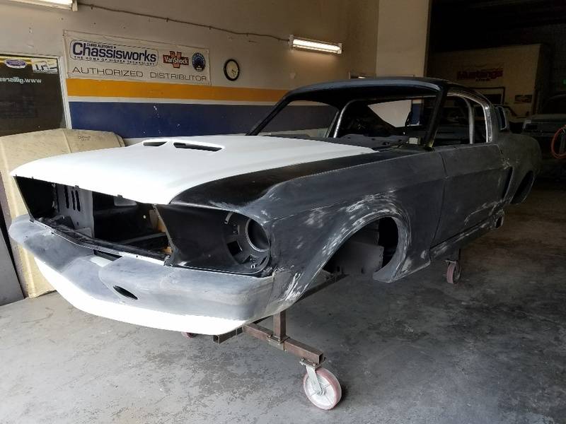

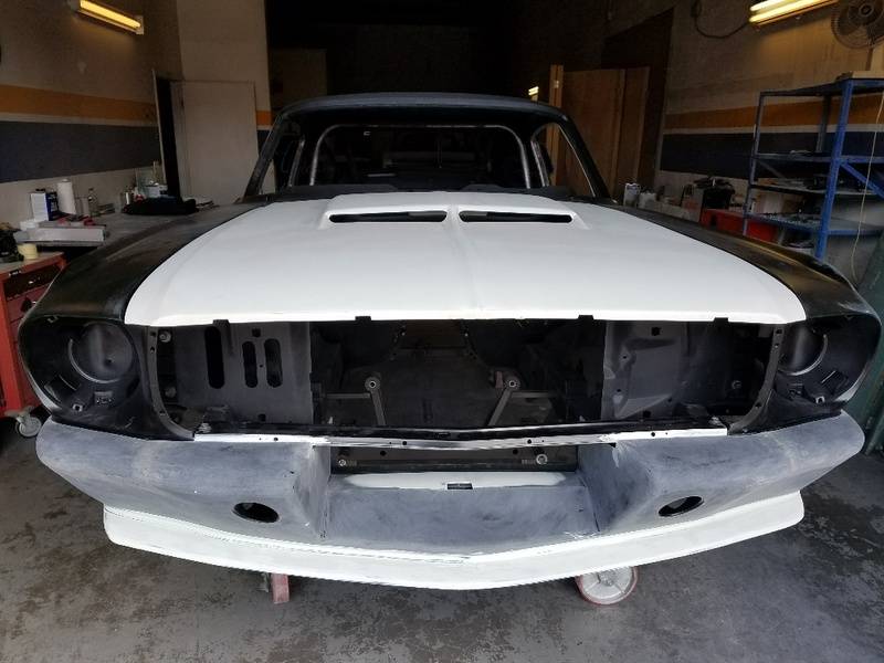

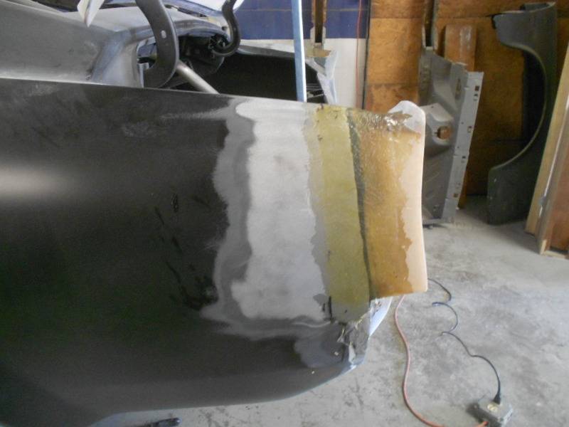

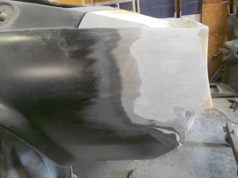

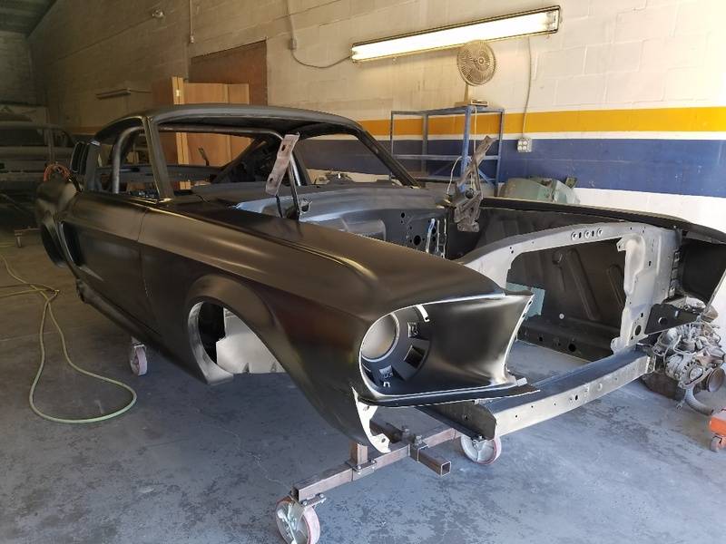

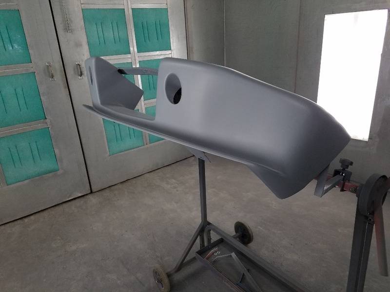

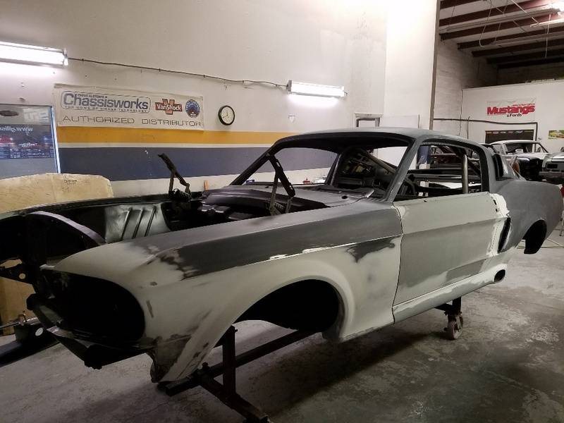

      Starting to fit the front apron
      The shape was wrong under the headlight buckets so we cut it apart and glassed it back together
      The spoiler was cut down and the front lip bonded back on.
      After sanding

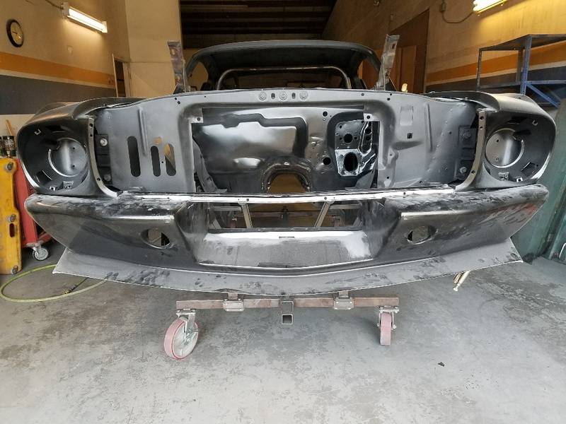

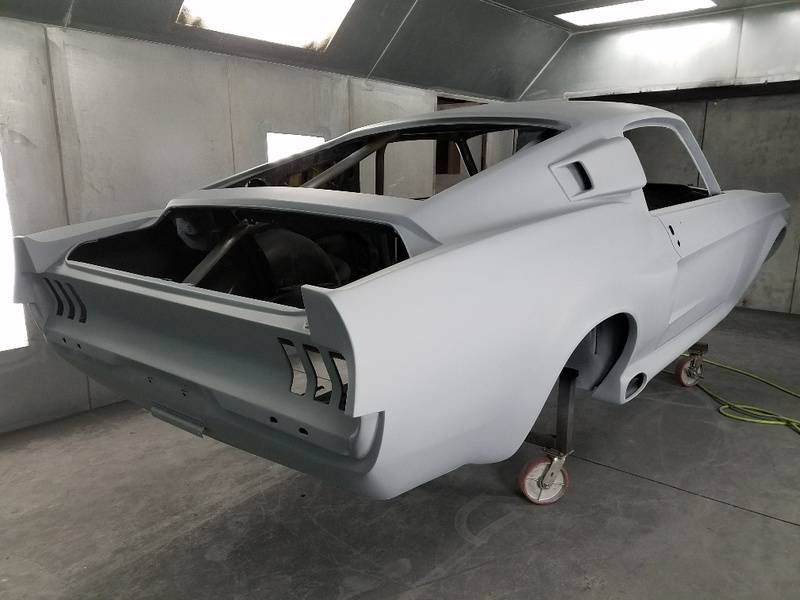

      Bodywork to match the fender to the front apron
      After a lot of sanding and priming
      SPI black epoxy to seal the bodywork
      Two coats of SPI Turbo primer
      Rusty Gillis

      I like how you grafted the headlight bucket onto the fender, cool touch.
