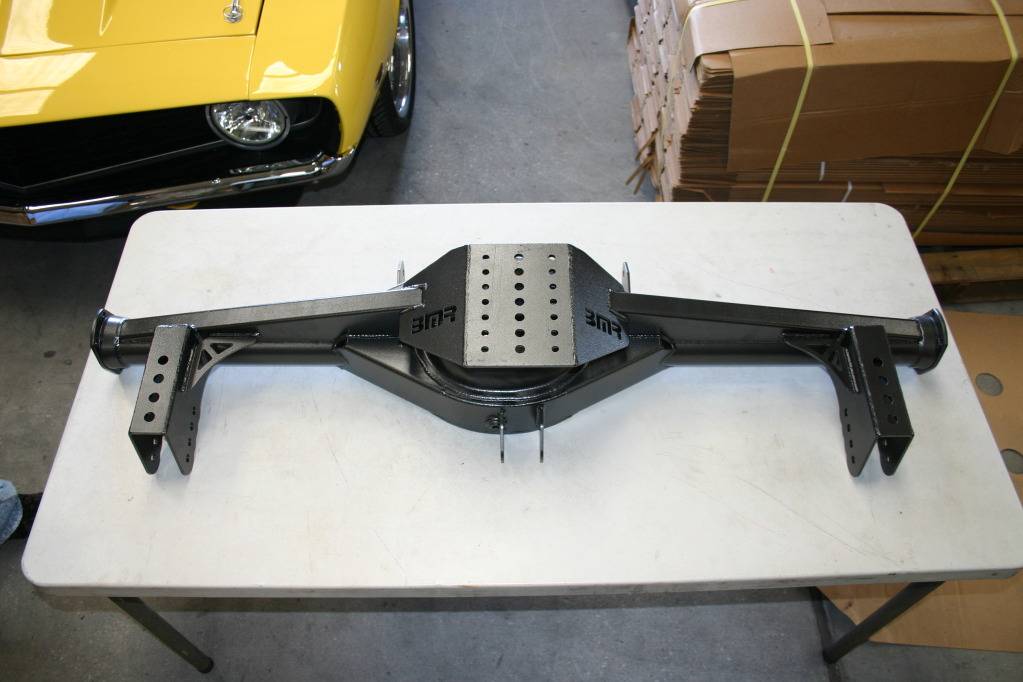

      We offer bolt on Torque Arm kits for 67-81 F-Bodies & 68-74 X-Bodies with 10 bolt & 12 bolt rears & a kit that comes with a Ford 9" as well.
      The guys who want a Ford 9" can order a kit that includes a bare Strange housing for $600 more. Take a look at the link below detailing an install that a member here completed with our Ford 9 in. kit in his 1973 Firebird:

      With our 10/12 bolt kit & OE wheel wells you can run up to a 315 tire on a 10"-11" bolted to a OE rear.
      We can locate the lower control arm mounts further inward on the Ford 9" rear we offer which allow use of deeper offset wheels. The Ford 9” setup will allow up to a 345 tire on up to 13" wide rim with widened inner wheel tubs to accommodate them. We can build the 9" ranging from OE wheel offset up to 5" narrowed (2.5" per side).
      Most guys doing a P-T build spec out the rear as narrow as possible then measure for wheel offsets once the suspension and rear is mocked up in the car before ordering wheels. Some builders order the wheels first, mock them up in the car then tell us what width you need the rear.
