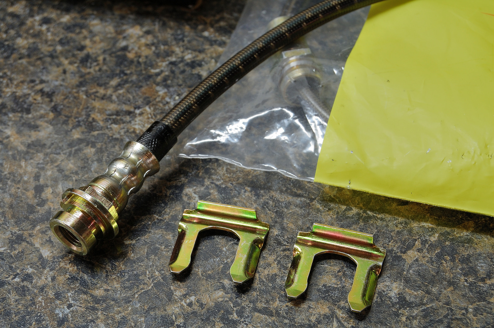

      Well I'm not Tobin. But, I will say that the "normal" 3/8-24 brake fitting is an inverted flare, not -AN.
      What I would advise is to terminate the soft line with a female fitting that fits your hard lines. Likely a 3/8-24 inverted flare or metric bubble flare, like the one pictured below. I like to reduce the total number of fittings and adapters whenever possible.
      With that said, you can order soft lines with -AN fittings if you prefer.
      John

      John, I have been talking to Tobin through emails and he has me going the same route. Hard mount the flex lines and plug the hardlines into the flex lines. Less leak points and common fittings.
      Thanks
