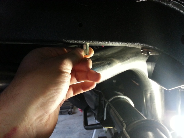

      I was wondering if anyone had any advice on rivet nuts? I'm currently installing the rear hangers on a magnaflow exhaust kit. I bought 3/8" rivet nuts to install in the bottom of the frame rail to bolt up the hangers. The thing the concerns me is a 17/32" (a little shy of 9/16") hole is needed. Does anyone feel that hole is too big for the bottom of a 1st gen camaro frame?

      Sorry so late, but I tried the rivet nuts on my manga flow exhaust. But one pulled out after a while. I ended up welding in nut serts, they look like revet nuts but out of steel.

      Mark is right, the one that failed on me was in a tension load. I made what I call a nut sert. It looks like a shaft with a large flat head, then we drilled and taped the hole to the appropriate size. After that just stick them in the locations and weld them in. I'm sure some one sells these but we made them.

      I just put in 6 rivet nuts for exhaust hangers. I've had good luck with them for years. Proper installation is important: here's the best tool for the home shop that I've found. And I've tried a lot of them:

      McMaster-Carr has a great selection and sells the tools as well. They come in steel, stainless steel and aluminum. The steel top hat style work the best. You need to drill just the right size hole and they work well. I would never use the aluminum ones, unless you want it to pull out or brake inside the frame and spin.

      McMaster Carr has what you need. They will not come out unless installed wrong. Problem is over tightening will cause them to spin. I use knurled steel rivnuts.

      I use them all the time also. I use aluminum in light duty apps, like electrical panels and small brackets. I really try to avoid installing them where the application has them in "tension" such as on the bottom of your rail with the exhaust pulling down on them. I would suggest putting them in the SIDE of the rail so the hanger will pull on them in "shear". Much more likely to survive in this application.
