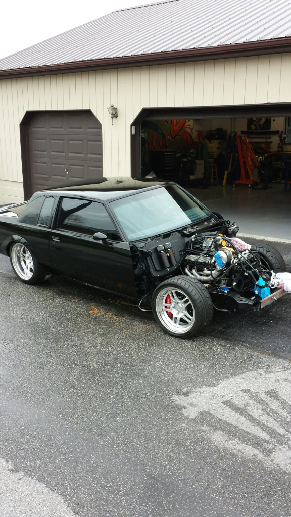

      After a looong break from working on my GN I had some friends help push it out and give it a bath. It was really motivating just seeing it sit outside and clean again! The body is still just on temporarily for mocking up body mounts and checking clearances on a few things.

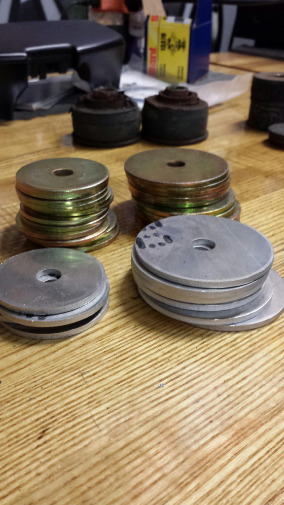

      I had some aluminum washers made to replace all the steel washers that come with the urethane (and factory) mounts. It seems anal but I was really surprised how heavy all the body mounts were. I don't remember the exact number but the new washers were a few pounds lighter than the steel. they are all 1/8" thick.

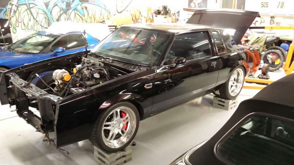

      Hung the front fenders to check the body gaps with all the new mounts in place. Everything looks like it is lining up ok. Im hoping the front sits at least 1" lower than this once all the weight is back on the front.
