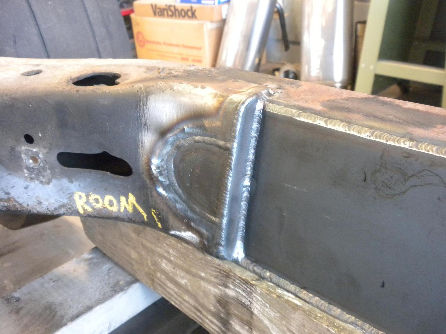

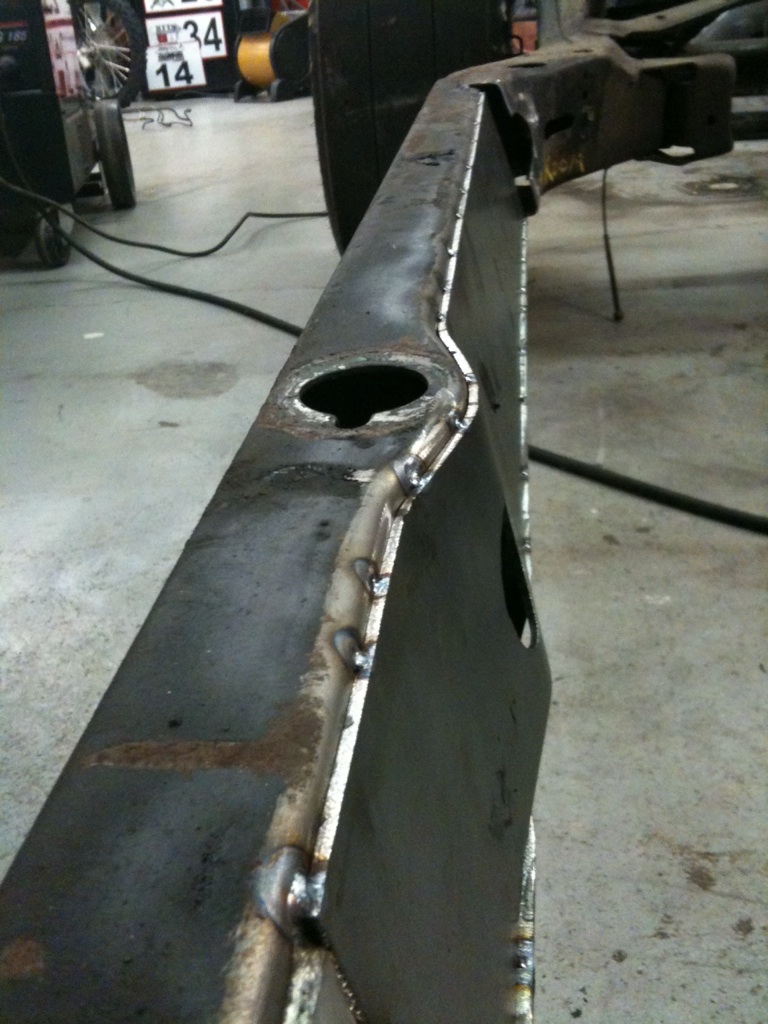

      I finally got around to working on the frame. The first thing I did was box the side rails with 1/8" plate.Name:  frame box cell1.jpg

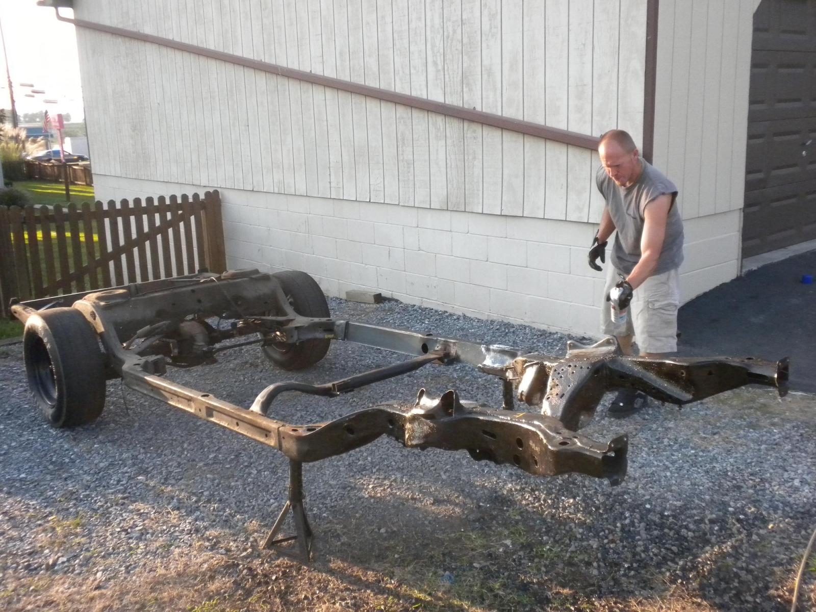

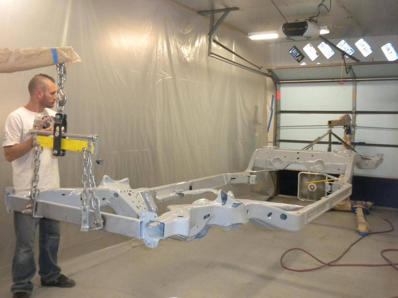

      The first part of this project I outsourced so far was having the frame sand blasted. For some reason it took the guy five weeks to blast the frame and it made me wish I had just bought a cheapo blaster and done it myself. Oh well, the frame did look good when I got it back in bare metal!Name:  bare frame.jpg

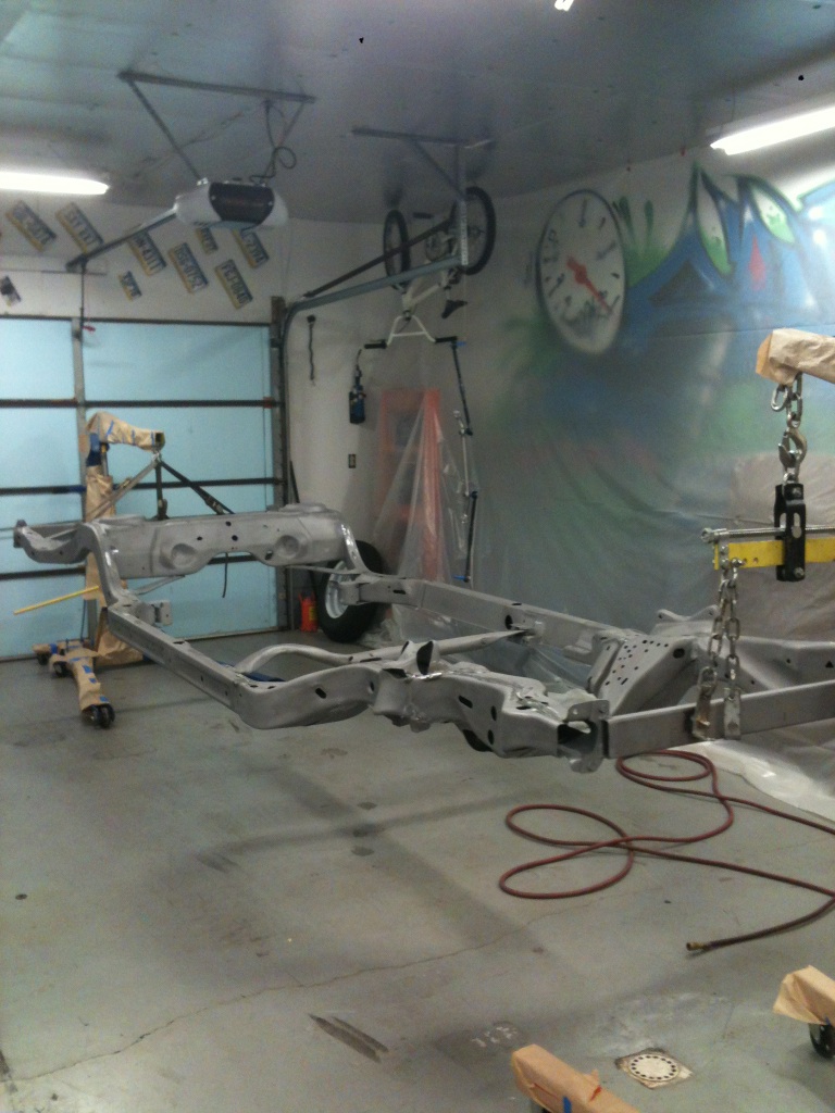

      I sprayed the frame in two coats of SPI epoxy primer, then sprayed the front part of the frame with Eastwood ceramic chassis black. I left the back part of the frame in primer because I still have a lot of cutting/welding to do back there. The front half is ready for some assembly.Name:  Mohawk epoxy.jpg
Size:  151.3 KBName:  frame black.jpg

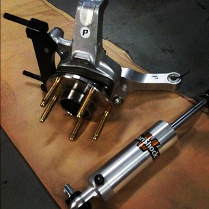

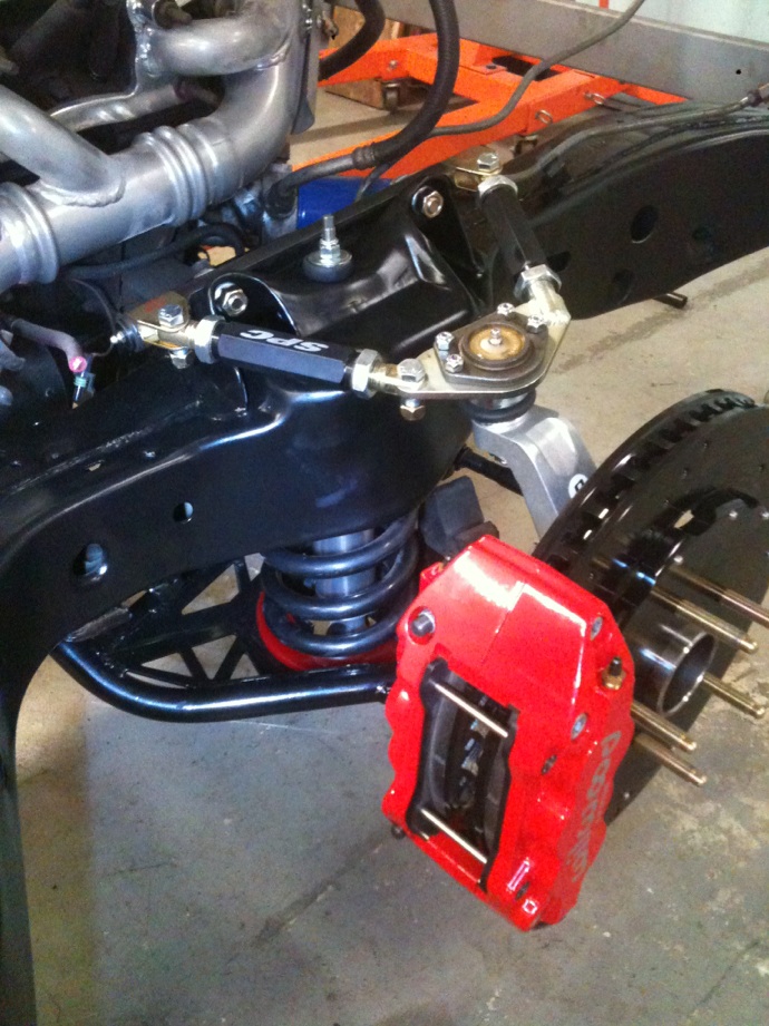

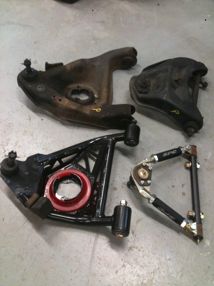

      Working on getting the new front suspension and brakes together. I'm running SPC uppers and lowers, along with ATS spindles and single adjustable Varishocks.Name:  New control arms.jpg

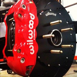

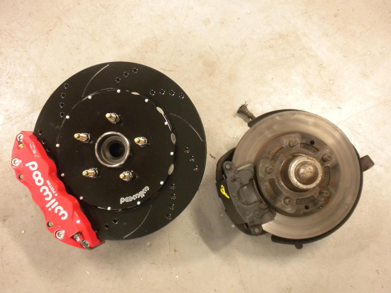

      I went with Wilwood W6A front brakes. They are 14.25" rotor with 6-piston calipers.Name:  BIG brake instagram.jpg

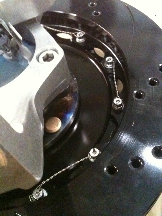

      Name:  Brakes vs old.jpg
Size:  163.4 KBName:  Safety wired brakes.jpg

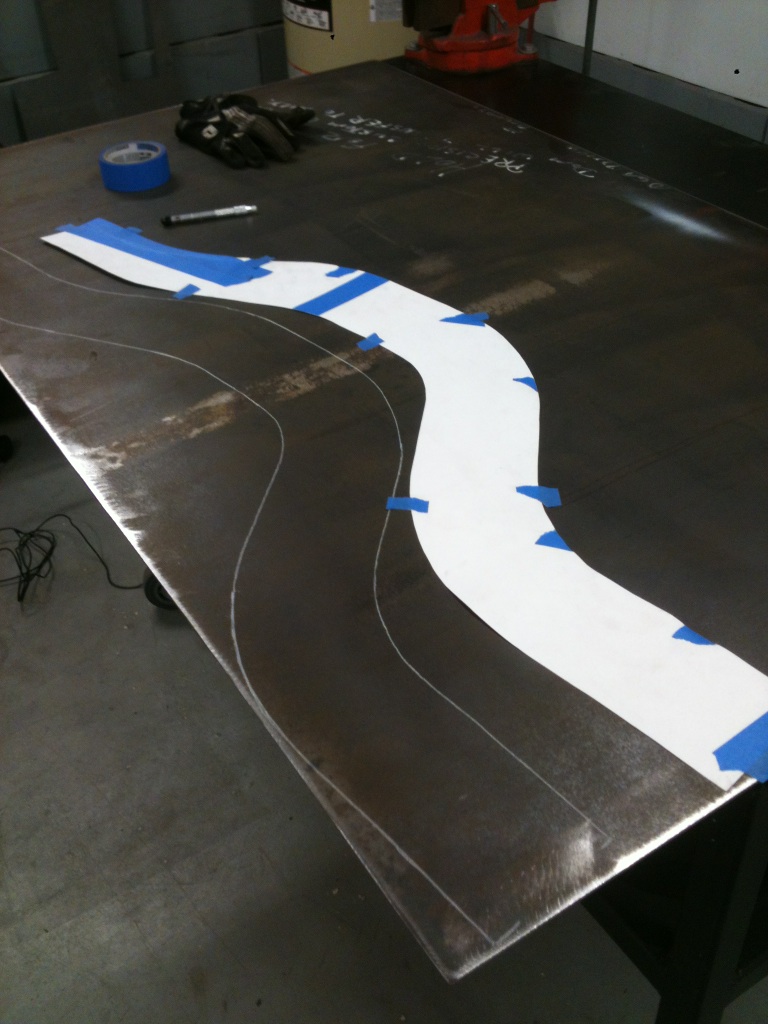

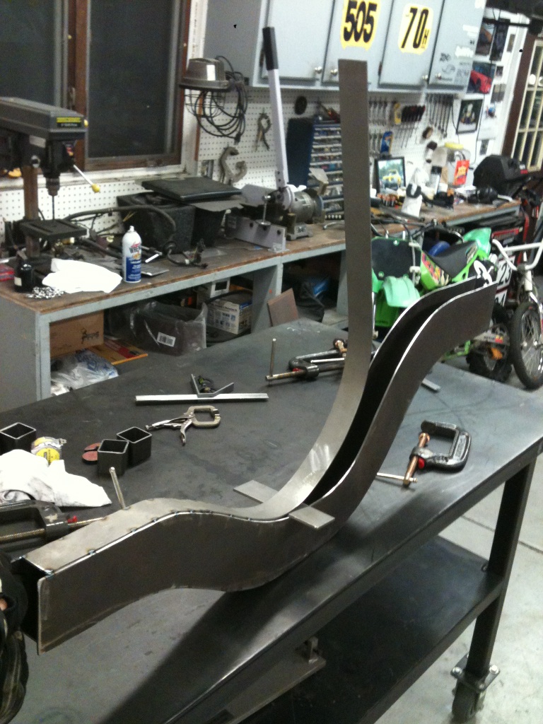

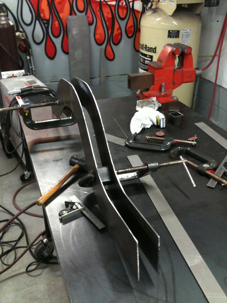

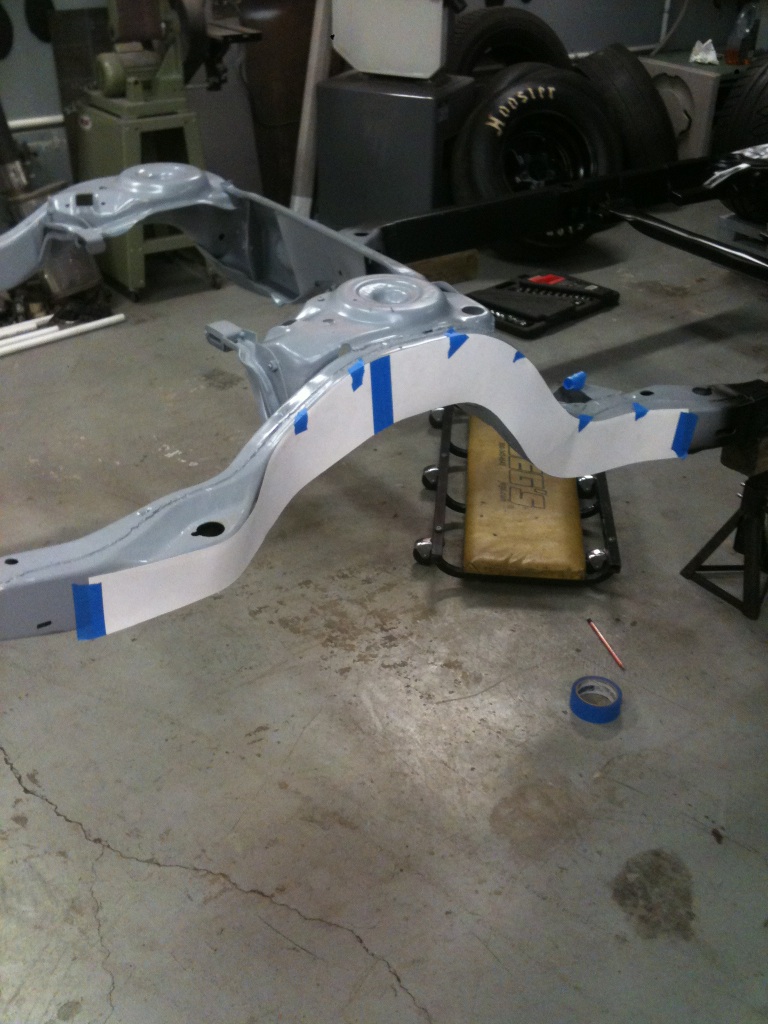

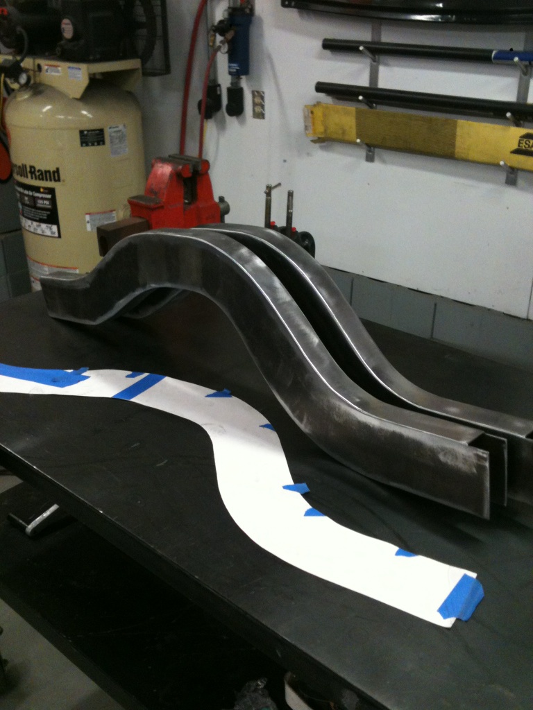

      Started building frame rails to match the OE frame profile.Name:  Frame template.jpg
Size:  224.1 KBName:  Frame plate.jpg
Size:  178.5 KBName:  Frame rail 1.jpg

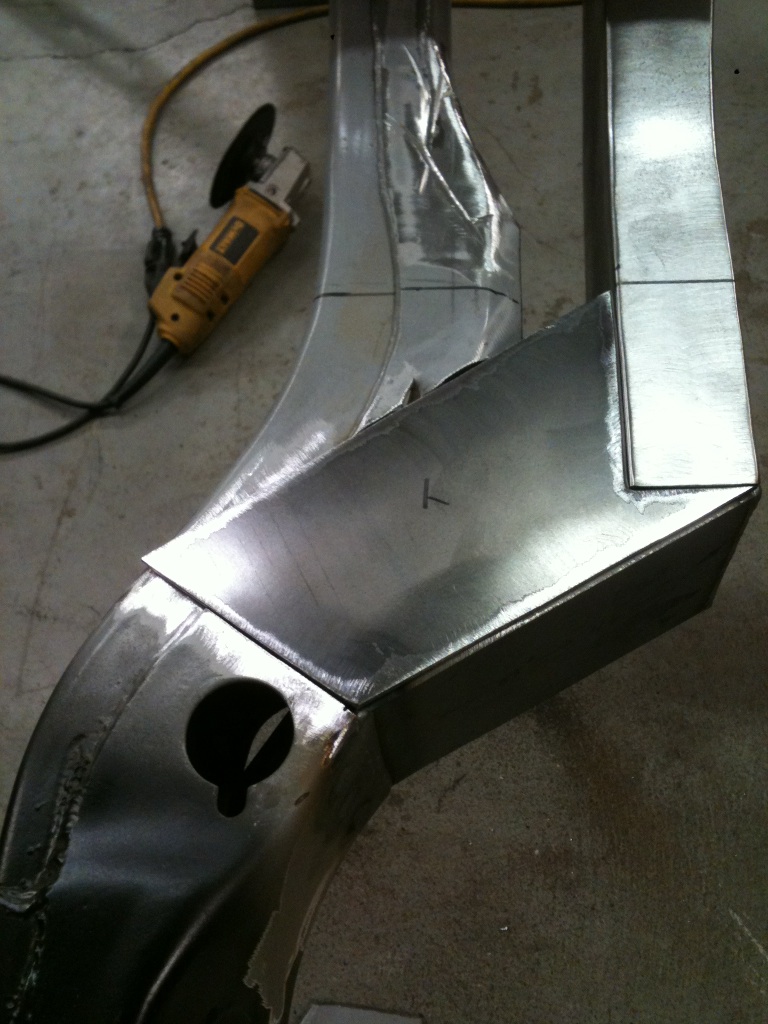

      Name:  frame build2.jpg
Size:  243.3 KBName:  frame build3.jpg
Size:  281.8 KBName:  Frame rails finished.jpg

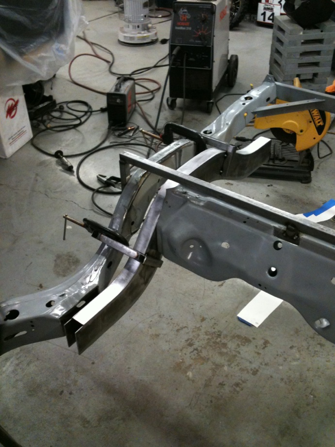

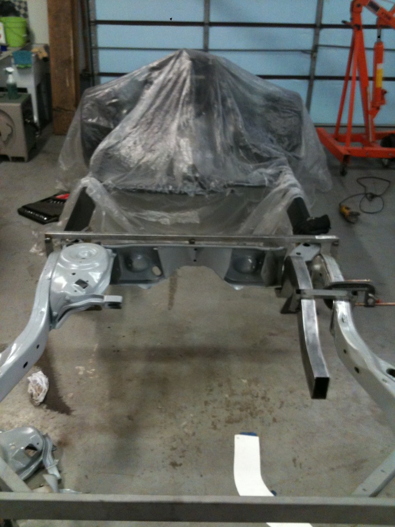

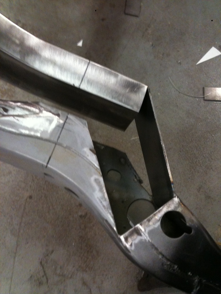

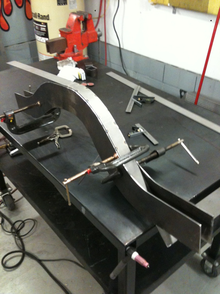

      Name:  New rail drop in.jpg
Size:  236.1 KBName:  New frame front view.jpg
Size:  191.7 KBName:  New Frame boxing in.jpg
Size:  222.2 KBName:  New Frame boxing 2.jpg
