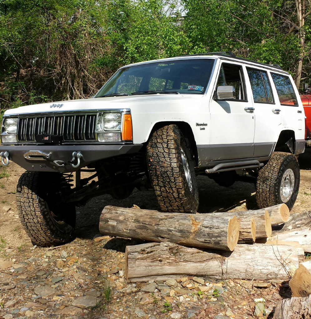

      Been busy building a Jeep for off-roading and I'm gearing up to repaint my 01' GMC truck. After my truck is painted I plan on doing a 6-point bar and fitting harnesses in the Grand National to go with the new seats I put in awhile back.

      nice, can hit some serious trails with that rig.

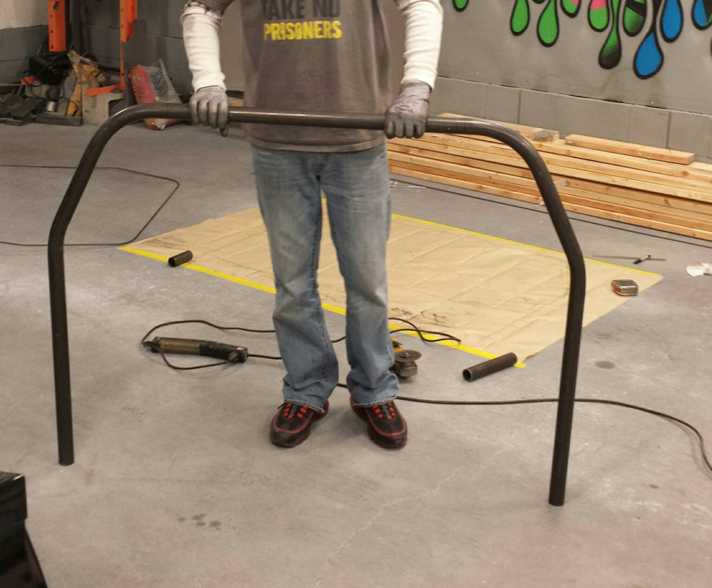

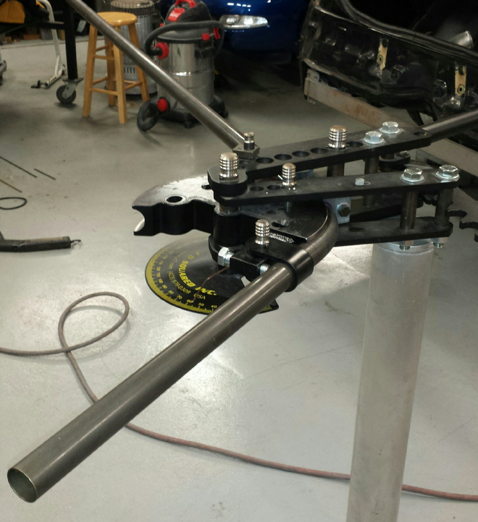

      I started using my new JD2 manual bender to build a 6-point roll bar. This is my first attempt at any roll cage work so it is taking awhile to get things right but so far things are fitting up ok.

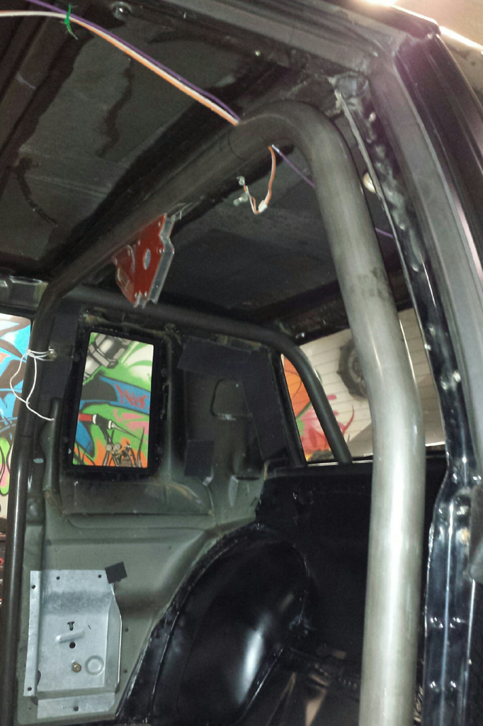

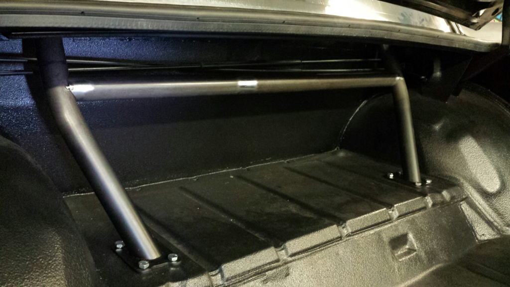

      The hardest parts of the cage are done, I just need to order some parts for a removable harness bar and removable door bars. I want to be able to take those bars out if we take the car on a trip with the kids.

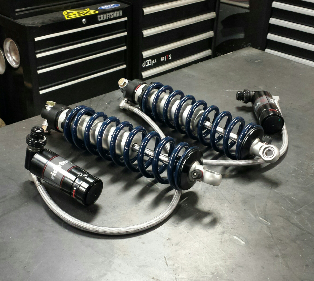

      I finally got a set of coilovers and some miscellaneous tabs since I wasn't sure exactly how I will end up mounting them. ridetech TQ triple adjustable! Theres a lot of different shocks out there to choose from but ridetech and DSE were my top choices because they attend most of the events I go to and I wanted to support them I guess. Plus, Bret or some of the other Ridetech people will probably be around to help me adjust these things!

      Did you attach the roll cage to the farm or just to the body?

      Cage looks nice! So what are those rear down bars bolted to? Are you making the whole cage bolt down and if so why?
