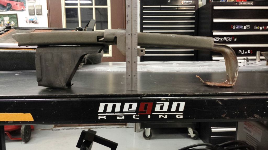

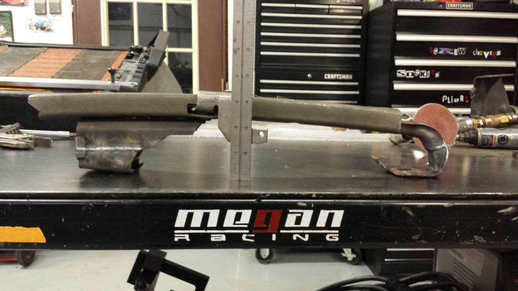

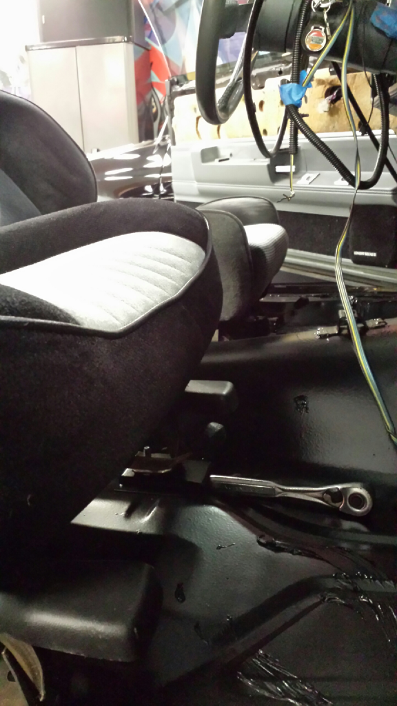

      shortened the seat brackets @ 1".

      The Recaros sit lower than the factory seats as it was, plus now I lowered the brackets so it looks like I'll be sitting a few inches lower in the car. Im lovin the way the seats are working out so far!

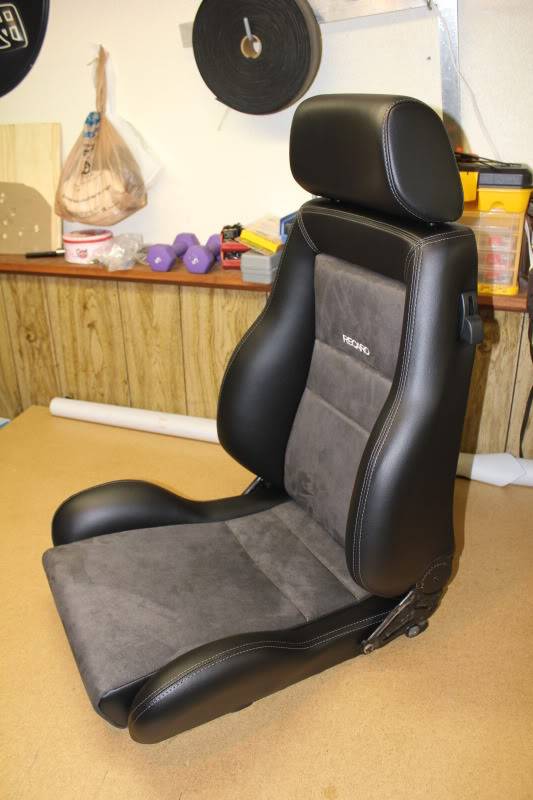

      Quote Originally Posted by GNon18s View Post
      I've been working on getting a decent seat in the car. Since the factory seats offer little to no bolstering for performance driving, I picked up a set of Recaros from an early 90's VW for $375. Yes, Volkswagon! I drove like 4 hours to get these because they are hard to find in good condition with good foam. I really wanted this seat for the car because they look good and have nice bolsters, but mainly they are from the rite era. I didn't want a seat that was too modern or crazy looking.
      Those are always a good find. I have a pair ready for my Cutlass. My other project is a 16v Jetta, I've been a VW guy since 18yo. Those were stock in the 16v GTI's and Jetta's until 1992. I paid $275 for mine knowing I would have them recovered. One of the best guys in the business is no longer recovering seats unfortunately. I did get a pair of his outer covers when he closed out his covers, I'll get the center sections done locally.

      Nice idea and work with the Recaro fitting and details! I bought a set of third gen Recaros (the LX instead of LS style) complete with seat tracks that I am eventually planning to adapt to my car. Gotta refoam and recover them, so it won't be an easy project, as usual. They finally started making foam for the LX seats reproduction. Seat covers will have to be custom...

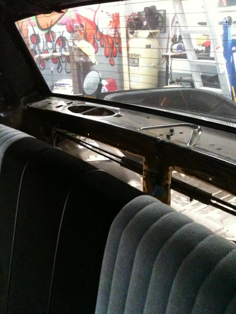

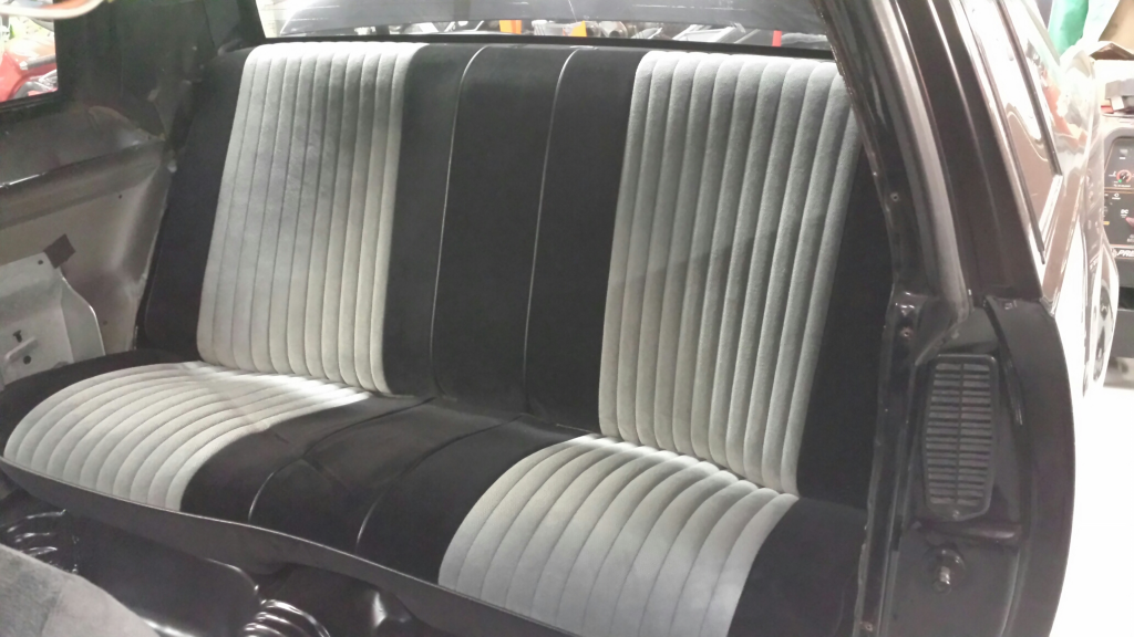

      Here's a pic of the rear seat after I tubbed the wheel wells. It's a few inches away from the rear deck because the new wheel wells are in the way.

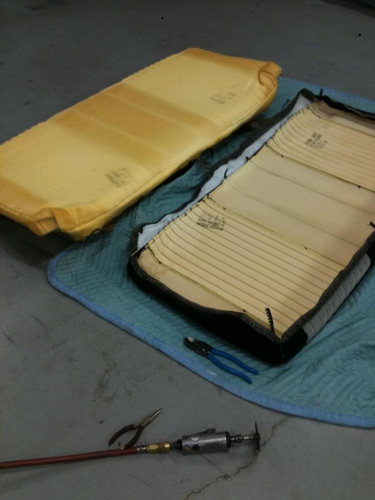

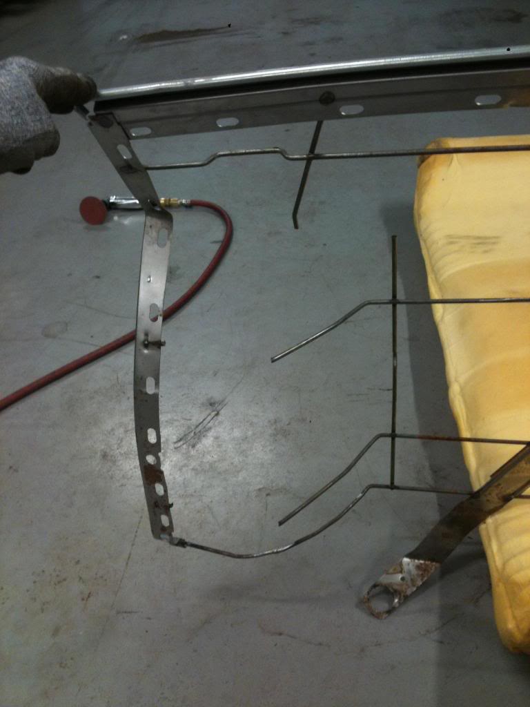

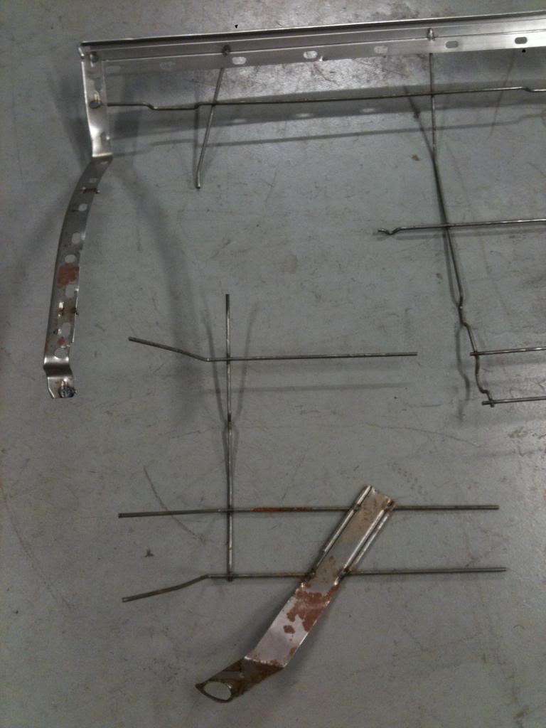

      I took the rear seat apart and re-worked the cage to fit the new tubs. Once I had the cage fitted, I took it to a local upholstery shop and had them make my original foam fit the cage and wrap everything in the original upholstery.

      Here's the rear seat installed. Still fully functional and looks 100% stock. This was a part of the project I was really worried about in the beginning but it actually wasn't bad at all. It was almost fun!

      That rear seat came out hella-great! Looks like it came that way!
