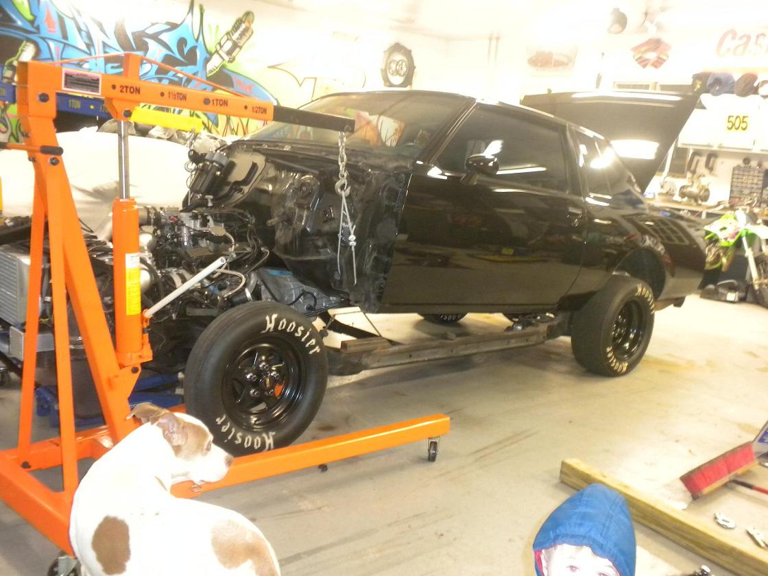

      Starting a build thread here for my 87' Buick Grand National I've owned since I was 19. It was pretty much stock original with a few basic bolt-ons and Simmons 3-piece wheels. I took it apart January 2012 and have been working on it slowly but steadily in my home garage as time and money allows. This is what I started with...Name:  GN photo.jpg

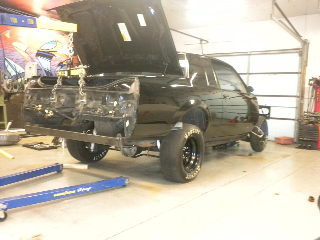

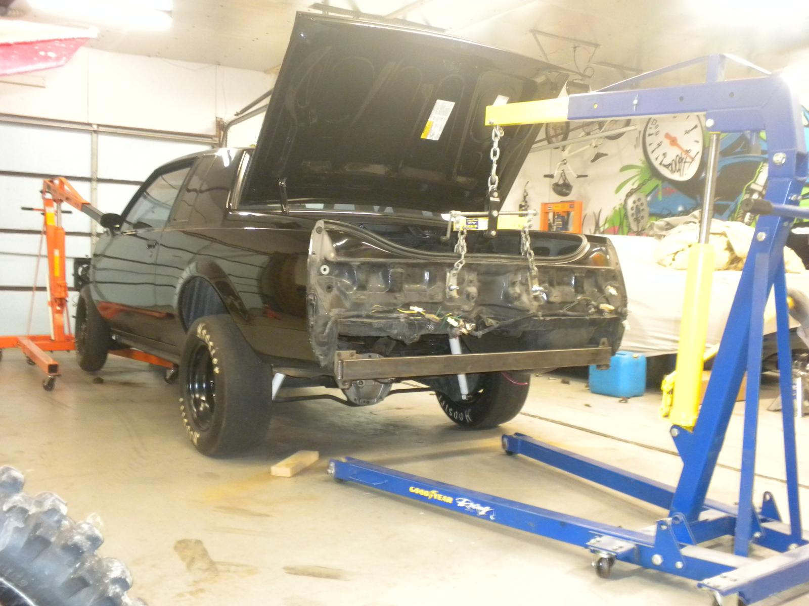

      Name:  body lifting off1.jpg
Size:  179.2 KBName:  body lifting off2.jpg
Size:  125.8 KBName:  body off3.jpg

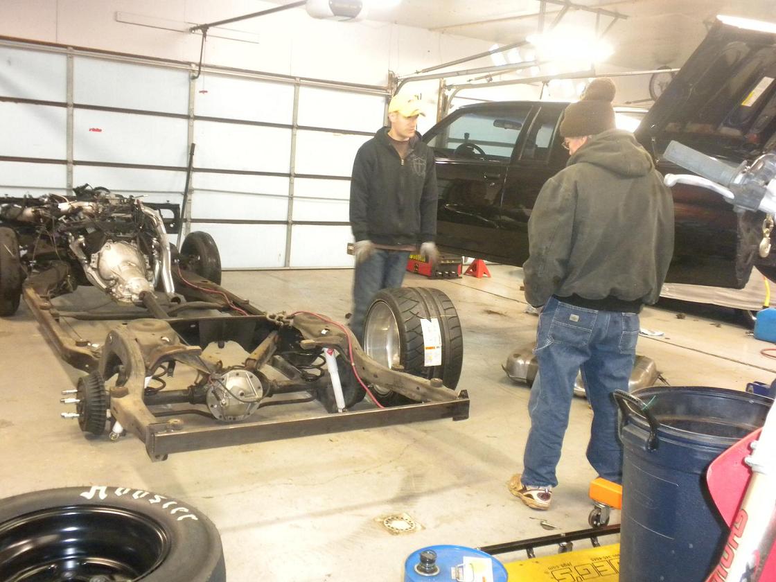

Size:  127.1 KBDisassembly.

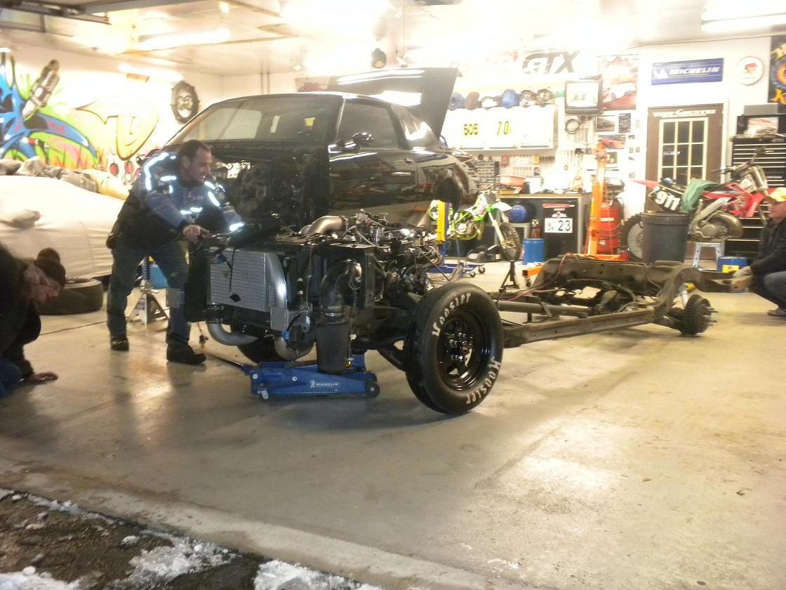

Size:  139.2 KBName:  Frame separate!!.jpg

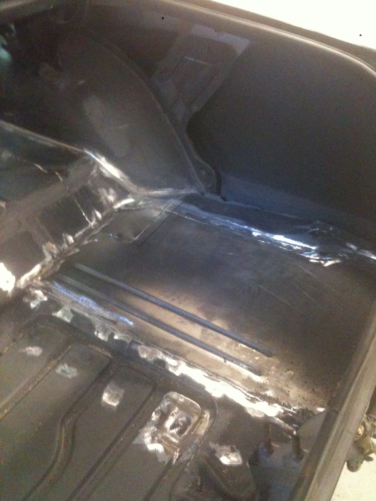

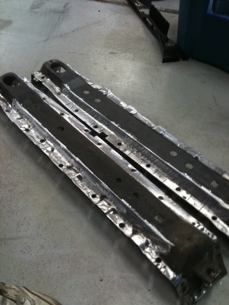

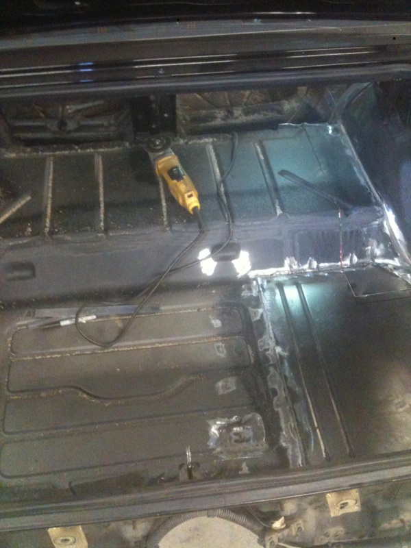

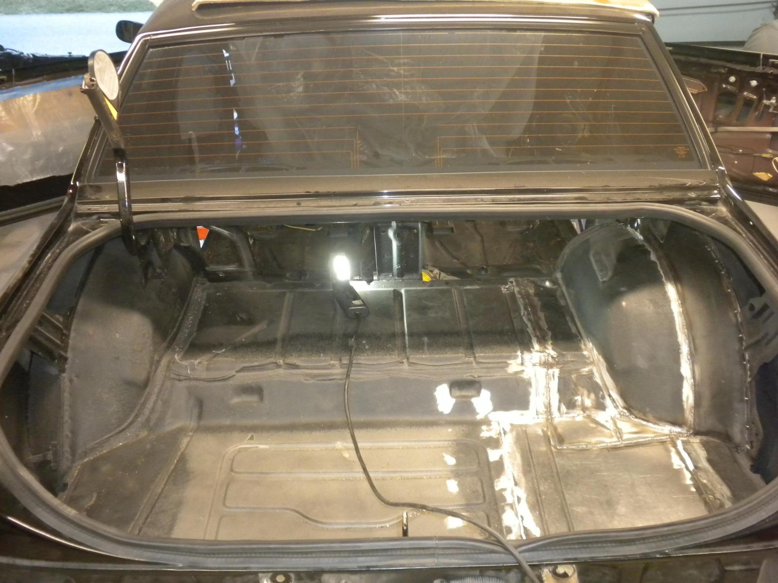

      The factory fuel tank was offset to the left side of the trunk floor and It had a huge spare tire well on the right side. I cut the stock tank mounts off and smoothed the spare tire well. This way I can center the fuel tank and make room for the future frame mods.Name:  tank mounts.JPG
Size:  215.3 KBName:  fill tire well1.jpg
Size:  236.4 KBName:  fill tire well2.jpg

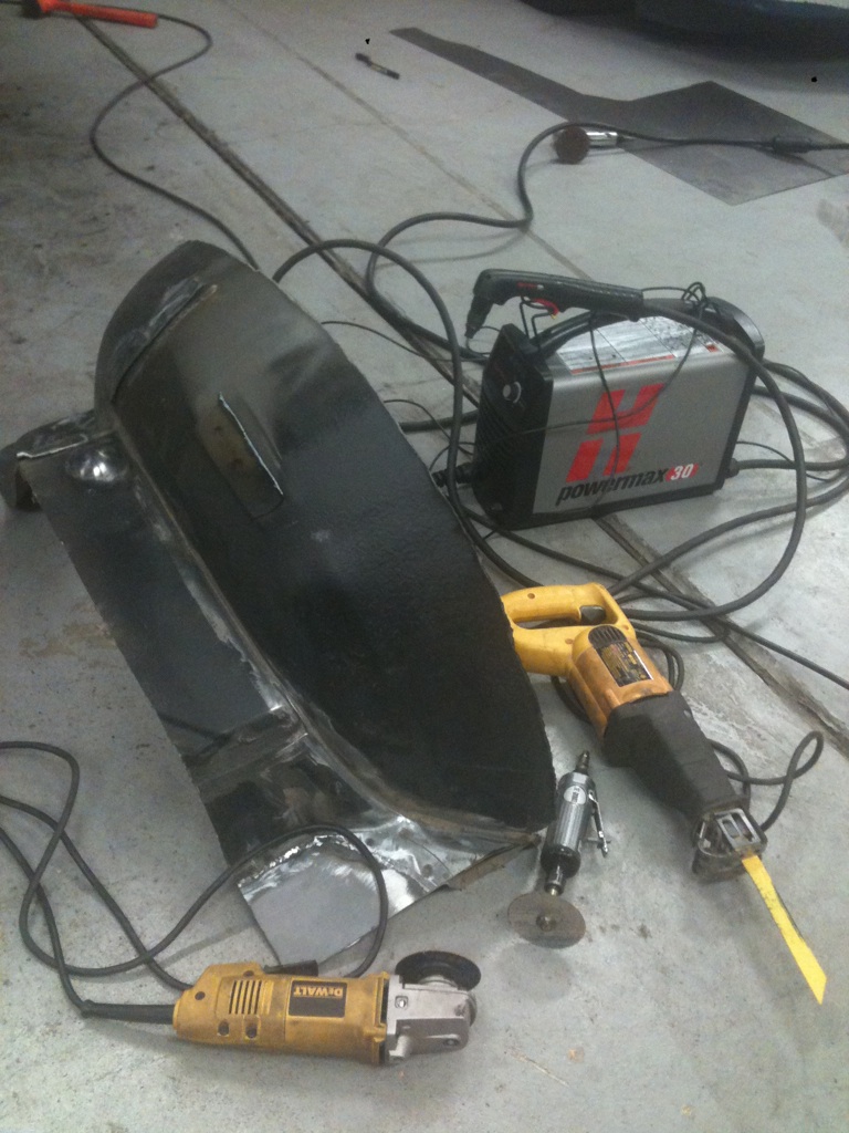

      Name:  first cut wheel well.jpg
Size:  151.2 KBName:  cutting tools.jpg

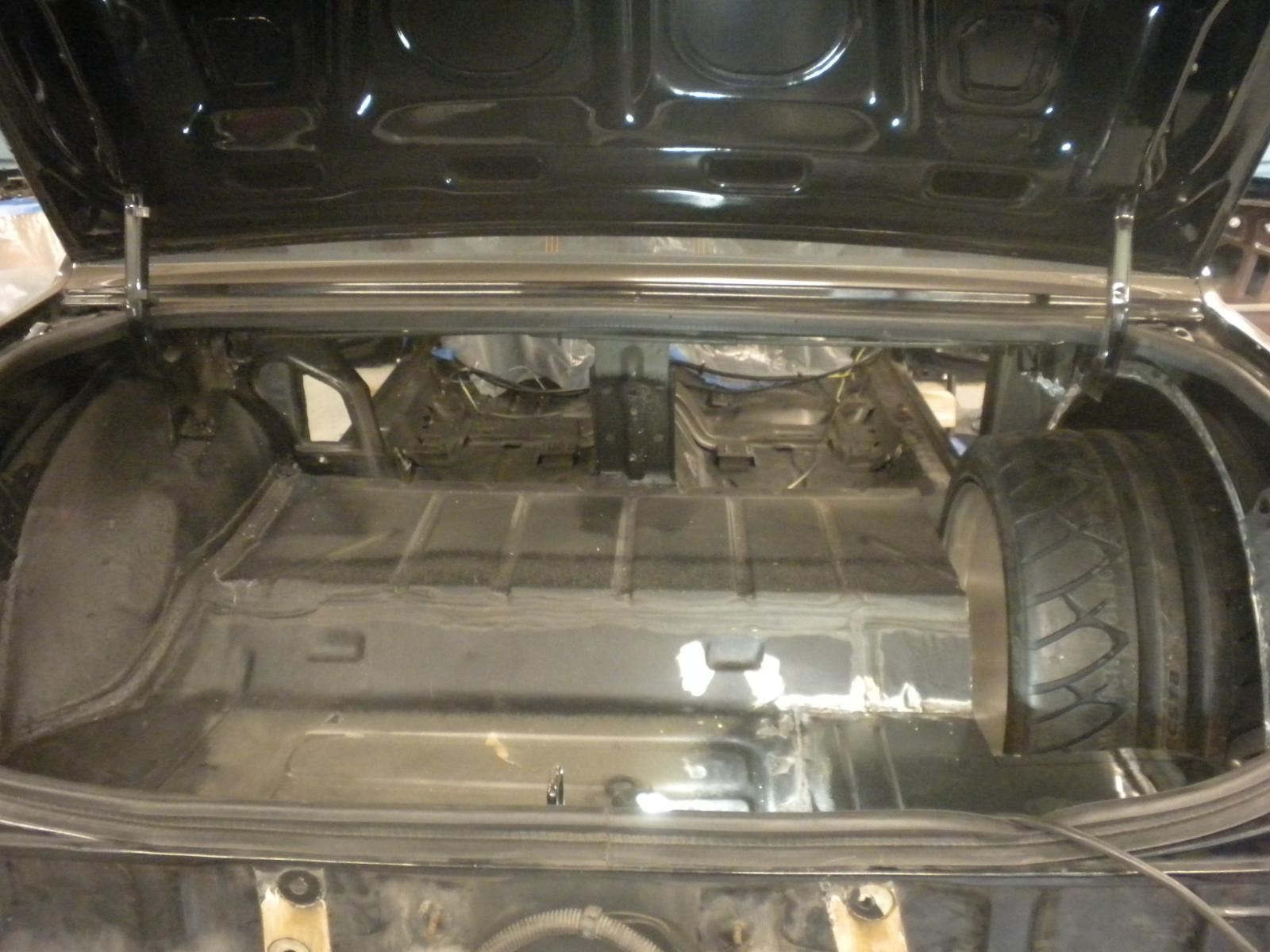

      Name:  Fikse in trunk1.jpg
Size:  173.9 KBName:  Fikse in trunk 2.jpg
Size:  171.5 KBName:  Fikse tucked!!!.jpg

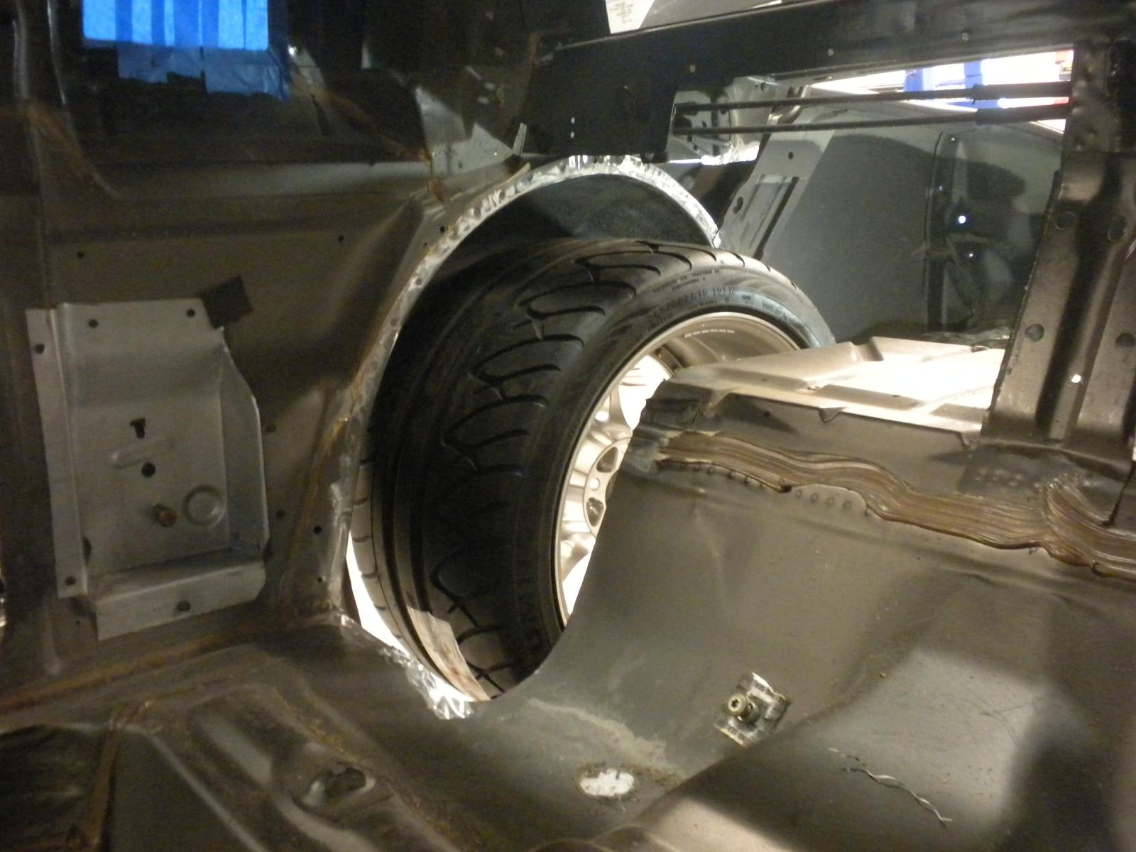

      Sep 2007
      York, Pa
      457

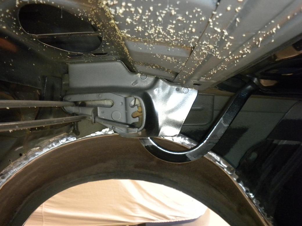

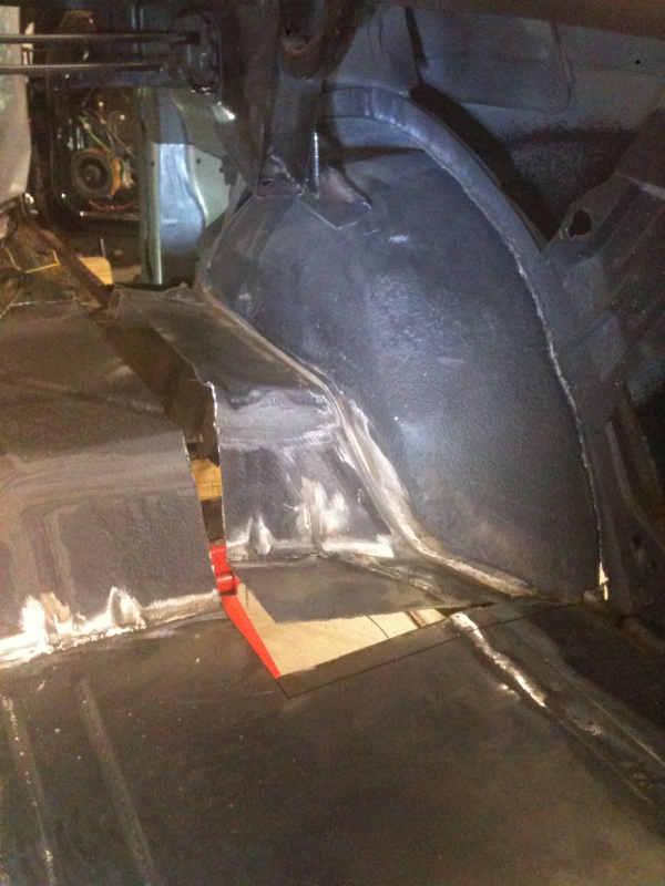

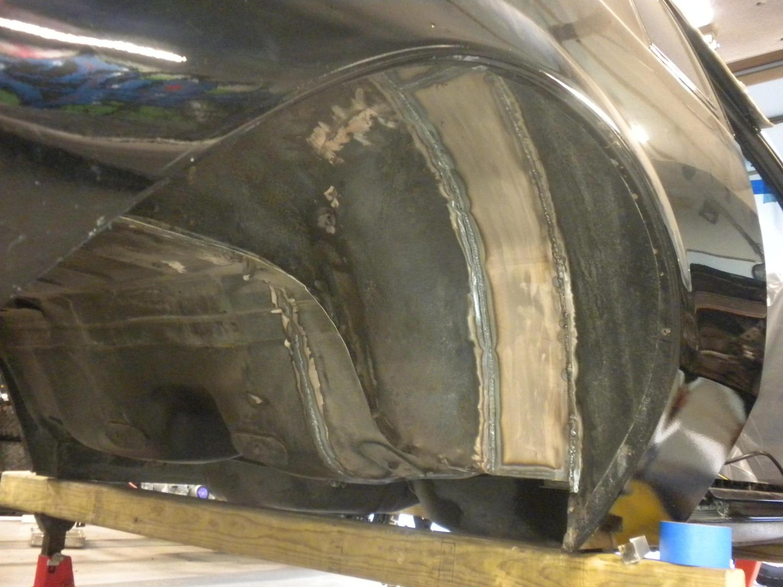

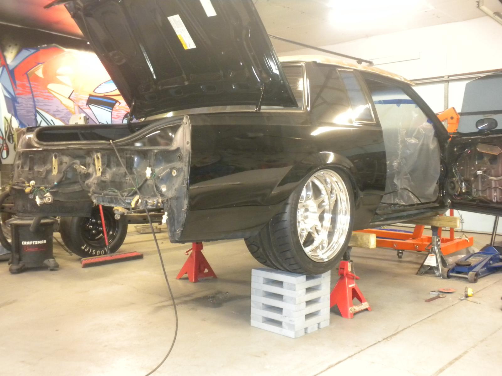

      I spaced the factory wheel tub in about 4.5".Name:  Topside pass.jpg
Size:  199.7 KBName:  Underside pass.jpg
Size:  177.3 KBName:  new tub 3.jpg

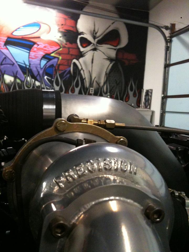

      It will remain a turbo v6/automatic. I'm not crazy about an auto trans on a road course but I want to keep it a Grand National. Its currently a stock long block with a Precision 5857 turbo and big Precision front mount. Current 2004r trans is built nicely. The motor/trans are on the back burner for now, that will probably be a separate project once the car is back together.
