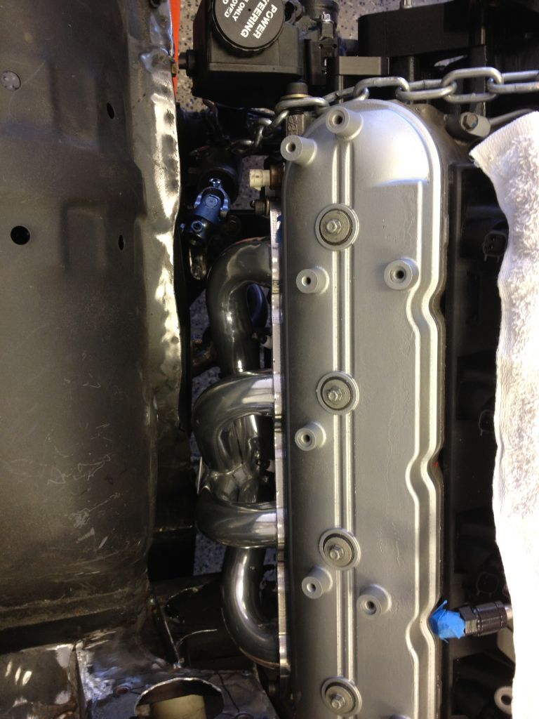

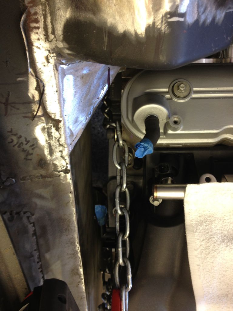

      I had a chance to put the engine in the car today. It went in without any problems. The Swedish ops engine stands and headers worked out great. It sits about 1" further back than my original mock up position. That has solved one problem but created another.
      The radiator now has plenty of room for either a puller or pusher fan. Before I was questioning if I could use a puller like I wanted. That isn't an issue now.
      The problem that developed is with the steering. I had it all planned out and now one of the header tubes interferes with my u-joint. Not a big deal but it now forces me to redesign that area. I should have waited to get all my conversion pasts from Swedish Ops before cutting. The one thing I haven't tried was to raise the engine via the adjustable motor mounts. That may fix the problem but I did not think about it until my wife started to give me a hard time for spending a few hours in the garage.

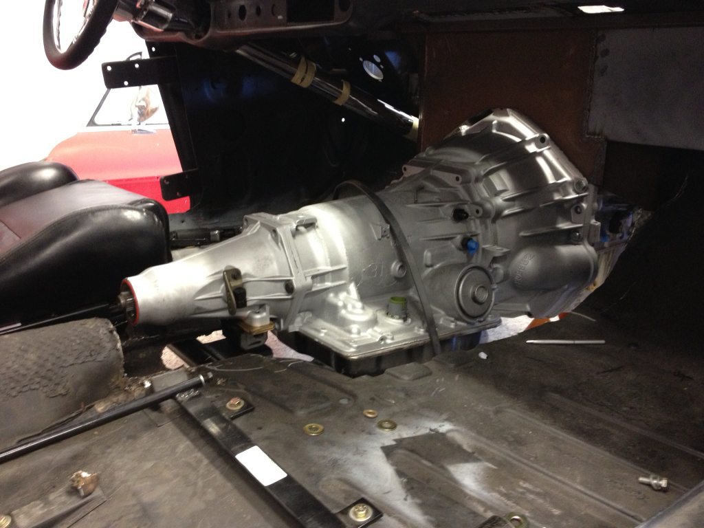

      I think my Dad may come over tonight and help me put in the 4L60E automatic transmission tonight. When it is in I should be able to finish up the steering, trams tunnel and start on the driveshaft tunnel.

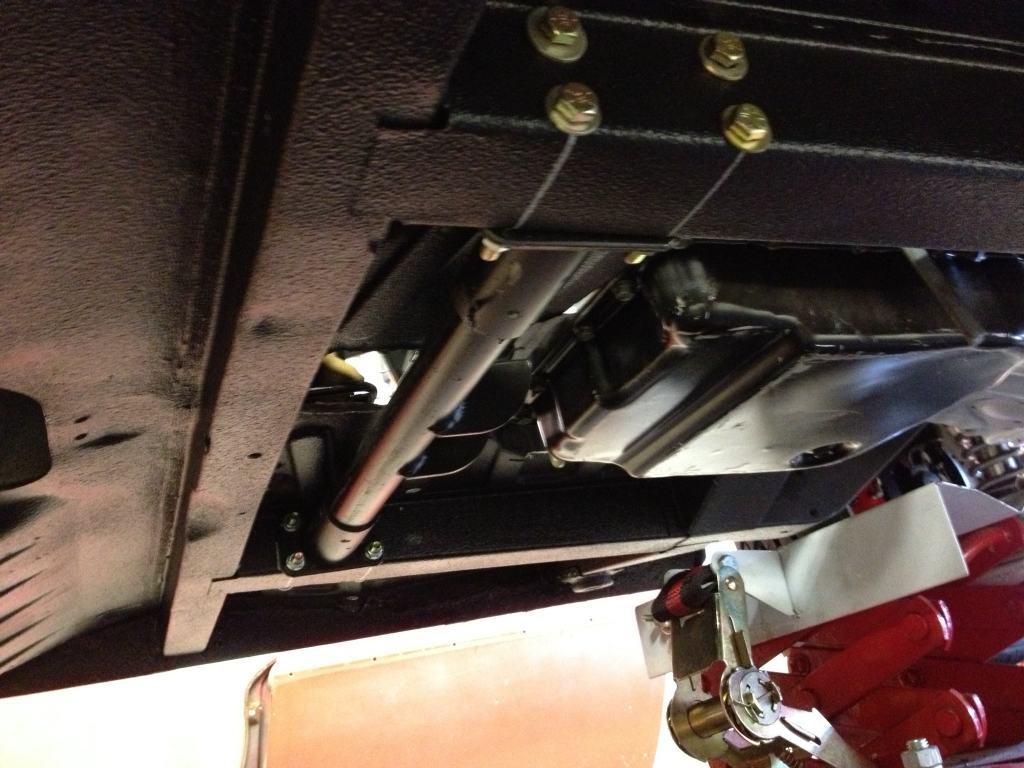

      I now have the transmission in place and can focus my efforts to the firewall/steering shaft and then the transmission and driveshaft tunnels. It has been busy around the house lately so I haven't had much time to work in the garage.
      I still need to do a little work on the transmission mount. I need to make some plates where the bolts go through the frame rails. I hope to have that done later this evening after the kids go to bed.

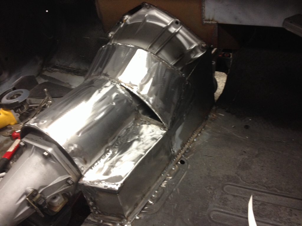

      After thinking about it for a few days I started working on my transmission tunnel today. I want the transmission tunnel to be as small as possible but strong. I don't have an English wheel so I can't make it out of one piece very easily.
      I decided to create a frame around the shape I want using a combination of angle iron and flat stock. I designed a wide but short lower level to hide the valve body. I will start wrapping it tomorrow with 16g sheetmetal. It is a little heavy for this job but 18g wasn't readily available. It looks pretty crude now but I think it will work out well and look nice when completed.

      Looks good, have to work with what you got. I had the same issue, no real way to make a nice curve out of thicker steel so I went with a more boxed approach and just integrated the console into the tunnel.

      I did a little bit more on the trams tunnel today. I am leaving the tail section alone until I figure out the driveshaft tunnel. About 3 more hours and I will be done with this part!
