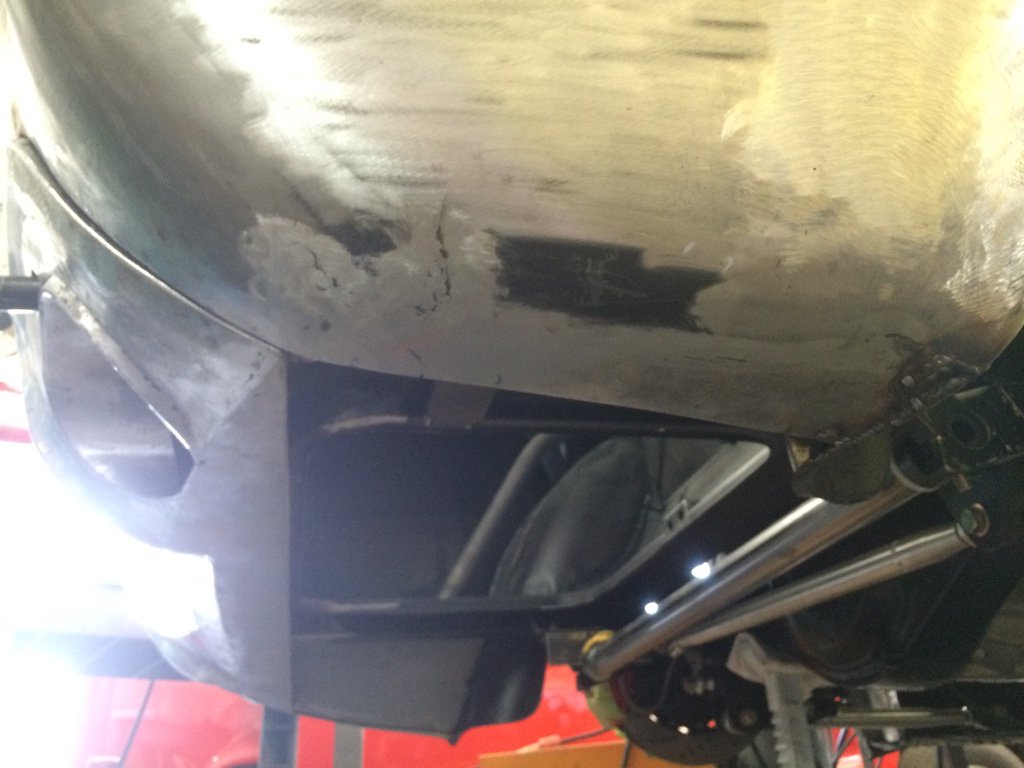

      There has been minor progress on the car in the past week. They are finish whiny up the rear valance. The mods made from the last update were to increase the size of the verticals ridges, recessed the center section and extended the valance back to be flush with the gas tank. They are finishing up on the exhaust ports now. The exhaust will be the same oval shape as the tail lights and the opening will be 1/4" larger on all sides. It will involve creating a lip in the balance for additional depth and visual appeal.
      I should hear back from Ron Sutton Race Technologies regarding the suspension analysis anytime. Overall, the suspension appears to be good but improvements can be made. The rear suspension on the original car simply won't allow me to provide enough traction. My plan is to eliminate the upper bars and add a torque arm. This will force me to remove some of the bracing from the bottom of the car (glad I put a cage in it already). I will have to fabricate new supports and likely change some items with the e-brake. I won't start that project until after I get the car back from the body shop. The car should have better acceleration, handling and braking. A win win win.
      The front will have a couple changes. The changes will require me to trim a little here and there from the original structure of the car to ensure I am getting the most out of it. I haven't seen the final analysis but it sounds like I will move the lower coilover mount out about an inch, changling the height of the lower control arm mounting point as well as adding longer upper control arms. The last one will require the trimming. We are also evaluating using Wilwood spindles for better KPI and using custom steering arms.
      When it is said and done the car should be able to hang with the best of them on a race course and at the car show. I can see why Swedish Ops designed the suspension they way they did. To take it to the level I did you would never be able to go back to a stock setup again. It would require a massive amount of body modifications that almost everyone would not be willing to do. I want this car to be the best it can be and don't plan on compromising on much to get there.
      Darreld

      The exhaust holes have been made into the valance and the drop down panels are in. I also added a tow hook that is removable. It tied into a boxed in frame rail. Once removed a filler panel/bolt will go in to cover the hole.
      The license plate is about to go in. It will be flush on the bottom and recessed on the top. The corners will be rounded and a trim piece will go from both sides and on the top. The trim will be removable and 1/4" thick and chrome plated. Basically the same as the trim around the tail lights. The sheetmetal on the outside is to keep the panel from warping while cutting and welding the license plate
      Next up on the rear will be fitting the rear bumpers.
