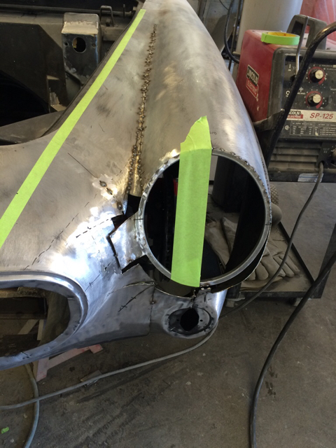

      The front end was pretty messed up from previous body damage and inferior repairs. The headlights were not level and the fenders were also messed up. It is coming along nicely now.

      A little bit more progress in the past week. The majority of the metalwork around the headlights is complete. They still need to finish weld the joints where the metal revisions were made. The old turn signals, which will be used as driving lights, were centered under the headlights. The width across the lower from fenders is substantially wider than original. It should be a much more aggressive look to the front end.
      Here is a stock car for comparison.
      We will now work on a flange to mount the driving lights in. We also will start working on the lower valance. It will be quite a bit lower and have provisions for oil coolers and brake cooling ducts.
