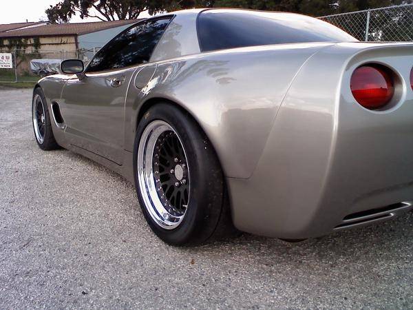

      Doesn't the BMW sport utility run a 345-35-19? Tire rack has some Bridgestones for $400, 28.6 tall. Perfect for a truck but in my opinion a bit tall for a car unless it's big like an Impala. http://www.tirerack.com/tires/tires....=yes&tab=Specs
      They also list a few options in a 345-30-19, 27.2" tall. http://www.tirerack.com/tires/TireSe...30&diameter=19 Probably a little better suited for a car. In comparison, a 275-60-15 that we all used to stuff under our muscle cars is about 28" tall, a 235-60-15 is about 26".
      If the tire is 27.2 tall, and you subtract 19" for the wheel, you're left with 8.2". Divide that in half to get your sidewall height, you get about 4". That's pretty close to the same sidewall height as a 275-40-17, what I have on the back of my car. I don't like rubber band tires either, I don't think a 4" sidewall looks too short....

      Here's another shot. I think the Camaro has 335 or 345 19s. Can anyone chime in on what size Brian's tires are?
