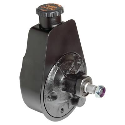

      I'd like to convert my old Saginaw power steering pump to a more modern Type II purely for aesthetics. My question is, I see them described as "high flow" vs "low flow" and I'm not sure which would be best for me. I have a steering box and had to change the ps valve in my stock pump when I swapped the stock box for an IROC one.
      I'd like to grab one from the junkyard and I see that the FWD pumps look the same with a different reservoir, but are rack & pinion. Will this be ok with my steering box?
      EDIT: Also, I have been contemplating hydroboost. Running manual brakes now, but would like hydroboost to be an easy upgrade after the type II swap.
      What I have:
      What I'd like to convert to:

      Interesting. I converted to hydroboost on my truck and love it - that is also a big ol' Saginaw pump. I've seen plenty of people running the Type II with hydroboost, though. Scott from NastyZ being one of them. I'll send him a msg and see how he likes it.

      Went to the junkyard with my bro-in-law today and picked one up from a 2000ish 2.2L S10 that has the same reservoir as I posted earlier and used a steering box factory.
      I can go remote later on if I go hydroboost.
