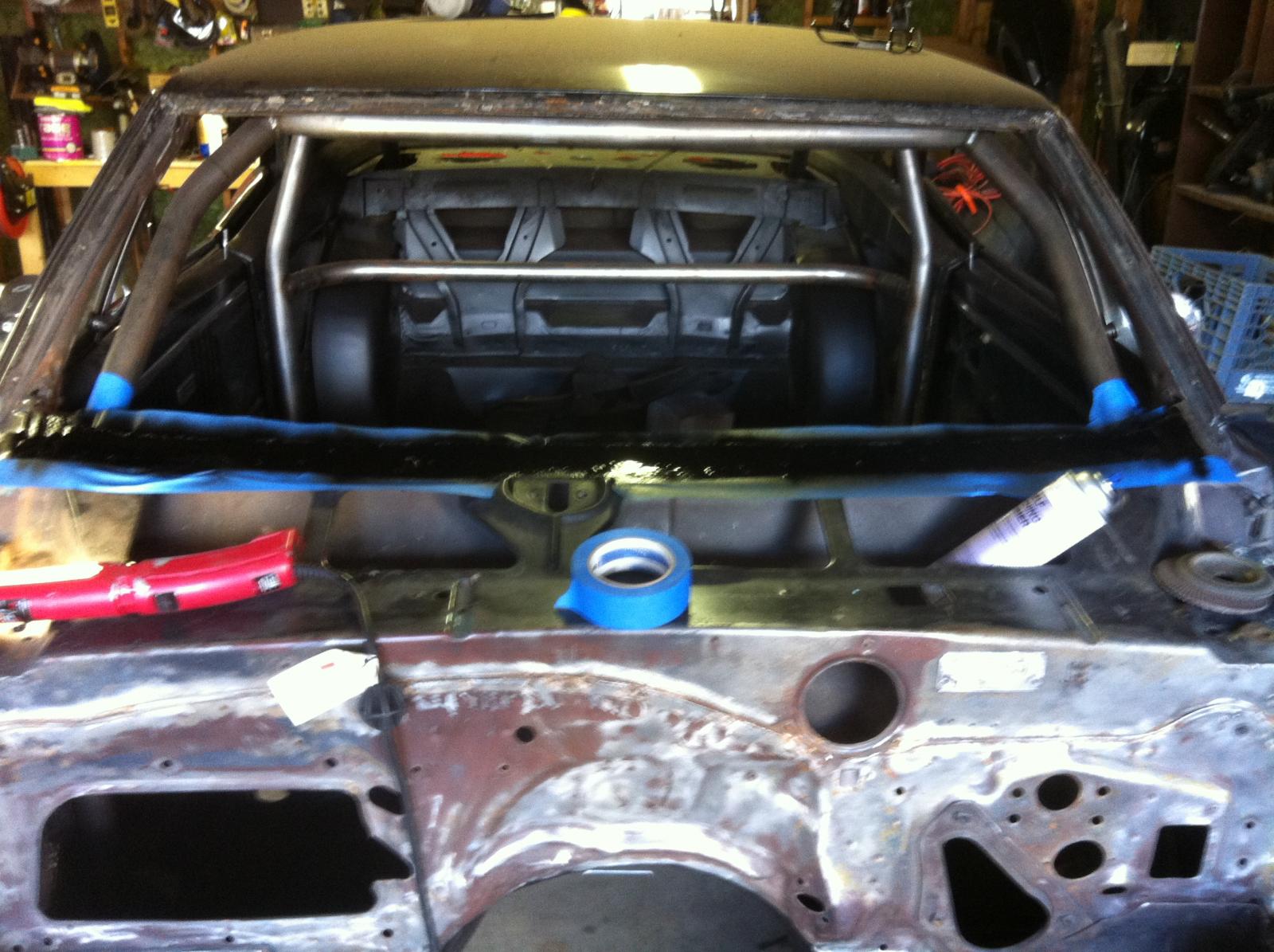

      Sneak peak of the rollcage going in..Name:  trunkBar1.jpg
Size:  112.4 KBName:  Roll1.jpg
Size:  107.3 KBName:  sneakPeak1.jpg

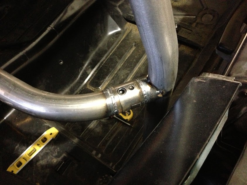

      Sure, floor raised fr the T56 Magnum, rollcage progressing nicely. Check out the removable seat back bar..
Size:  102.1 KBName:  tunel2.jpg
Size:  128.9 KBName:  halo1.jpg
Size:  55.6 KBName:  Tunnel1.jpg

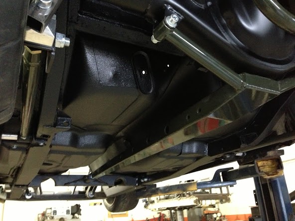

      Subframe connectors.. Going in Name:  SUbCon1.jpg
Size:  52.4 KBName:  SUbCon2.jpg

      Sign sealed an U-Pol proteced
      All sealed and protected, check out the dimple Die tank supports a little tough to see because they are taped off.
Size:  172.4 KBName:  Raptor1.jpg
      67 Camaro In progress

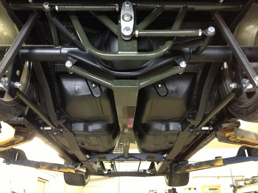

      I love these Pics.. the idea of the underside being finished and it being a roller is really amazing.. 6 months ago it was pretty much a stalled project with a gaping hole where the trunk used to be, with no suspension and a twisted up old subframe sitting behind my garage... Now its a power plant and wiring short of a North East beast,, Anyone up for a little North / south friendly competition...? Maybe the RU faster boys vs the Yankees?

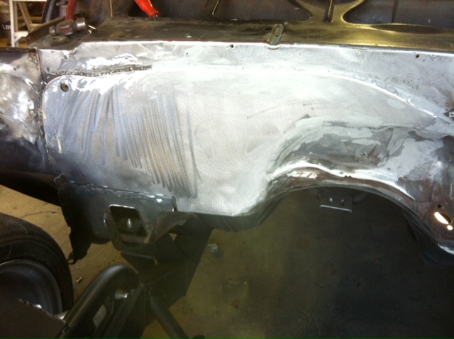

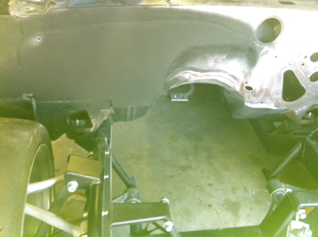

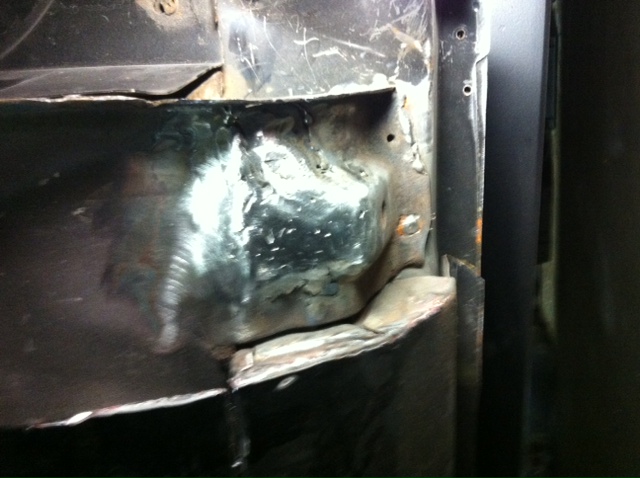

      rust repairs on both sides... plated from behind then welded over the top. Any advice on what to fill the its with? ALL-Metal maybe?
Size:  109.1 KBName:  HoleB4.jpg

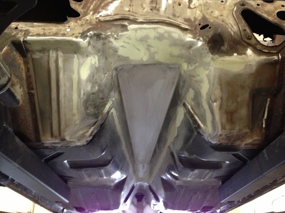

      Some of the final spots that need repair, under the dash, fortunately it wasn't too bad, I was able to clean it up , weld the top seam and seal it up..
Size:  139.1 KBName:  IMG_2615.jpg
Size:  228.7 KBName:  IMG_2596.jpg

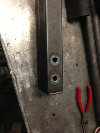

      Decided to take my own path mounting the DSE heater delete plate.. For my 2 cents... drill out the spot welds across the top.. then cut te rest completely out.. leave enough on the bottom to overlap. weld the seam form the inside if possible.. Not done but will finish it up tomorrow..Name:  photo-6.JPG
Size:  115.5 KBName:  photo-5.JPG
