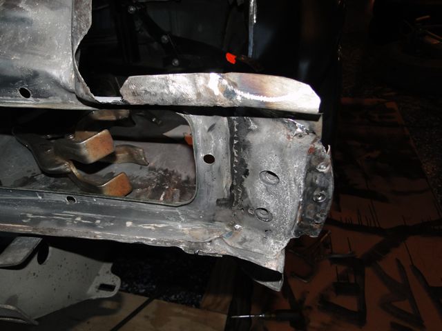

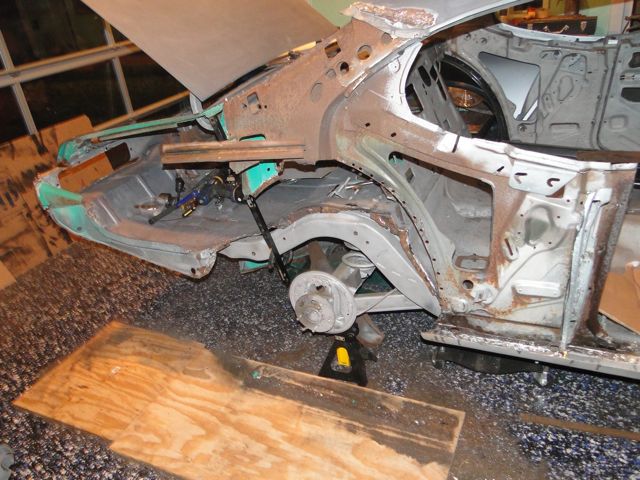

      Got the firewall panel fit and ready to weld.
      Cleaned up the LQ9, right side header bolts not so good, snapped one but it was ready to fall off and the front and back ones were gone when I got it.
      After a day of fitting yesterday the drivers side quarter was ready to weld on. Used the SEM panel adhesive on the lower half, that 90 minute work time goes by fast when you work alone!
      Sorry for the large pics.

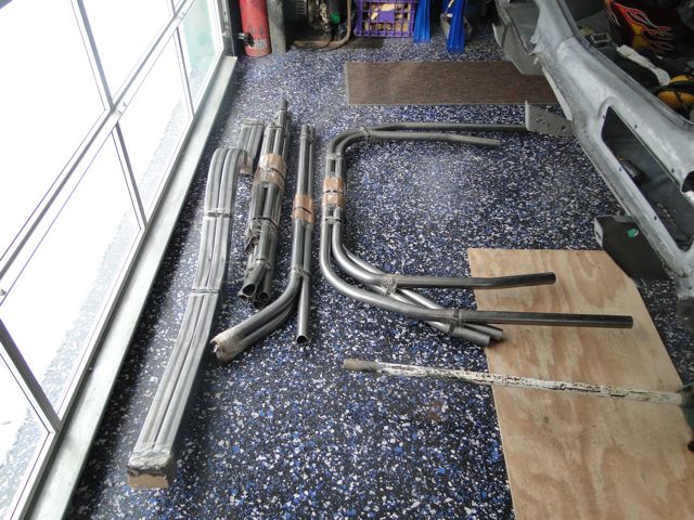

      Figure I better get an update in before the end of the world today.
      Placed an order for the roll cage and bent 2x3 frame rails, got the DOM 1 3/4 tubing.
      http://autoweldchassis.com/rbc.ivnu
      Thinking about setting the engine back more, cutting the firewall (adding lots more work)
      Trying to get all the quarter work done first, got the passenger side off.
      Need to research flush glass how to's, new window / trunk pan is next, planning on sliding it up to get rid of factory molding.
      Oh and if the world doesnt end today MERRY CHRISTMAS!

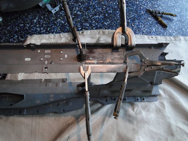

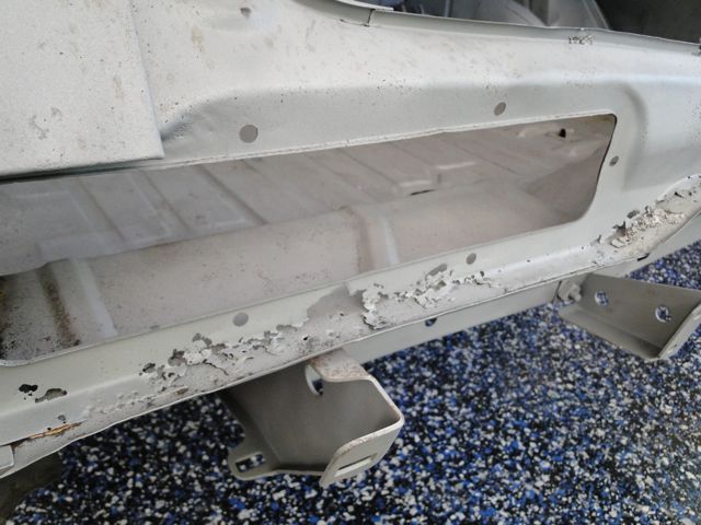

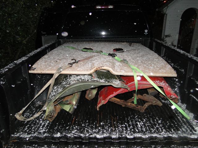

      Bought fairly good fenders and a hood from a guy in CT over the weekend, gotta love Craigslist. Will be felling better with the front sheet metal on and lined up so I can match up the gaps before I finish welding the right quarter.
      Been fixing rusted tail panel, package tray and radiator support with good metal from parts cars out back.
      Sorry for all the boring sheet metal updates! I cant wait to be finished with the body so I can move on to more exciting parts of the build.
      Roll bar and rear frame rails showed up from Autoweld. That will be next to play with.

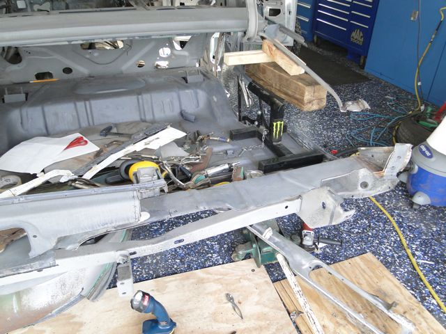

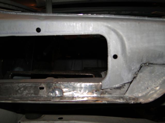

      Tail Panel
      Some more work that will never be seen once the car is done.
      Salvaged a bent but solid one off my parts car. Lots more welding to do, but feeling better that this is coming together.

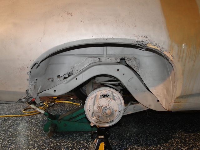

      Jun 2012
      N. Shore, Ma
      346
      Quote Originally Posted by SShep71 View Post
      Are those dynacorn quarters? how did they fit?
      Hey SShep are you back home yet?
      Overall I was happy with the fit of the quarters, I only had to cut the top of the sail panel a little bit to help the curve at the top of the back window. They are Dynacorn with the weld through primer.
      Wondering if it is best to strip the primer on the outside so I have the same SPI Epoxy primer base on everything?

      Nov 2011
      Fort Worth, TX
      42
      Hey Eric, from the pictures it looks like you installed the quarter panel before the inner fender wells. Is that correct?
      I mini tubbed my 70 GTO by stretching the factory inner wells but I'm not to pleased with the outcome, so I am considering ordering the ABC mini tub kit. The reason I am asking about the quater panel process is because I have both left and right replacements and was wondering if I should install the quarters before the mini tub kit?
