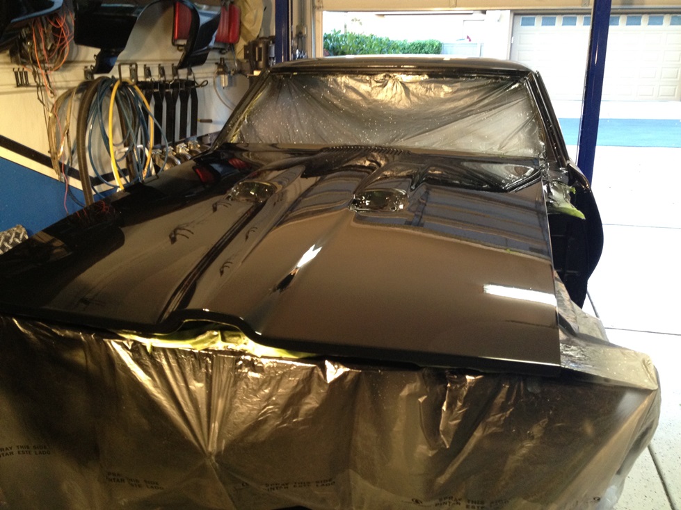

      Eric, great progress... especially the frame decision... I might have to add that to my Rev 3.0 list. Ha, ha... at least I already have the 13" and 14" Willwoods. Any way, I painted the entire car last weekend... so, I hope it inspires everyone here. Now I get to color sand and buff... I can't wait for the sanding to end! I've been sanding for freakin year!
      Enjoy, Mike.
      Name:  Hood Paint.jpg
Size:  226.2 KB Name:  Body before Paint I.jpg

      Mike nice job on the paint! All that sanding will pay off just take your time, love the spray booth too, I will be doing the same setup.
      What system did you go with? I have some SPI epoxy primer but need to pick up some 2K primer.

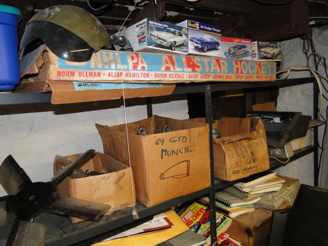

      Pic of the night, some 28 year old boxes of GTO parts.

      Eric

      Thanks... the paint looks pretty good, for my first time. Some trash here and there, a couple minor clear coat runs, but that's to be expected shooting in a garage. Because this was my first time, I went high end with the paint materials, because they're typically much more forgiving. That said, I used all BASF Glasurit line... Epoxy, DTM Primer, and the Clear. The Base Coat is BASF Limco, which is their low cost line and how I saved a little money. I used a Devilbiss Finishline 4 for the primers and a SATA for the base and clear. In all honesty, the bumper prep was the bitch... when you get to that point, I'll be happy to give some pointers. I can't wait to hang it, it's gonna look mean...
      Sooooo, if you're willing to drive out to San Diego, hell yes I can wait. Ha, ha...

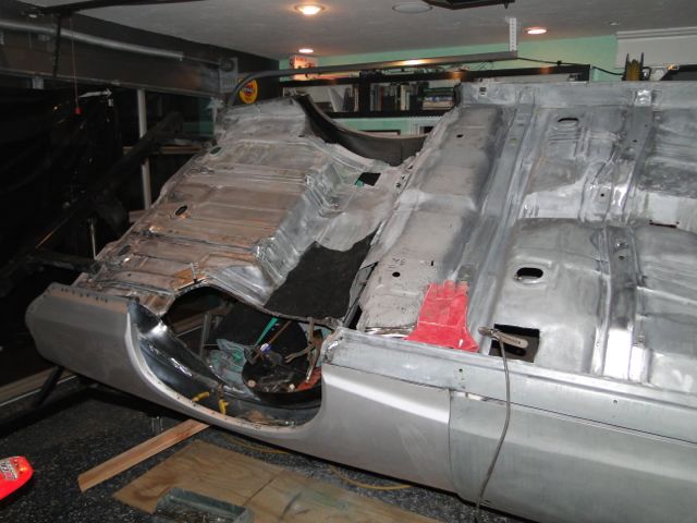

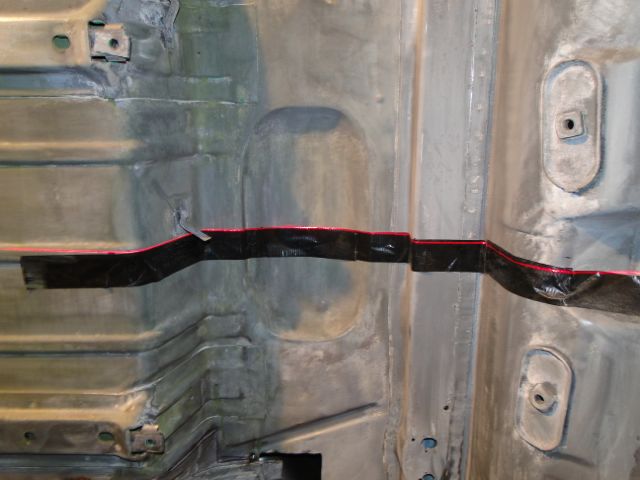

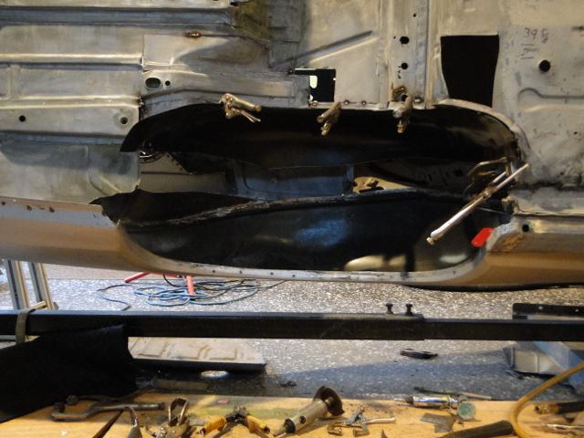

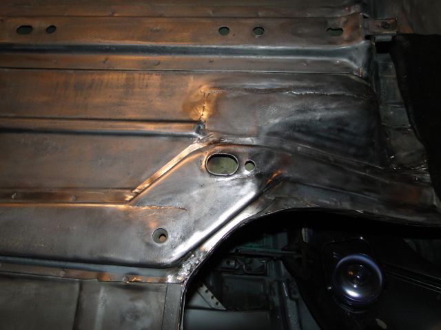

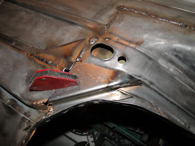

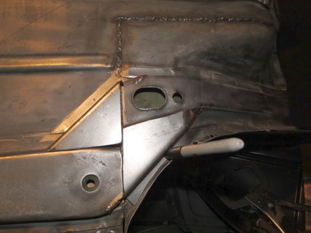

      Committed to a location for the inner wheel house. If it does'nt work out it will be hammer time!

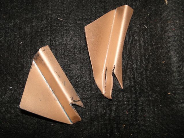

      Made up some 14 Gage filler brackets.
      Hope to finish this side tomorrow...

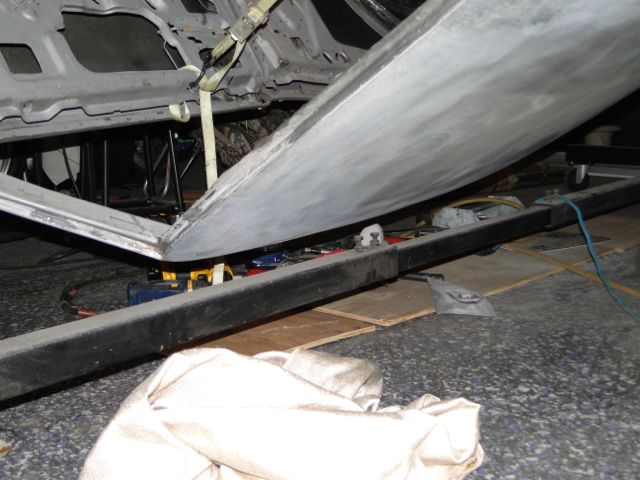

      Had a scary moment spinning the body into this position, it must have shifted a little while making a loud bang. I thought it was going to drop onto the roof!
