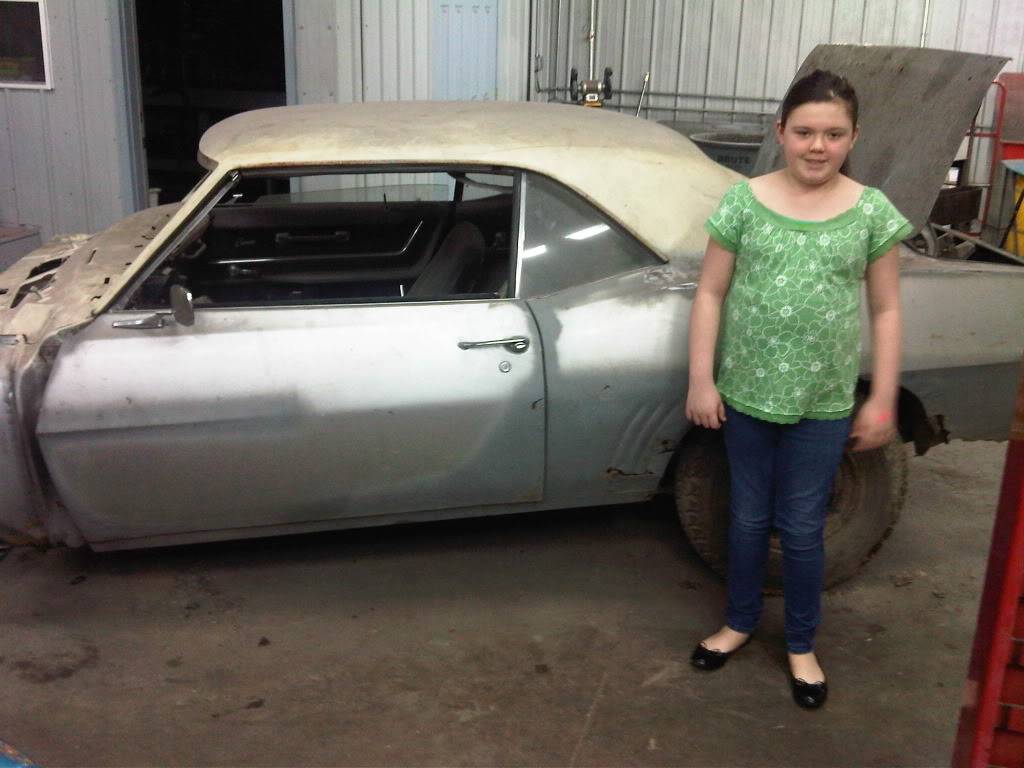

      The future owner, before we had the shell brought home. Five years until she gets her license.

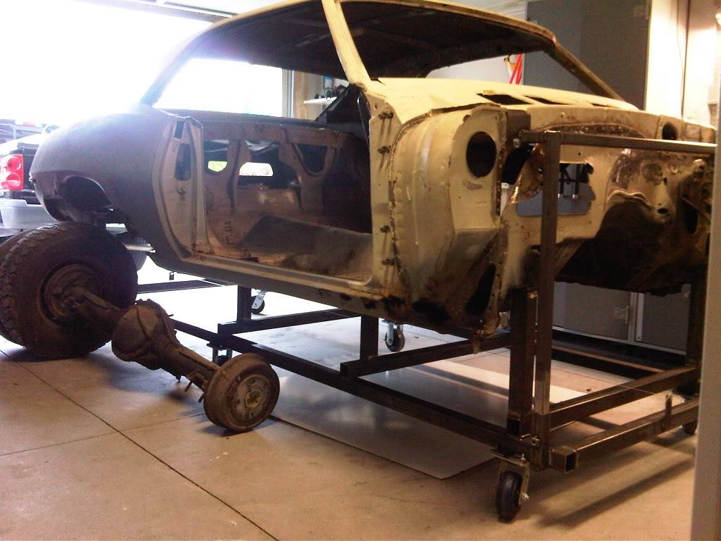

      Up on the body jig to assess the sheetmetal work that was required

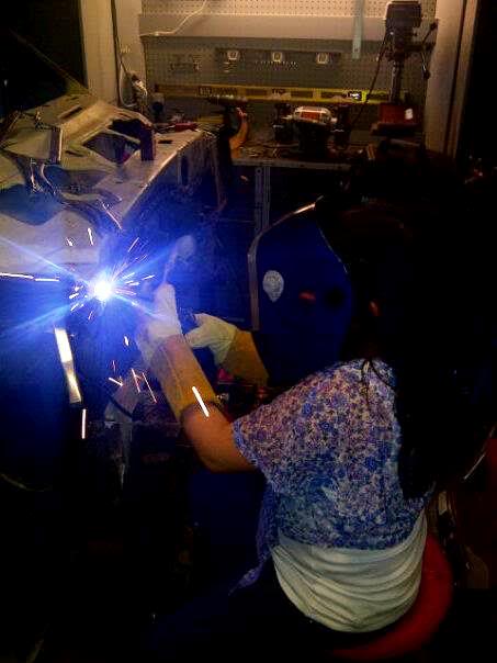

      Madie helping out on some firewall repairs

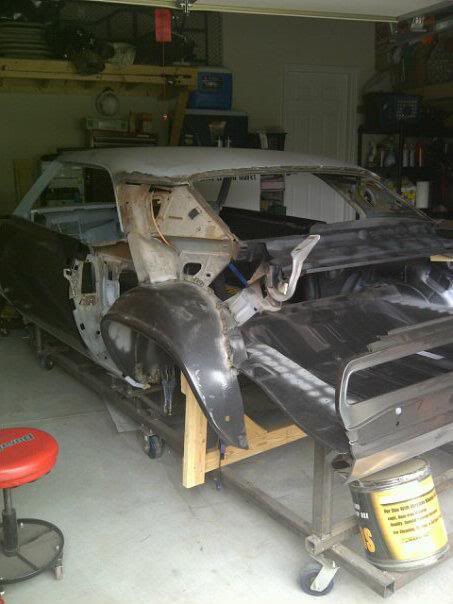

      Halfway home on panel replacements

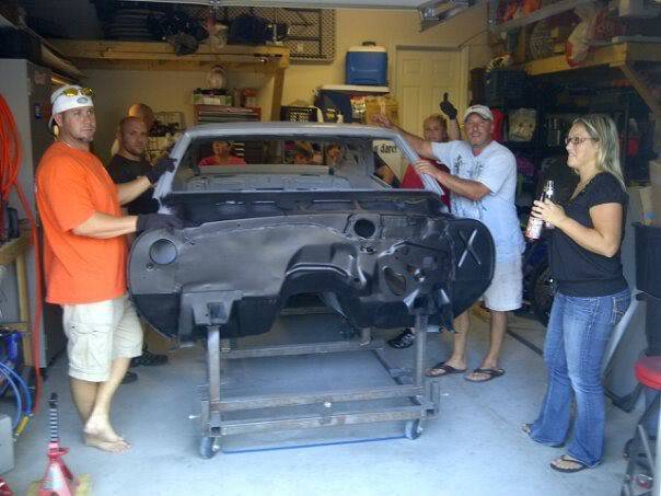

      Ready to come off the jig

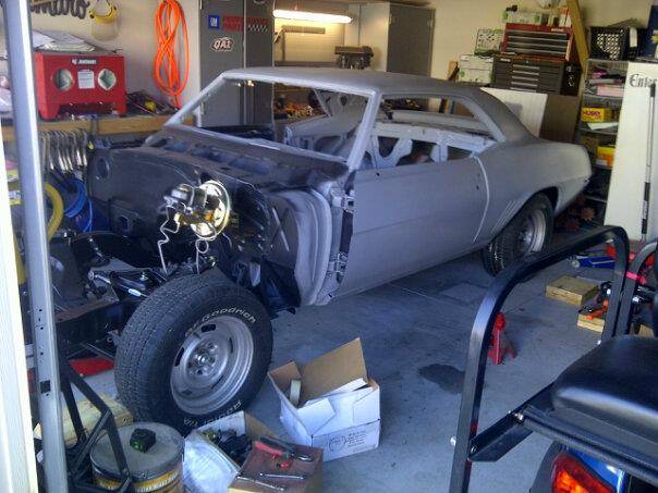

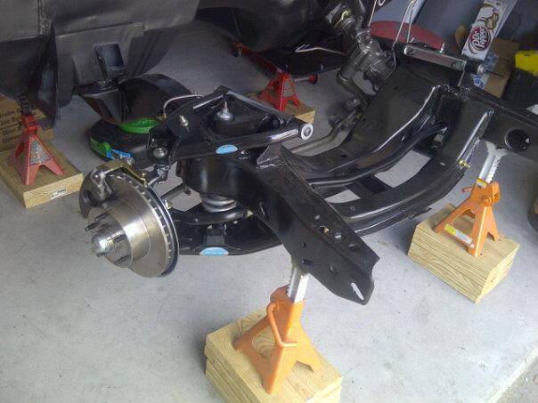

      Front suspension installed

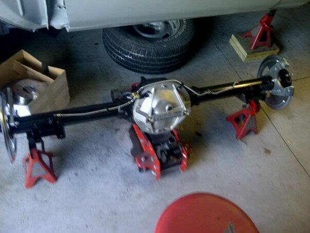

      Rear ready to go in

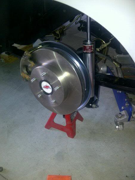

      Rear discs/shocks installed
      Sitting on all four tires for the first time since she's been home
