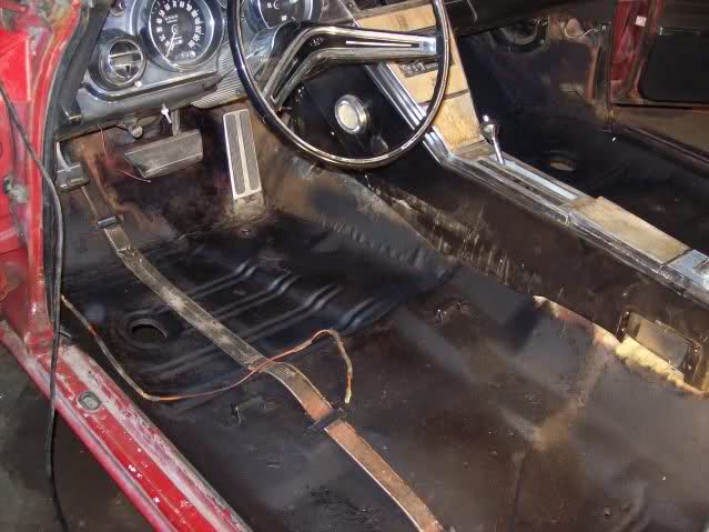

      The seat box idea is a great one for the front since the floor actually kicks up for the seat mount area leaving space underneith if I don't eat that up with frame bracing. Between the two, cross bracing from the outer tubes/channels to the X and a seat box, which is more benificial? I'm also going to have to massage the area since I'm putting late model Eldorado seats in and they have different mounts. The rear seat area similarly kicks up then you have the rear axle kickup at the back with these braces to the parcel shelf. Do I need to further panel it in?

      Looking at the floor pans lastnight made me reevaluate my plan to have both a boxed rocker and the rocker bars. There is only enough realestate for 1.5-2in tubing in that area unless the inner rockers come out. Based on what you were saying Ray, it's better to stiffen the body than to stiffen the frame all others being equal. That being said, there is room to use 2in tubing to tie the fronts of the rear fender opening and the rear door post (both of which have a cross body underfloor brace) to the the frame with more body mounts. I can only really find the front doubles (4), spring cross member (6), and a pair on each side of the trunk pan (10) body mounts on the whole chassis. Seems to me like there is something to be gained by atleast tieing the rear door post to the frame if not it and the front of the rear fender opening. The front door post would be hard for ground clearance reasons as the bottom of the cross body under floor brace is basically even with the underside of the rockers already.
