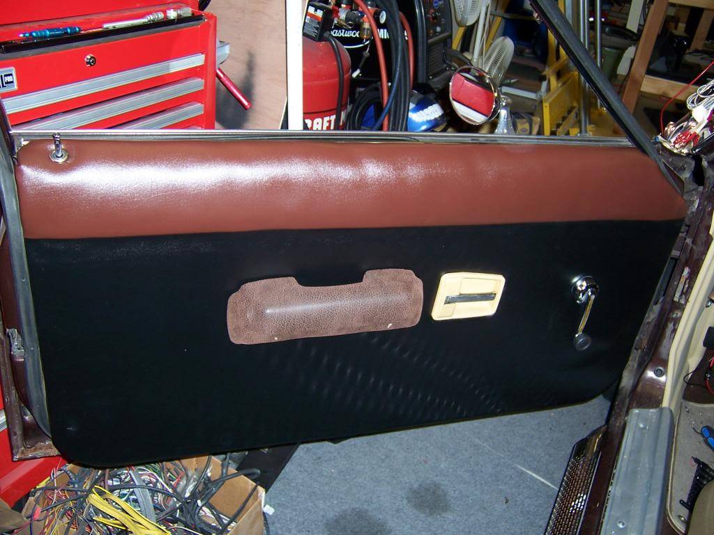

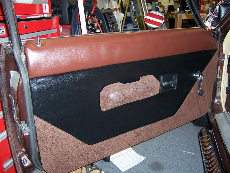

      Door card dry fitted with hardware. Still needs map pocket/speaker grille made. It will be the same brown suede stuff as the armrest.

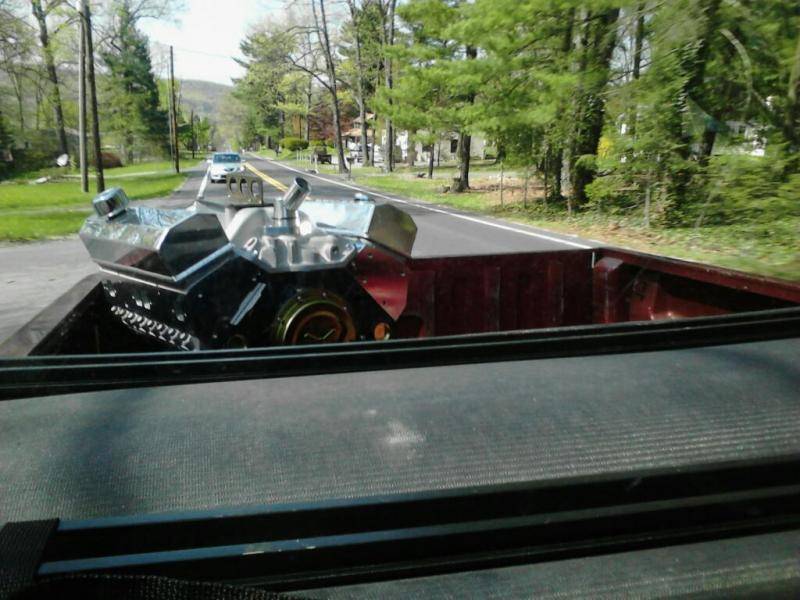

      Went up to Carlisle today and bought this:
      its a 406 450ish HP.
    3. #23

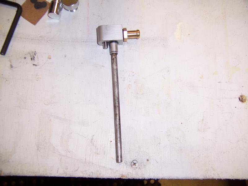

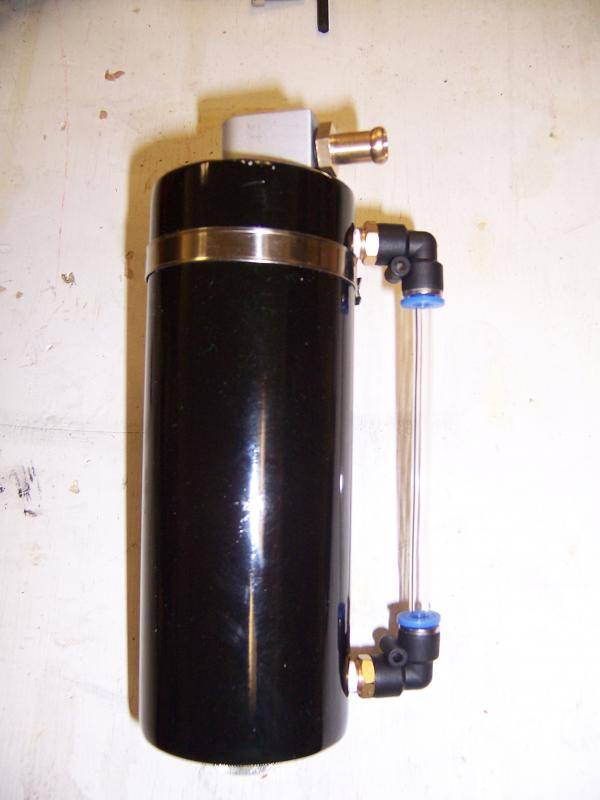

      In the mean time I decided to get an oil catch can. Spent a bunch of time researching designs and prices, ended up making my own from the cheapest ebay one available.
      Cost was a paltry $15 on sale. A catch can is incredible simple and the super cheap ebay ones are about 90% ready to actually do something. They dont come with any baffles or filtering media. Its just a can with 2 nipples and a drain hole.
      The first thing I did was remove the nipples then drilled out holes to allow the insertion of a tube so you can have the flow go to the bottom before going back up through a filter. The tube I used was an old Holley part that connects the front and rear bowls on a 4150 style carb. It was cut to about an inch above the very bottom and red lock tighted in.

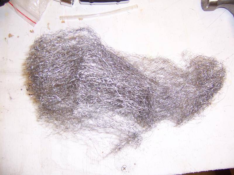

      For the filtering I used stainless steel scrub pads stretched out. There were 2 layers of course stuffed in the drain hole first followed by a layer of medium. Total cost was less than $20 and I don't see why it wont work as well as some that cost 5 times as much. Mounted it below the PCV valve location and every thing that builds up in the tube runs down to the can.

      Also managed to finish the door card.

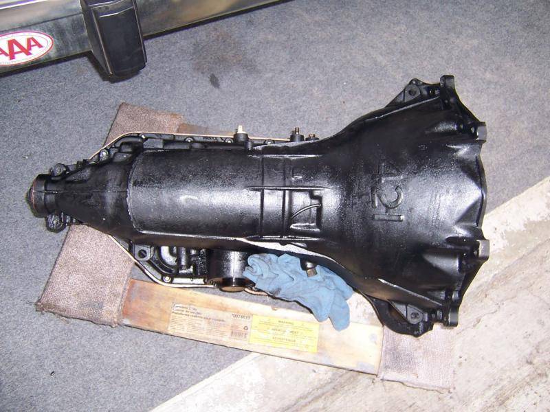

      2004r trans from CK performance came in. Should start going in Friday.

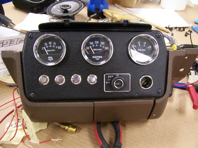

      Latest iteration of the gauge cluster with heat controls.

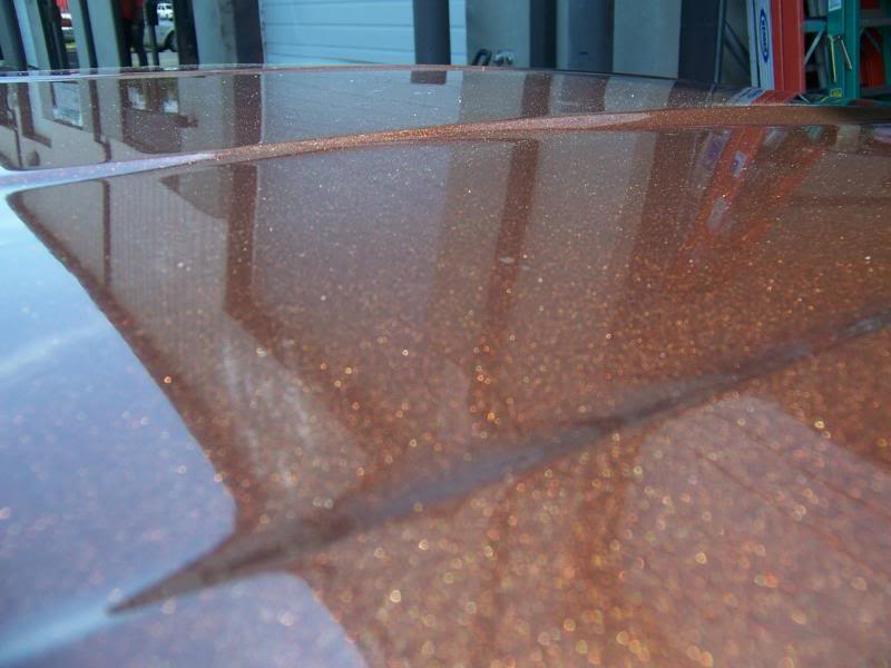

      The paint still looks good after 32 years when you clean and polish. There is something to be said about old thick automotive paints.
