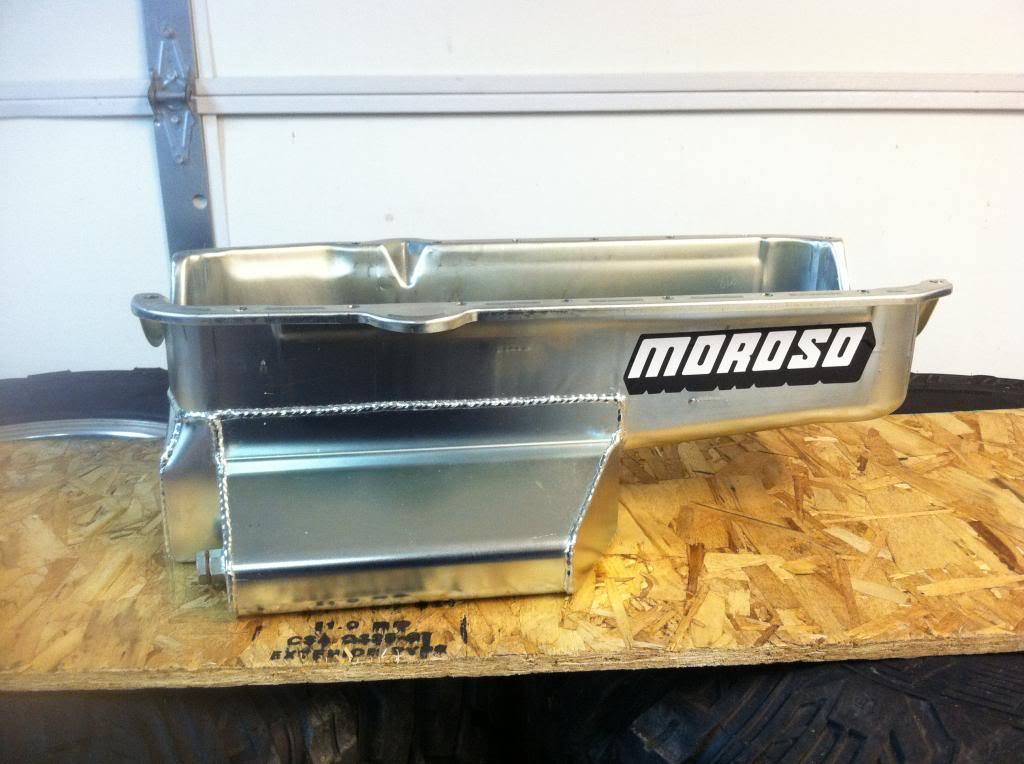

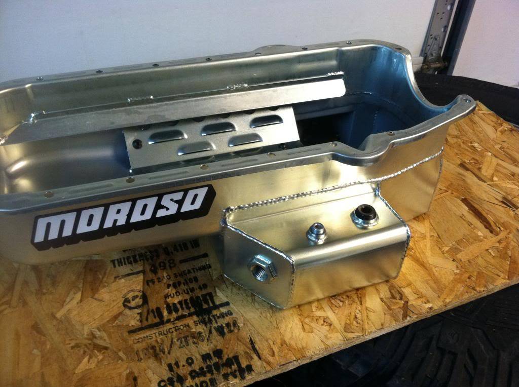

      i was in the same boat as you with needing a better pan, i ended up getting the moroso road race pan for my s10, i will have to trim a bit out of my cross member but im sure for a camaro they will have the correct fit pans, i picked this pan because it has the extra hook ups for any extras i may need down the road like an accusump and has the baffled doors, i will wait to see what happens when i do some autocross with it this upcoming summer if i will need the accusump set up
