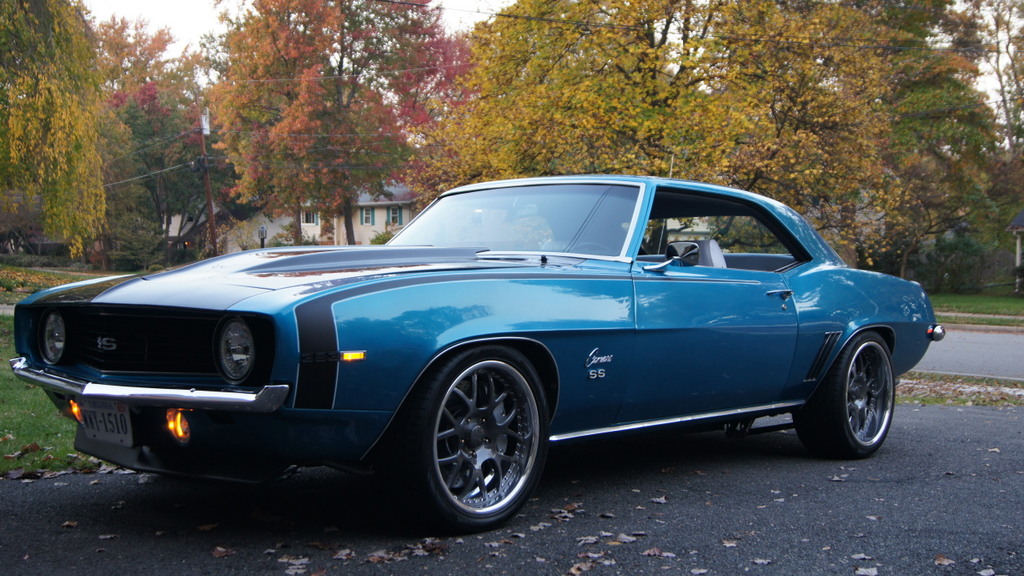

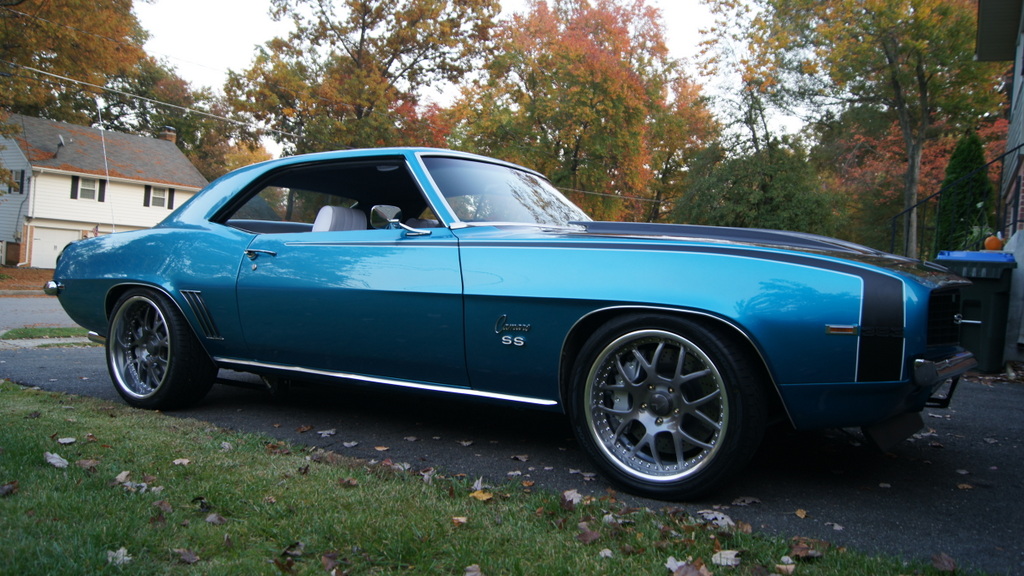

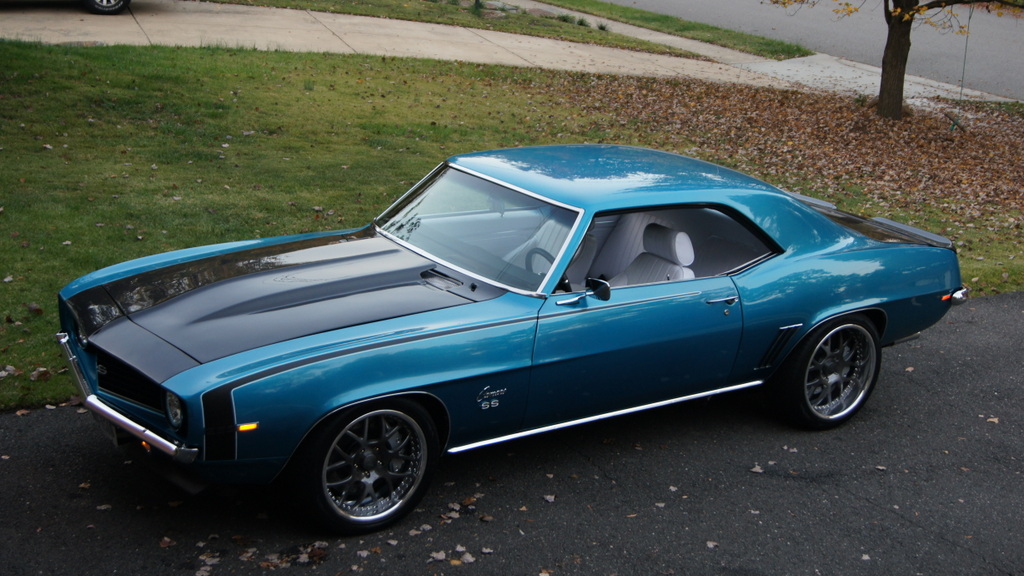

      The wheel specs are:
      Front - 18x8 w/ 4 7/8" BS
      Rear - 19x10 w/ 5" BS
      Here are several shots of them installed on my almost completed project. The brakes peeking out from behind the wheels are Tobin's (Kore3) C6 Z06 brake kits with the Grand Sport Caliper options (natural finished vs. Red calipers). Another great person to deal with!

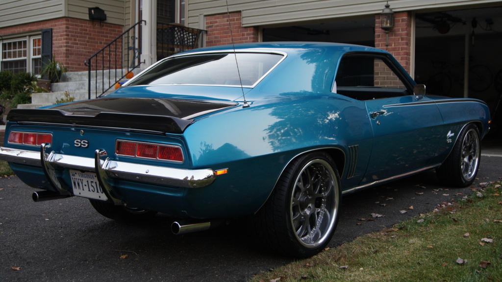

      beautiful car ... just ditch the chrome tips

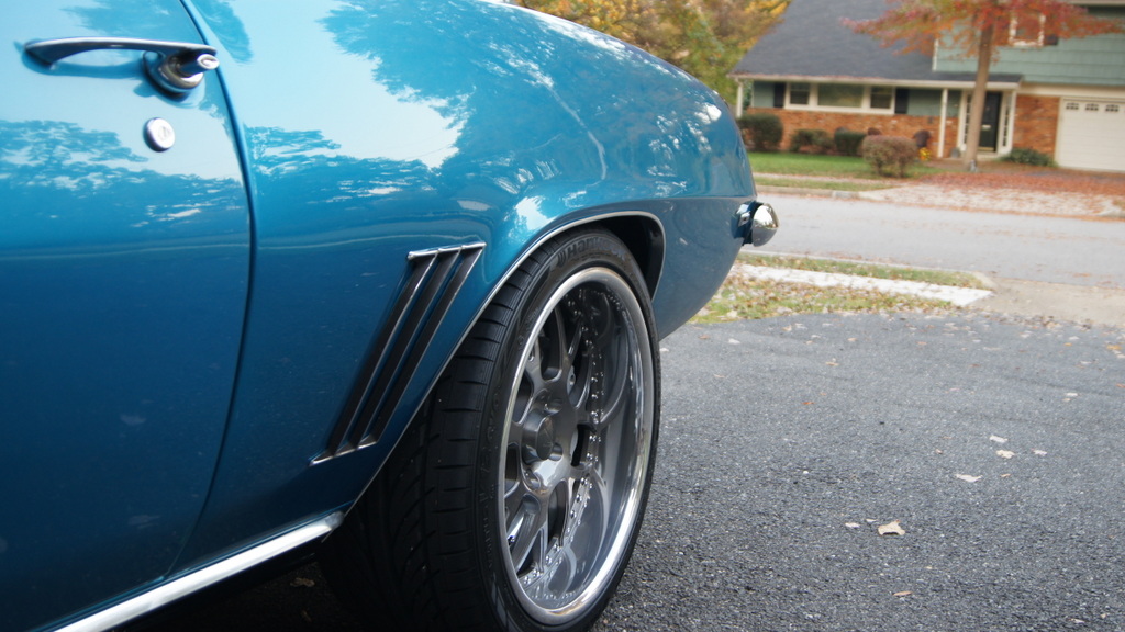

      nice rims and car! Tell me, what size are your tires? And did you measure the lip on your rear rim?

      Tires are:
      245/40 18
      275/35 19
      Could have possibly gotten away with 285s in the rear (not mini tubbed), but didn't want to chance any clearance issues.
      The lip is just shy of 3.5". Pretty deep IMO given that the required pad spacing to clear the 4 piston C6 Z06 calipers are 1.44". I suspect that the lip could be 4" plus on a brake setup with less overhang.

      I'd trim that pipe right above the 90 degree bend past the tip, put a dump it at and angle out the side, you put a another style tip on it too. The trick is to have minimal exposed... although that car is so nice you could have the old Pantera exhaust that comes out about 3 feet at 45 degrees up in the air for all I care! ;-)
      Chadman27,
      Thank you for the compliment and suggestion. I agree. Minimal would look better.

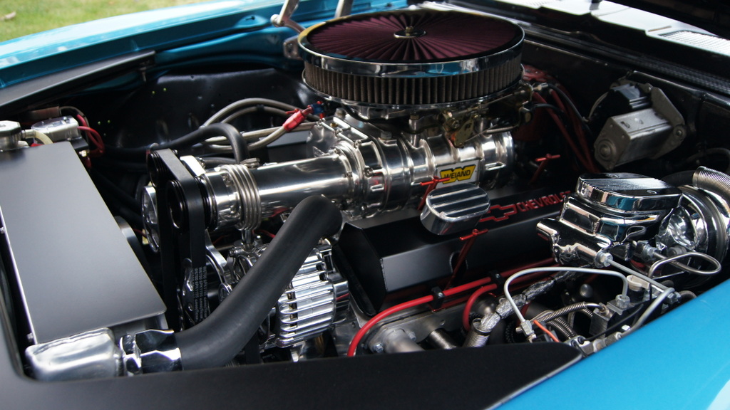

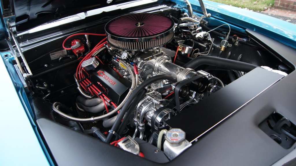

      I had some folks PM me asking about the powerplant, interior and body panels.
      The engine is a 383 with a host of goodies. Mainly Dart Pro 1 heads, Comp cam bits, Billet specialties Tru Trac, (which took some machining/engineering for it to work with the blower), 142 supercharger w/ Powerjection III fuel injection. The list goes on.....
      Being up here in VA, we are due to get quite a bit of rain and wind next week caused by Hurricane Sandy. Won't be driving her much so I'm using it as a good excuse to install the Hydratech hydroboost setup that has been sitting on my shelf for the last several months. This will clean up the brake lines a bit.

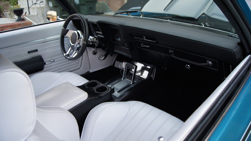

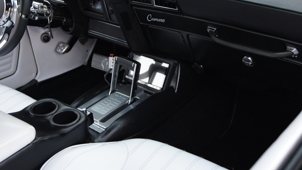

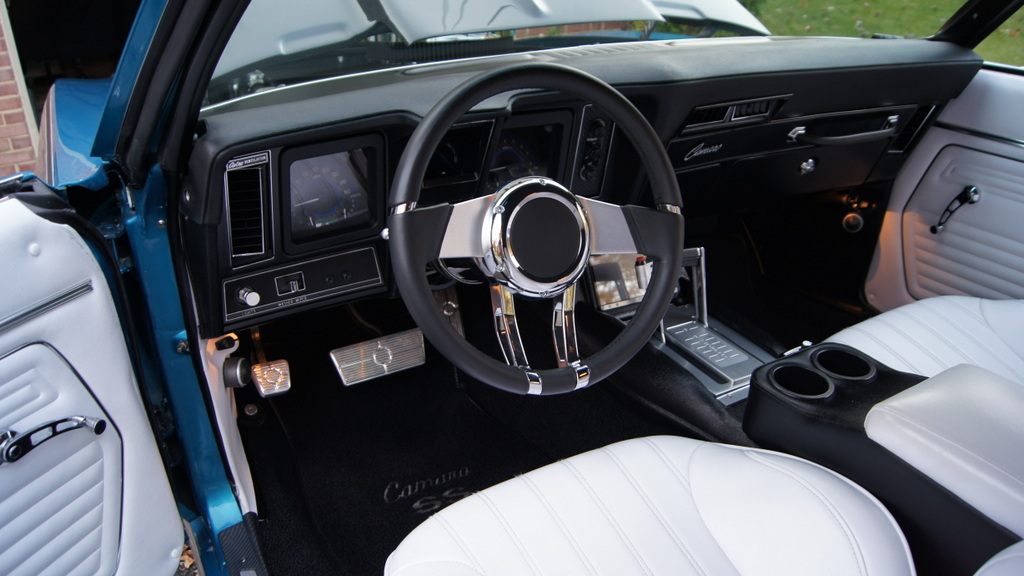

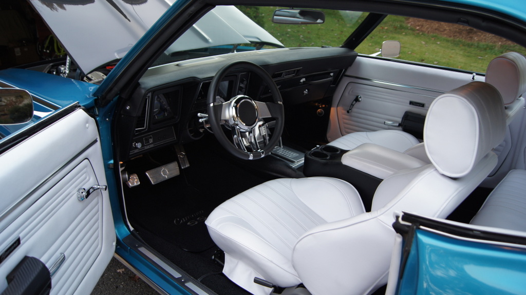

      Here are some shots of the interior. No real custom pieces (not in the budget), just a mix of parts that I thought would go well together. New interior for all intents and purposes. The whole cabin was lined with Dynamat as well. The head unit is one of Pioneer's App radio models. Really a cool head unit with a lot of features when paired with an iPhone.
