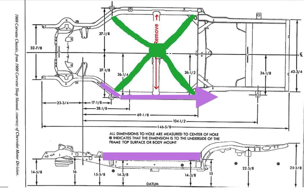

      I posted this on another forum and Im looking for some additional input...
      Gathering parts and ideas for a T56 swap this winter... I have a welded in factory crossmember now (4speed). I was thinking of ditching the whole crossmember in favor of a large tubular X-brace to stiffen up the frame a bit and also serve as the trans crossmember. I am yet to actually get under the car and look at obstructions, but I dont remember anything being too low or in the way. It also has to bolt in... I have sidepipes, so exhaust clearance is not an issue.
      Will it stiffen up the frame enough to be worth it?
      Green would be the new X brace (rough drawing)
      The car has a good amount of frame flex and Im just looking for relatively simple ways to reduce the flex without adding a full cage or alot of weight.

      Quote Originally Posted by vette427-sbc View Post
      It will help, but to really improve torsional stiffness, you need height. Best case scenario would be if you could build that X member out of 3 or 4" tall rect. tubing without cutting any notches in it. Probably not possible...Name:  xbrace plus.jpg
      Sorry for the quickie line work... Raising the sills and tying the front kickup to the rear would probably do the most good short of putting a cage in, but that's pretty major fiberglass (Vette, right?) work.

      Hey Chris,
      This seems to be a popular subject. What you've added in green will help longitudinal stiffness but will do nothing for torsional stiffness (okay "maybe" a little). The only way to get good torsional stiffness is to add a full cage with good triangulation between the outer rails and upper bars of the cage. You have to "create" an element for the outer rails to push against to reduce torsional roll. That element is the upper bars of the roll cage. There is really no other way to do it. You could possibly add firewall and rear seat bars that will tie into the A & B pillars. This would gain a little torsional stiffness but to tie the chassis into those bars and ,especially the rear suspension forward pivot points, would cause a lot of grief to your interior.
      Don't know how far you want to take it.
      Mark

      If I could rephrase the op's question....would the x frame be stronger torsionally than a simple bolt in crossmember?
      Ray, how would raising the sills (making them taller) help with torsional twist?
      Donny
      Oct 2009
      New Derry, PA
      1,265
      Donny, if we look at the frame as a whole, torsional flex is really bending one of the rails up in relation to the other. This load is balanced out at the spring pickup point at the opposite end of the rail.
      Now, I DID make an assumption that the front and center crossmembers are holding the rails stable at those points. If we ran tubes from the front spring pockets to the top of the kickups (basically the bottom half of a roll cage) we would be removing the hinge point between the front spring load and the opposing spring load in the rear. Basically, the higher sill is acting like a big "gusset" along the same lines. Not as effective, but there isn't much else you can do without going right through the center of the car. That's actually why the original 300Sl Mercedes had to have a gullwing door. The sills were raised radically to help torsional stiffness.
      And, yes the X member would be better than a bolt in straight crossmember. How much better depends on how tall the material is and how much notch has to be taken out of the center for trans clearance and a mount.

      So not just making the sills taller, but making the sills taller and tying them in front and rear to suspension pickup points. Like you said though, only as strong as as the crossmembers tying them together side to side.
      300 Merc had a pretty good tunnel through the middle, right? So maybe some strong bulkheads (firewall, behind the seat) and a spine down the middle and you would end up with a pretty strong tub.......lots of work.
      Chris, if you could make that X out of some rectangular tubing, taller, not wider, I think you could make some nice gains in rigidity. Wall thickness won't count for much, .083" would probably do it and help minimize the weight penalty, assuming you can get some height on your tubing.

      I would think that the sill height would bring advantage in a lot of designs as they're typically the longest untrussed member of a unibody chassis. No cowling or wheel tubs/b pillars to help them out. I'm assuming the vette isn't using that frame as its only stiffening member though.

      Just took a good look underneath the car...There isnt any room to build a "taller" x-member. Looks like a roll bar has far more benefit/lb in this case.
      Now after looking the car over with structural height in mind, does anyone run any kind of mid plate from the bellhousing to the frame rails? Ive got pretty much a straight shot from the back of the block to the frame rails (again, sidepipes, so no header issues)
      I already have solid motor mounts and a "spreader bar" connecting the two shock towers. Im thinking it might be overkill since there are already two "tall" crossmembers in the front of the car. Opinions? Benefit per lb is the major deciding factor here.
      That can help, but unfortunately it works best when tied into a more vertical structure. Just bolting the midplate to each rail with one or two bolts on each side won't do a whole lot to "lock" the rails together.
      Let me ask, WHY do you think the frame is flexing too much? I've been through this with a C4 Vette in the past. Just curious what the "symptoms" are...
      97
      I think I know why he asking this question. Just backing out of my driveway I use to hear a slight creek or two. I think its due to it being a T top car. I had a 4 point chromoly cage put in to try to fix this, and handle the Prochargers power without tearing up the car. The 4 point helped a ton but like any racer I think we all look for ways to improve our chassis as that is how we get power to the ground and handle better. I'd recommend the 4 point as it has minimal interior impact on these cars. I have contemplated going to the 6 point but that is where Corvettes begin to run out space for comfortable seating or gaining entry to the seat. You can get swing outs put in though to take care of this. I have seen pictures of it being done that have looked good but you need a good reputable shop. Anyways, good luck with your decision and if you go with the cage post some picks up!
      I'd personally like to hear more about the mid plate and its function. I have had people in the past recommend them to me once before. Is it more for drive line rigidity??? I also see front plates put on some older stock cars. Even with my solid motor mounts my engine still torques the procharger pulley to scrap the bottom of my hood. Thats when I went to a smaller pulley
      Even though the car has a little flex on the Corvette forums I have heard of guys running into the 9's on these stock frames. This could be myth but I have heard this on the Corvette forum so don't chew me up to badly guys. From what I have heard the frames are very strong and solid its the IRS parts that will kill ya though, although there are expensive options to make it work.
      I know I am getting long winded here but I agree with the other guys. You have to decide how far you want to go. How much fun do you really want to have? How fast do you dream your car should be?

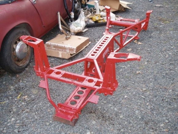

      Miles,
      It depends a lot on how you tie that spine back into the "main" chassis structure. Here's a classic example (Lotus Elan) of using the spine for the whole works.
      Tying that back into the rocker sills with some transverse boxes should make for a pretty stiff structure. Don't build it like you would a tube chassis...because in the end you'll have a tube chassis.

      I admit I kind of forgot about this thread... as to why I think I need to reduce frame flex? Pretty much the same reason I think I need a big set of Brembo brakes. Its not a race car, but I would like it to perform as close as I can to one while still remaining a street car. (that makes alot of sense )
      But like supervette said, I can feel the car flex pulling out of the driveway and after adding a few other frame stiffening pieces, I really liked the improvement in ride quality. The car is having a cage put in it now... 1.75x.095 chromo. I posted up a few progress pics in my build thread. Should be done in a few weeks.
      When the body comes off the frame I think Im going to look into some structural foam to stiffen it some more. Thats quite a ways from now though

      Quote Originally Posted by exwestracer View Post
      Miles,
      I really dont know how I would tie the spine back into the chassis, thats why im looking into this. Granted im building a s10 so my frame is a bit different but the same theory should apply. My plan was to start right behind where the frame bows out right behind the front suspension then the two sides meet up at the tranny, and then go out behind the cab and then split back apart under the bed where the frame starts to angle back up, should keep my spine level and not get to insane. My frame is 5" tall, there is 1" between the top of the frame and the cab and i wouldnt mind going up into the cab about 2 or 3 inches. So the runners that reach from the center spine are 5" tall and then the main spine could be up to 8" if i wanted and ill just make room for everything else. I dont want to put a roll cage in my truck and this is why im looking into this. My truck is 2900# and ive pulled out alot of weight so i can afford to add a few points in tubing, im not worried about that a whole lot if it will help alot, im going to be boxing the frame also. Im wanting to do something like this with my trans tunnel, just not as high since my tranny is that far into my cab. http://www.hotrodstohell.net/chevell...hell/index.htm
