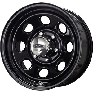

      and these are the wheels Im putting on it
      Jul 2012
      46
      Ive seen some cars look really good with those soft 8s. The gbodys are gaining ground and the ss monte is one the most poplular. If you are goin protouring, UMI, Spohn, and BMR have some nice suspension parts. Although you can also use better factory parts.

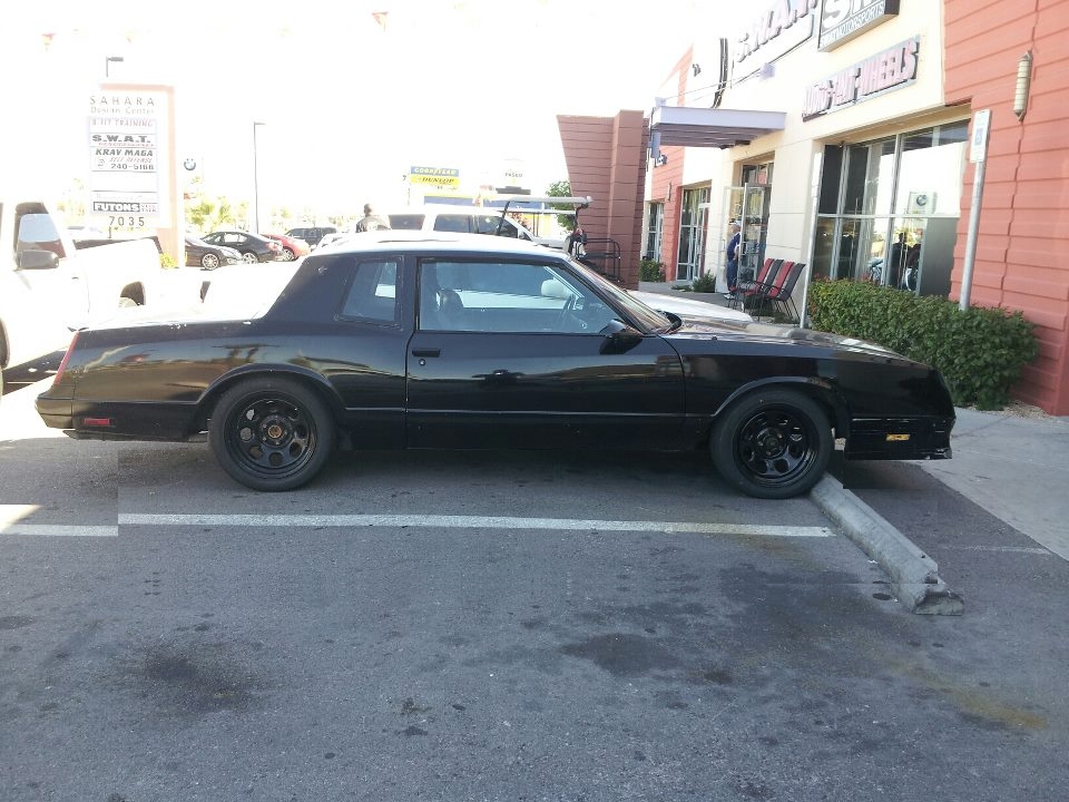

      I'll try to post updated pics tomorrow afternoon. Its been a busy few days but progressive. Got the wheels and tire mounted and new steering gear box put on. When the previous owner put the 22 inch rims on it, he had some blocks mounted in the springs to give it a little life.....this is a pain in the butt to get out so a friend of mine will hopefully be taking them out tomorrow afternoon which should lower the car an inch or two.
      I upgraded the steering gear today and i still have a little play in the steering. Could this be because of the rubber rag joint in the steering shaft? any input on this would be appreciated.
      Jul 2012
      las vegas
      30
      as it stands, maybe an inch lower now since the coil/spring spacers where removed. definitely needs about a 2-3 inch drop.

      Quote Originally Posted by creamgorilla View Post
      I think you would be pretty happy with a 2" drop. You don't realize how much 3" is until you do it and then you can run into clearance issues. The other problem is to go more than 2" in the rear you need a rear coil over kit, which are nice kits but expensive. I would run a 2" drop spring in the rear and a coil over kit in the front to bring the front down a little more than 2". Just a thought, car is looking great!
