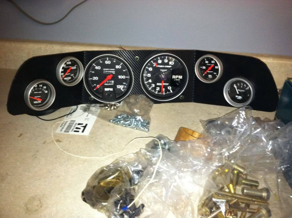

      So a bit more to add this morning. Here is a shot of the dash insert I made for my autometer gauges, it has a custom built harness that ties into the factory one where possible:

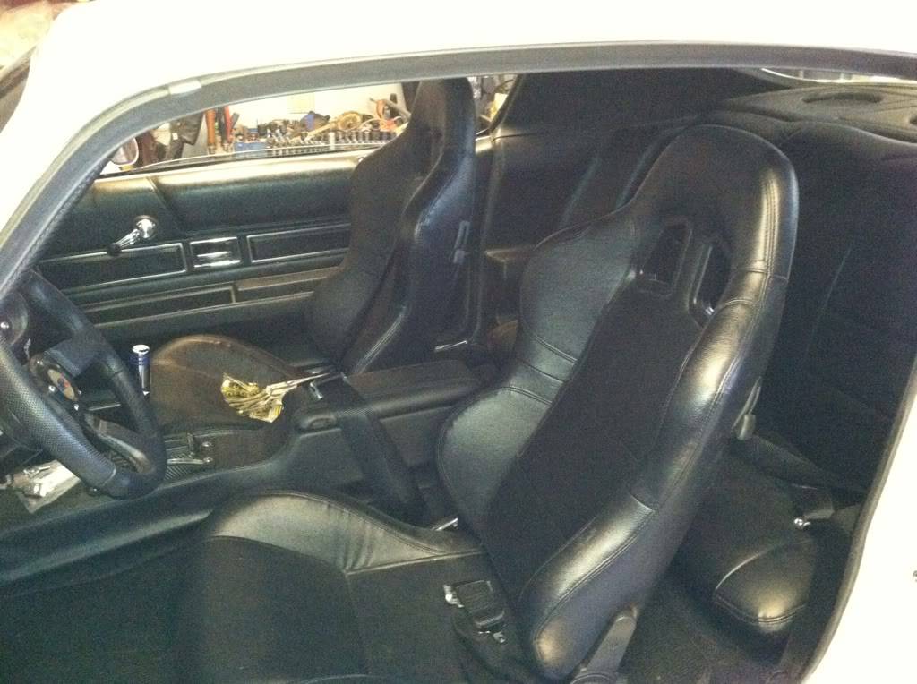

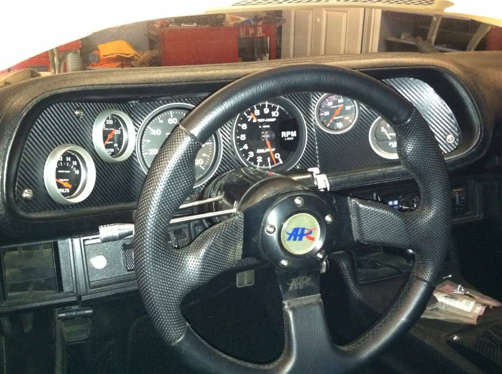

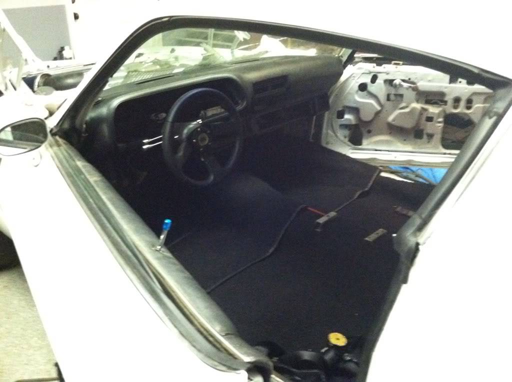

      A few more of the interior coming together:

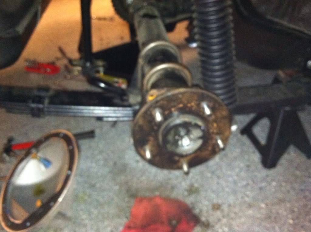

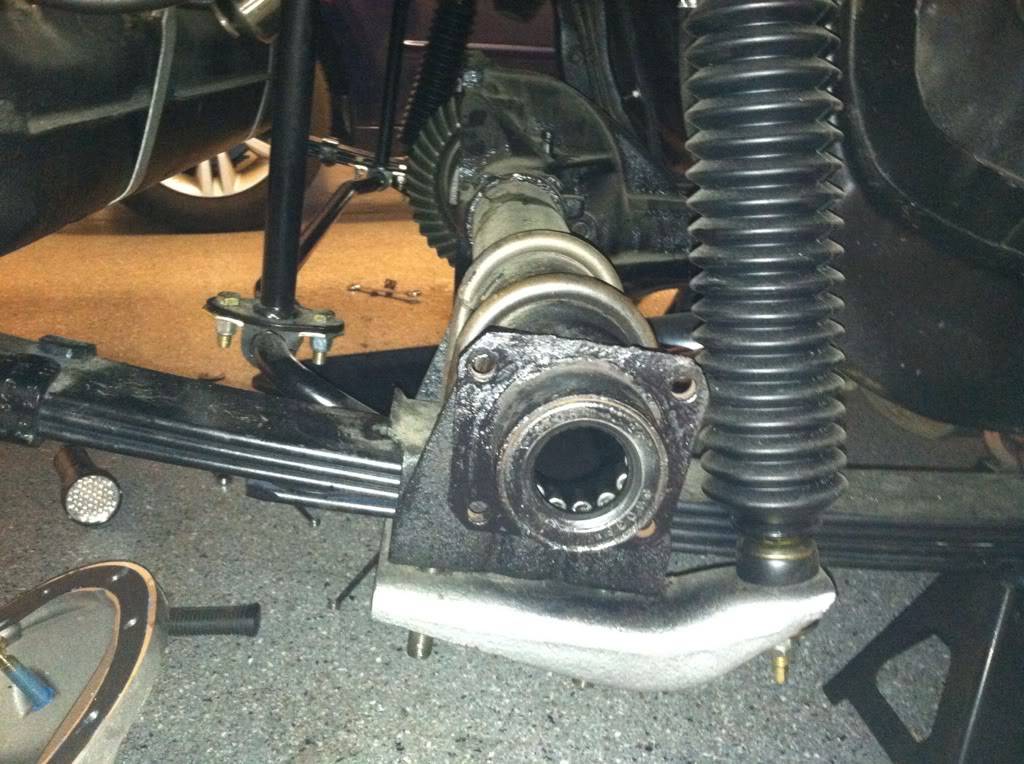

      And one of the rear suspension:
      it features PTFB GT springs, the Gulstrand front mount modification, poly bushings throughout, Edelbrock IAS shocks, and a PTFB adjustable rear sway bar. I also installed 1" lowering blocks and a Trick Flow rear end cover / girdle. The rearend is a corporate 8.5 with a 4.11 posi in it.

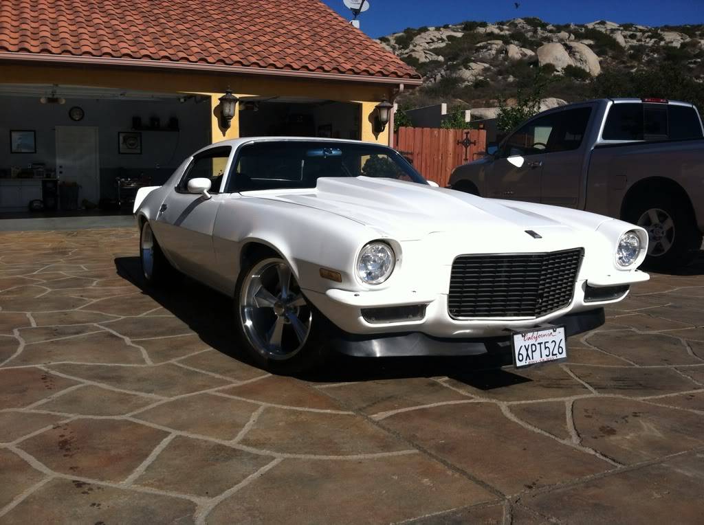

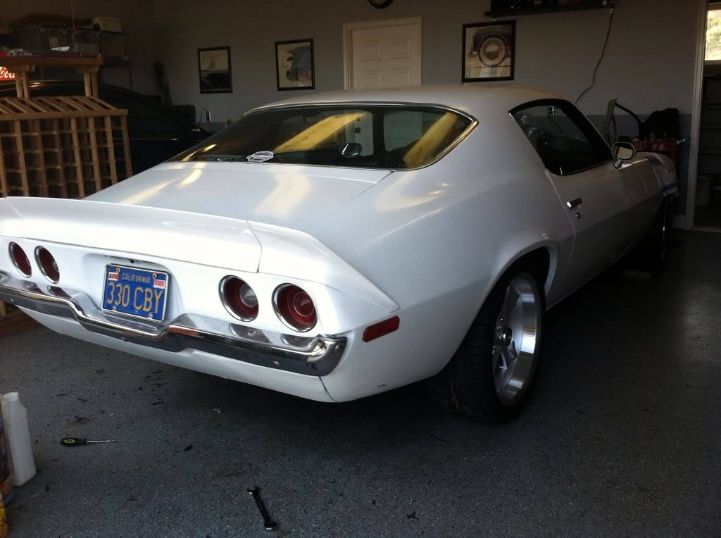

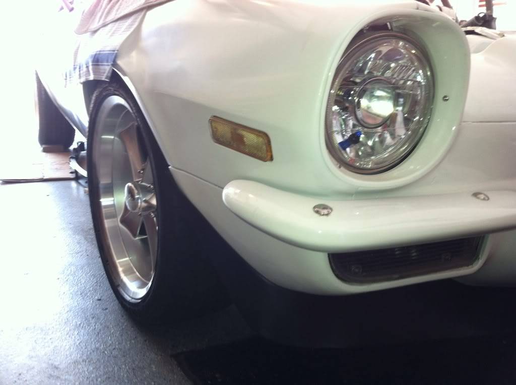

      Well with my modest suspension upgrades complete I finally got to see the new stance of the car. Initially it was a bit too low in the front, and has since been adjusted up about 1 inch. The San Diego SCCA is trying to form a Pro-touring class and has a limit of no less than 4 inches ground clearance. I talked with Mary Pozzi before embarking on this and she suggested front spring rates in the 650 lb/inch range. To give that perspective QA1 suggested 350 lb/inch for small blocks. I went with their stiffest at 600 lb/inch. when I first put her on the ground with the shocks on setting 8 of 20 the front end felt solid. I think the stance is where I want it to be:
      While I would love to have some Forgeline wheels, I just don't have the budget. I didn't want the IROC or torque thrust wheels as they were a bit too 'belly-button' looking. I found the Rocket Hyper Silver Bullet wheels at the Grand National Roadster show and they met my needs. Fronts are 18x8 with 245/40/18 tires, and rears are 18x9 with 275/35/18. I was able to get a set of take off Dunop tire that would not meet BMW certification at work. They will be on for initial testing until I can afford a set of Falkens.

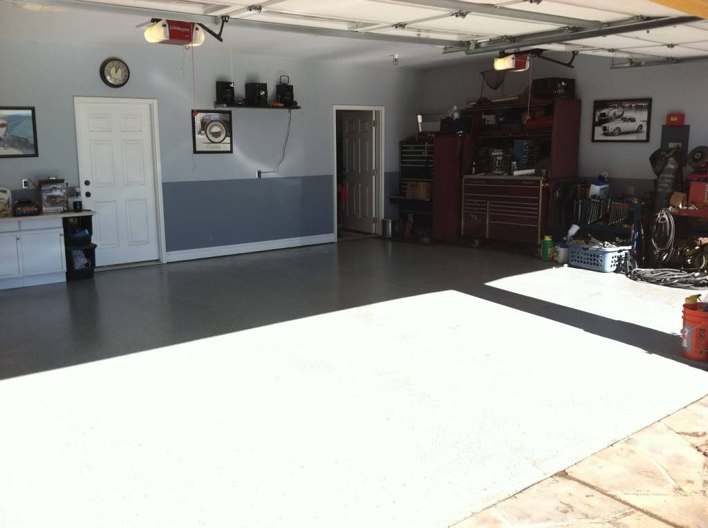

      That also gave me an opportunity to clean the garage where she had sat for the last 2 years...

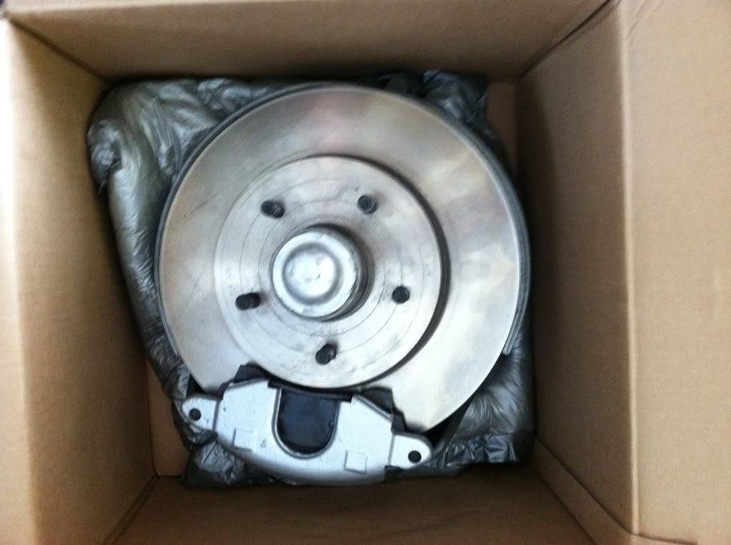

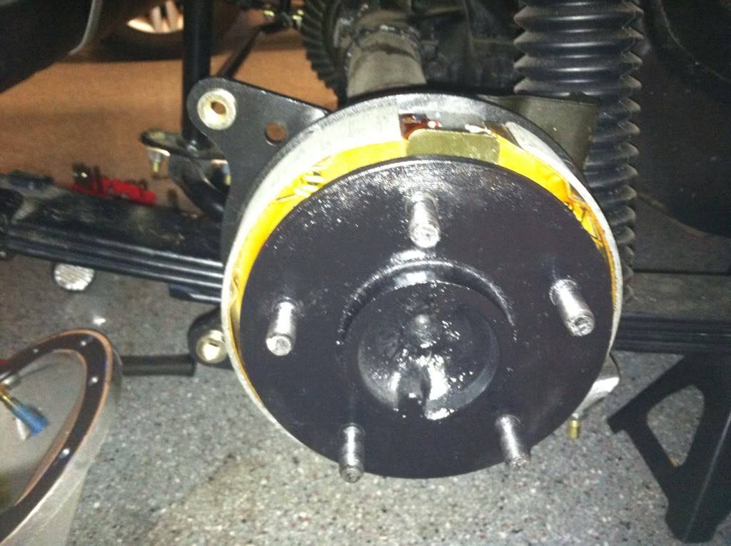

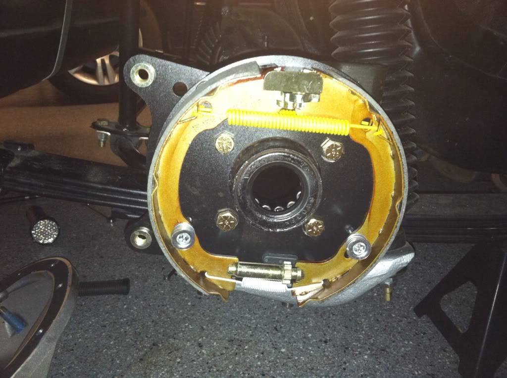

      So last week the car had 'b' body spindles with 1LE 12" rotors and GM D52 calipers
      While an upgrade, not what I needed. Now it has CPP C5 hubs, rotors, and calipers at 13" and a noticeable weight drop.

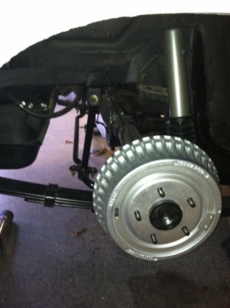

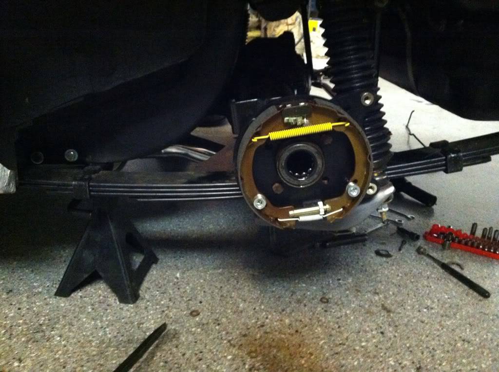

      In the rear she had stock drums, that were not moving......

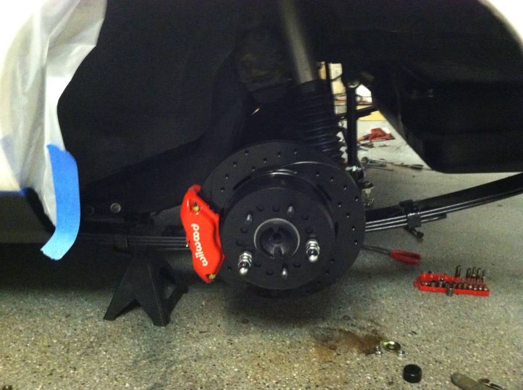

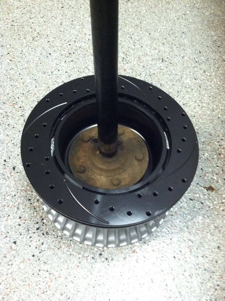

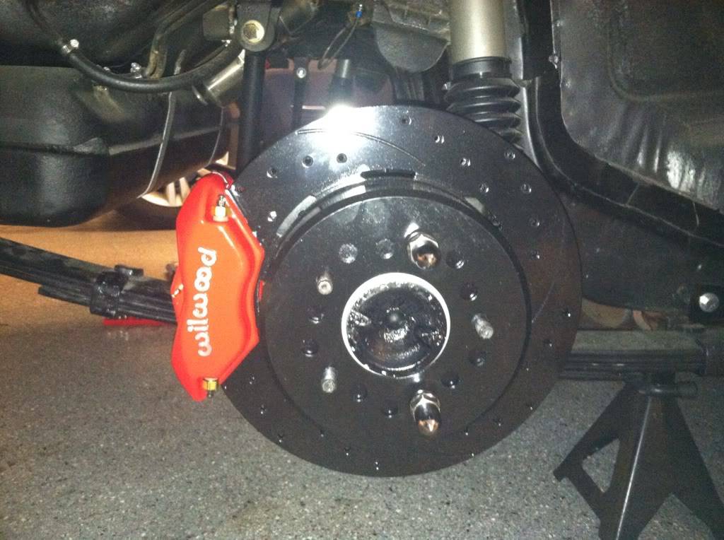

      Tonight my new Wilwood Dynalite 12" rears discs arrived. While I was tired after working all day I made a good bit of progress...
      I have a short list of parts to get tomorrow, and hopefully everything goes back together.
      While under the car I also removed the lowering blocks, so hopefully I have some ground clearance also.

      Quick update..... I have to say the Wilwood Dynalite Pro rear brake kit is very well engineered. After cleaning the rear end housing flange the backing plate / parking brake assembly bolts right up, slide the axle back in, slide in the rotor, mount the caliper with the supplied bolts and slip in the pads. Passenger side done!
      Unfortunately the drivers side did not go so smoothly. The caliper is offset .170 to the inside. After 3 phone calls to Wilwood, and with the help of James in their tech department ! have $80 in parts on the way, and will not be autocrossing this weekend. I guess it is time to put up Christmas stuff!

      Great looking 2nd gen! What are the specs on the wheels and tires? They really finish the look.
    17. #37
      Jan 2012
      Dallas, Texas
      144
      The wheels are Rocket Booster Hyper silver, front are 18x8, rear 18x9.5. I am currently running 245/40/18 Dunlop runflats on the front and 275/35/18 on the rear. As the car gets sorted I want to get the Falken 615rt tires.

      The parts from Wilwood arrived last night and allowed the left rear brakes to be installed with the correct offset. Special thanks to James at Wilwood technical for figuring out what to send to make everything fit. Looks like I may be driving this weekend.
