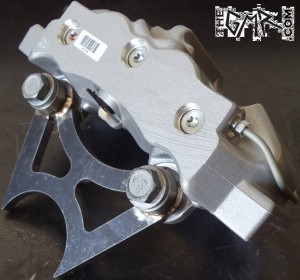

      The GMR has your rear-end problem solved, http://thegmr.com/?page_id=343.

      Wow, thanks wellis. I should have come here a long time ago. This looks like a nice piece. Do you know of anuone that is using them?
      Jul 2009
      Grand Rapids, MI
      1,559
      Not yet, I will be on my next project but you would have to check with Jason at the GMR.
