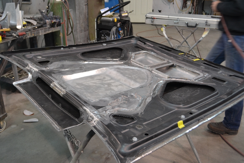

      Working on new front bumper brackets since the headlights were modified. The front bumper itself has been heavily modified to give it a “sharper” look. Lot of other fab work going on to make the front end look cleaner.

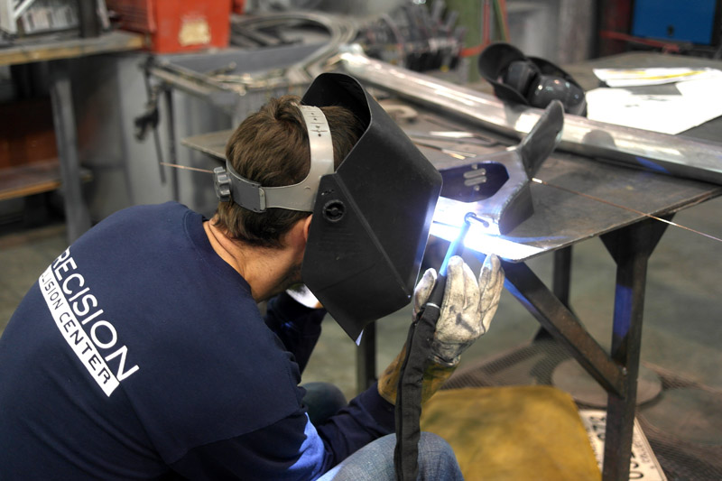

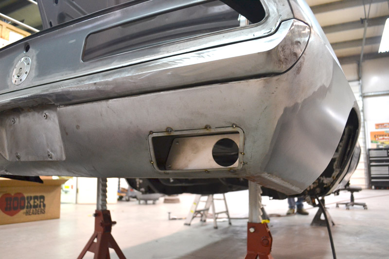

      Custom exhaust port work

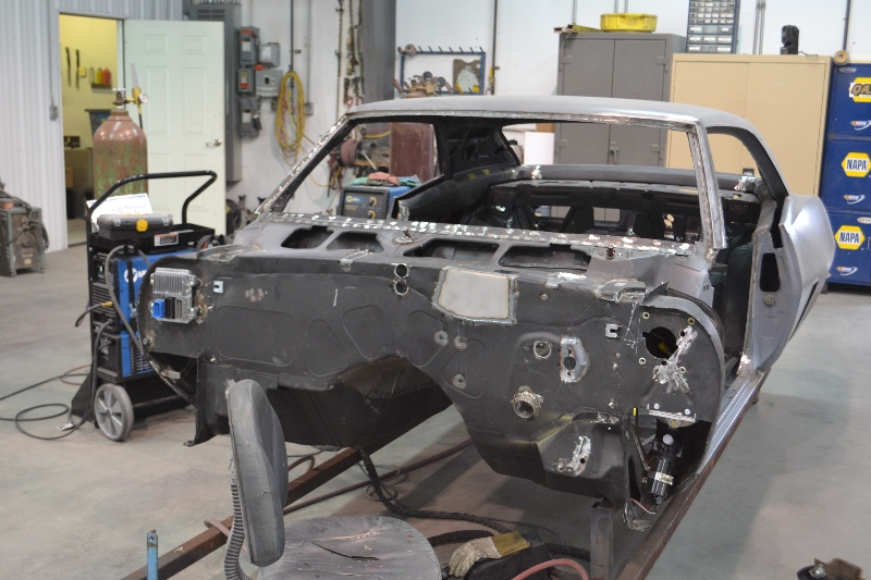

      Work done on the tranny tunnel

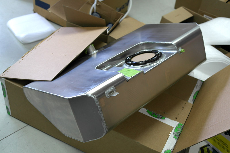

      Can't go wrong with a Rick's stainless tank

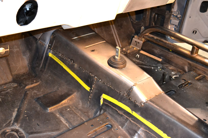

      Tranny tunnel welded up some more

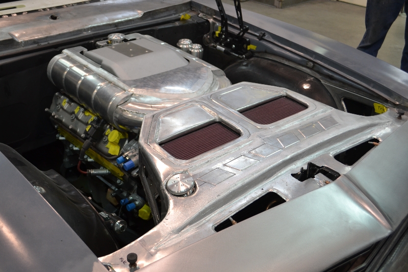

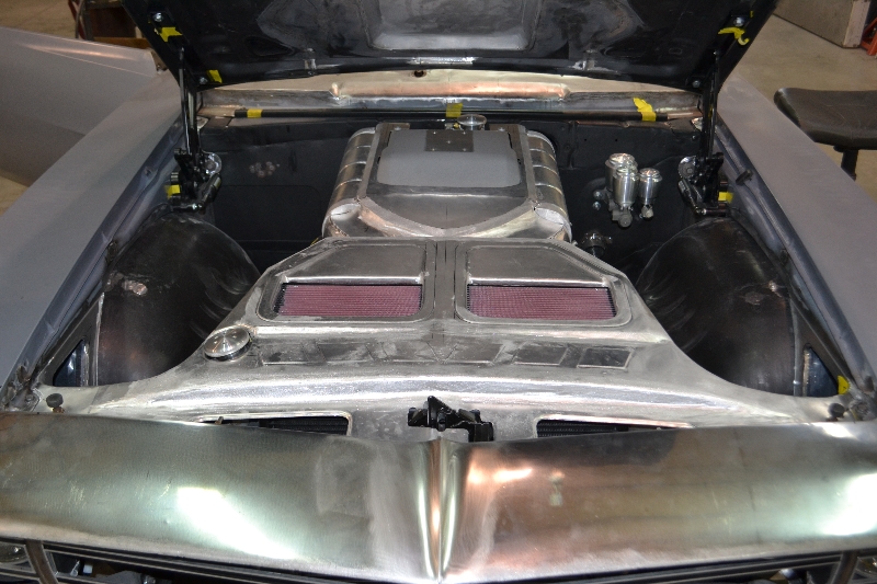

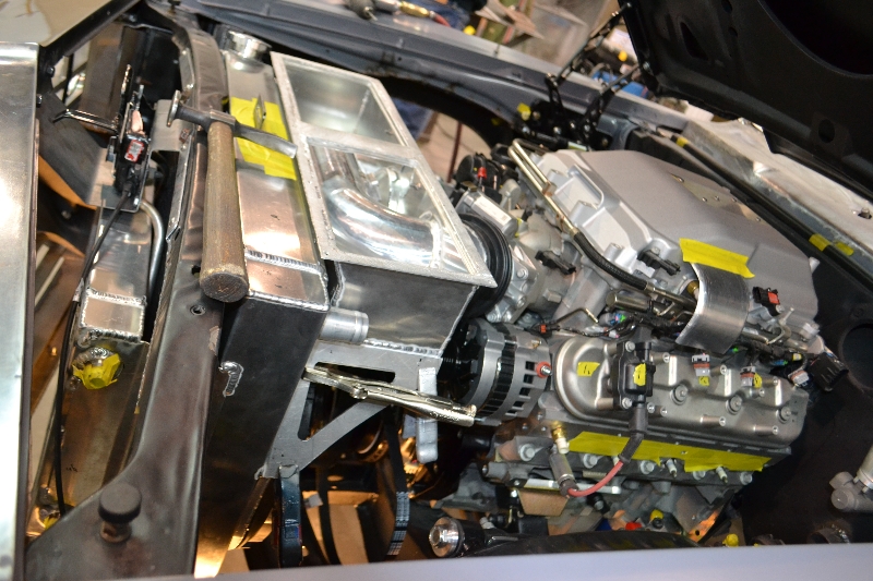

      engine looks higher and closer to the firewall than i would have expected. is that the unmodified location? Gonna be any issues with anything? SC rear exit cooling lines maybe?
      There were a few reasons for moving it back so far, mostly weight distribution and to get a cleaner look. If anything it actually helped with clearance issues.

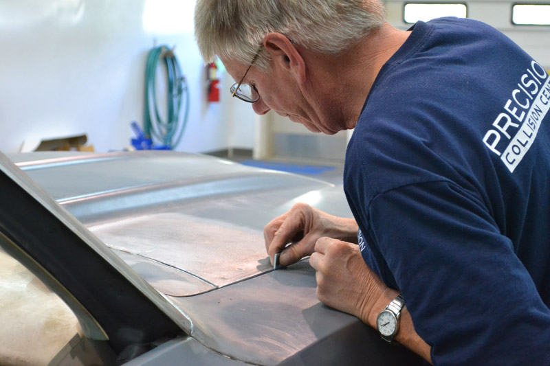

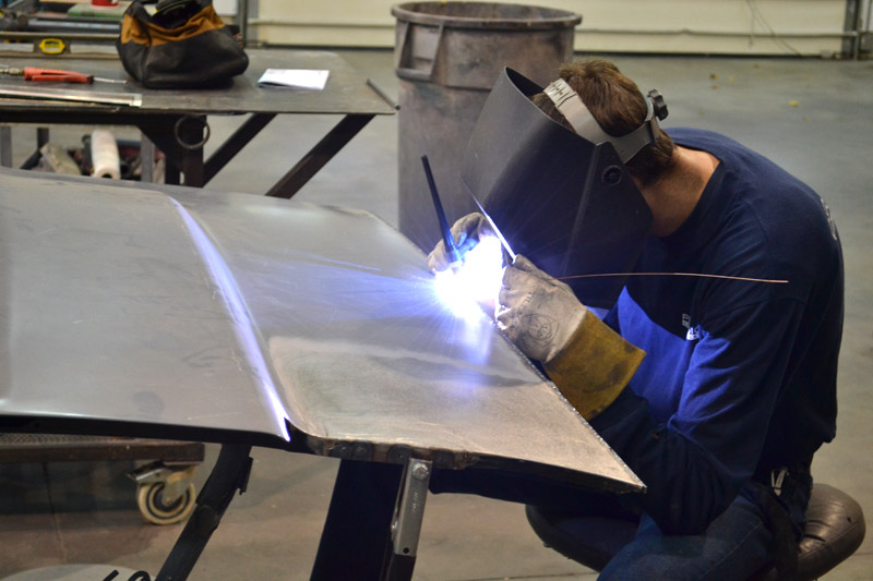

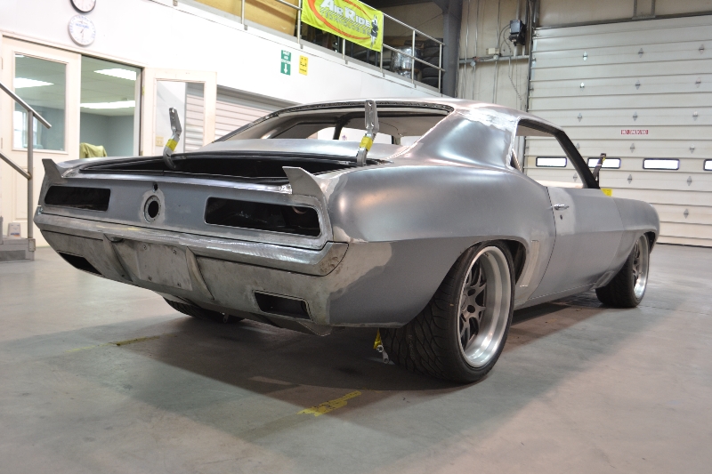

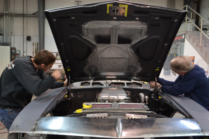

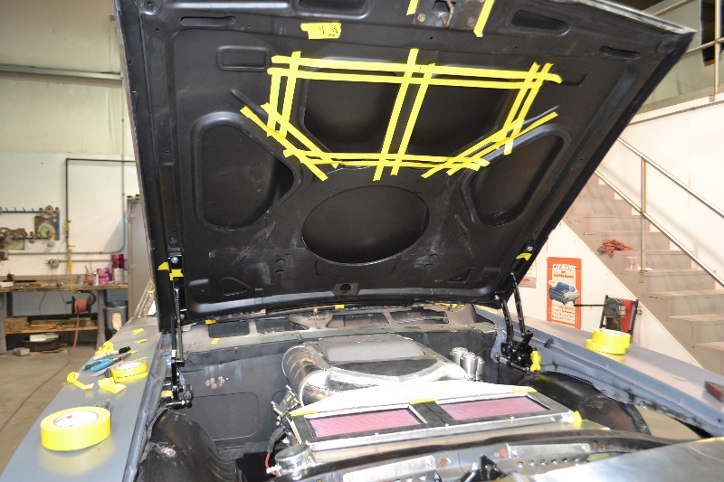

      New updates on the build page today. The guys have been hard at getting the metal work finished in the engine compartment. If all goes well we should be seeing some primer very soon. Here is a few teaser pics. For the goods check out http://www.ridetech.com/69camaro/

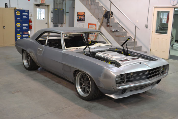

      Final fit is complete now its time to blow it apart for a good coat of Sikkens primer.
