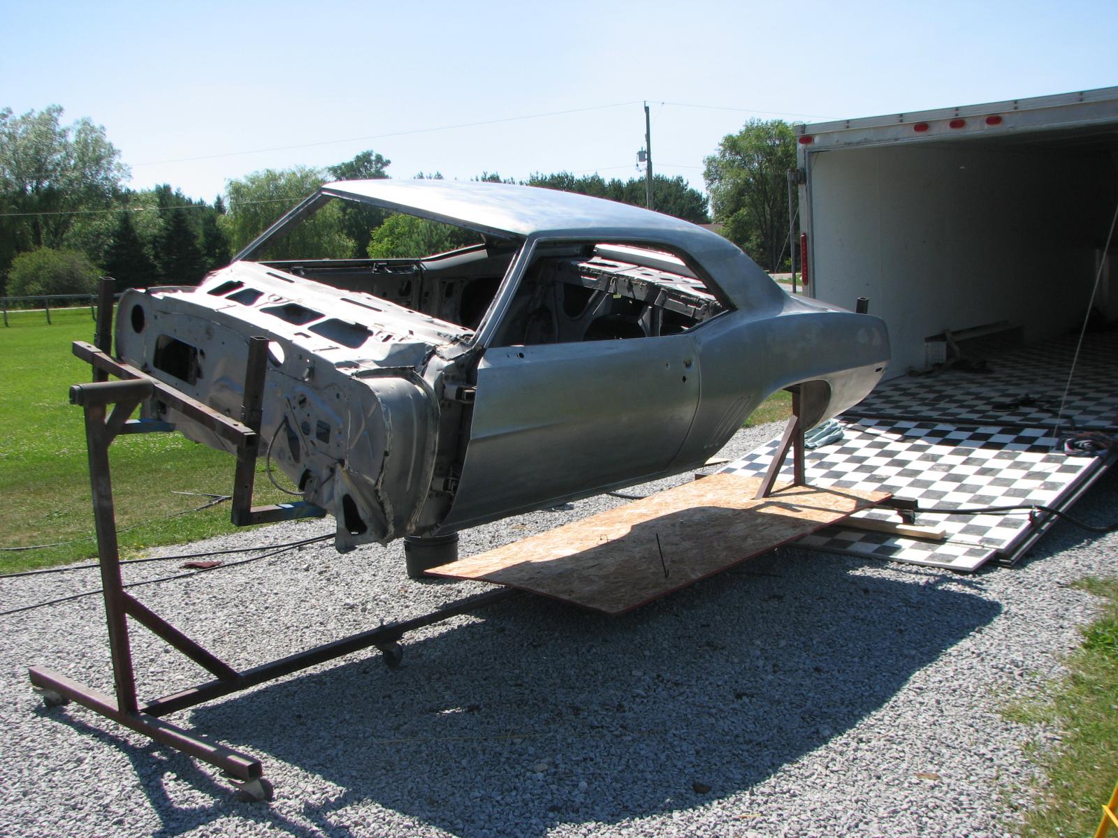

      I removed everything then mounted it on the rotisserie and prepped for Soda Blasting.
      Name:  Copy (2) of IMG_2796.jpg

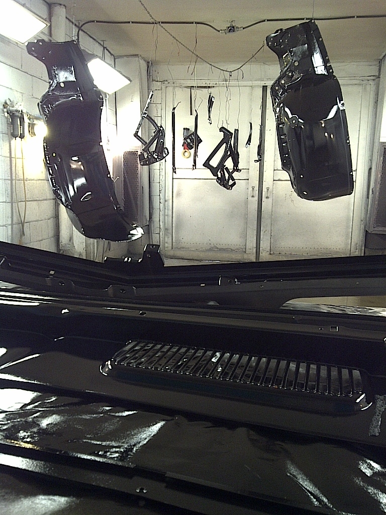

      Car stripped then cleaned. Then taken into the paint booth with acid etching high build epoxy primer.Name:  IMG_3355.jpg
Size:  249.9 KBName:  IMG_3378.jpg
Size:  306.3 KBName:  Copy (2) of IMG-20120713-02055 (2).JPG
