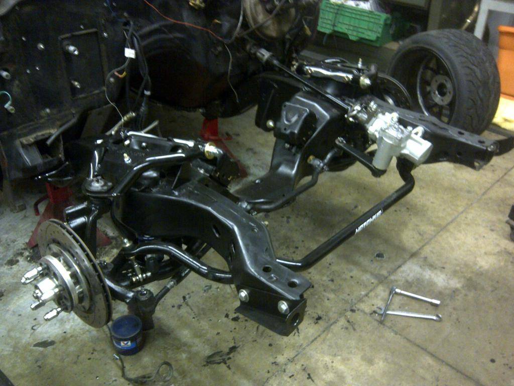

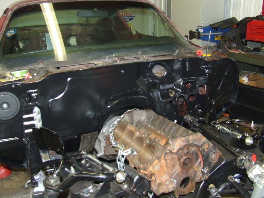

      Subframe painted with ridetech Coil overs and minitub complete. Time to work on that nasty firewall.

      Nice job so far!!!.... how was it with the mini tubs?... and what did you use to paint your sub-frame?

      mini tub wasn't too bad to do. I think I have about 20 hours installing them. I painted the subframe with por satin

      that's not bad at all... what type of clearance for tires could you get back there.... where r u at in indiana... i have family in Hagerstown

      I'm going to run 335/30/18 in the rear

      Speedtech Torque arm ordered with ridetech coilovers...

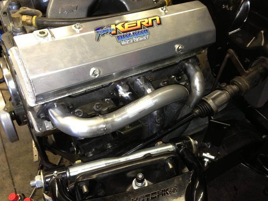

      Drivers side header modified to fit 18 degree exhaust ports. Still need to be tig welded.
