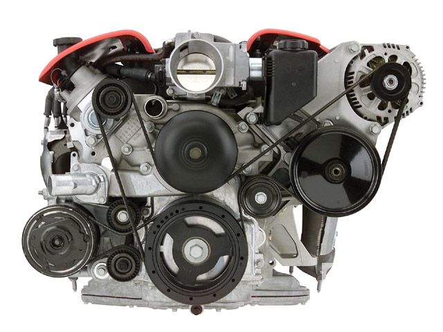

      I wonder what the belt loading and tracking will be like. The factory arrangement uses a separate belt for the A/C. The W/P wrap % is a bit concerning as well if the above is correct.
      Eastern Virginia
      3,965
      Quote Originally Posted by CarlC View Post
      There is very little difference in the belt pully coverage on the Holley setup compared to the stock GM setup from the factory. From the factory there is a tension pulley at the location in front of passenger side head.
      Stock GM Corvette setup"
